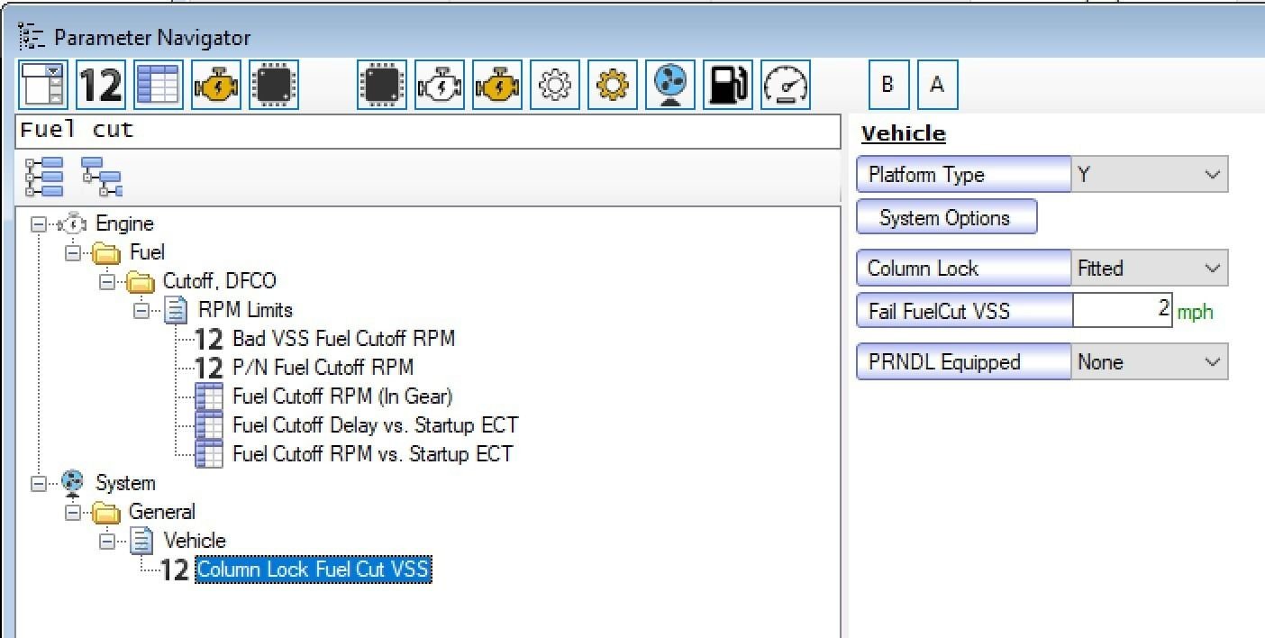

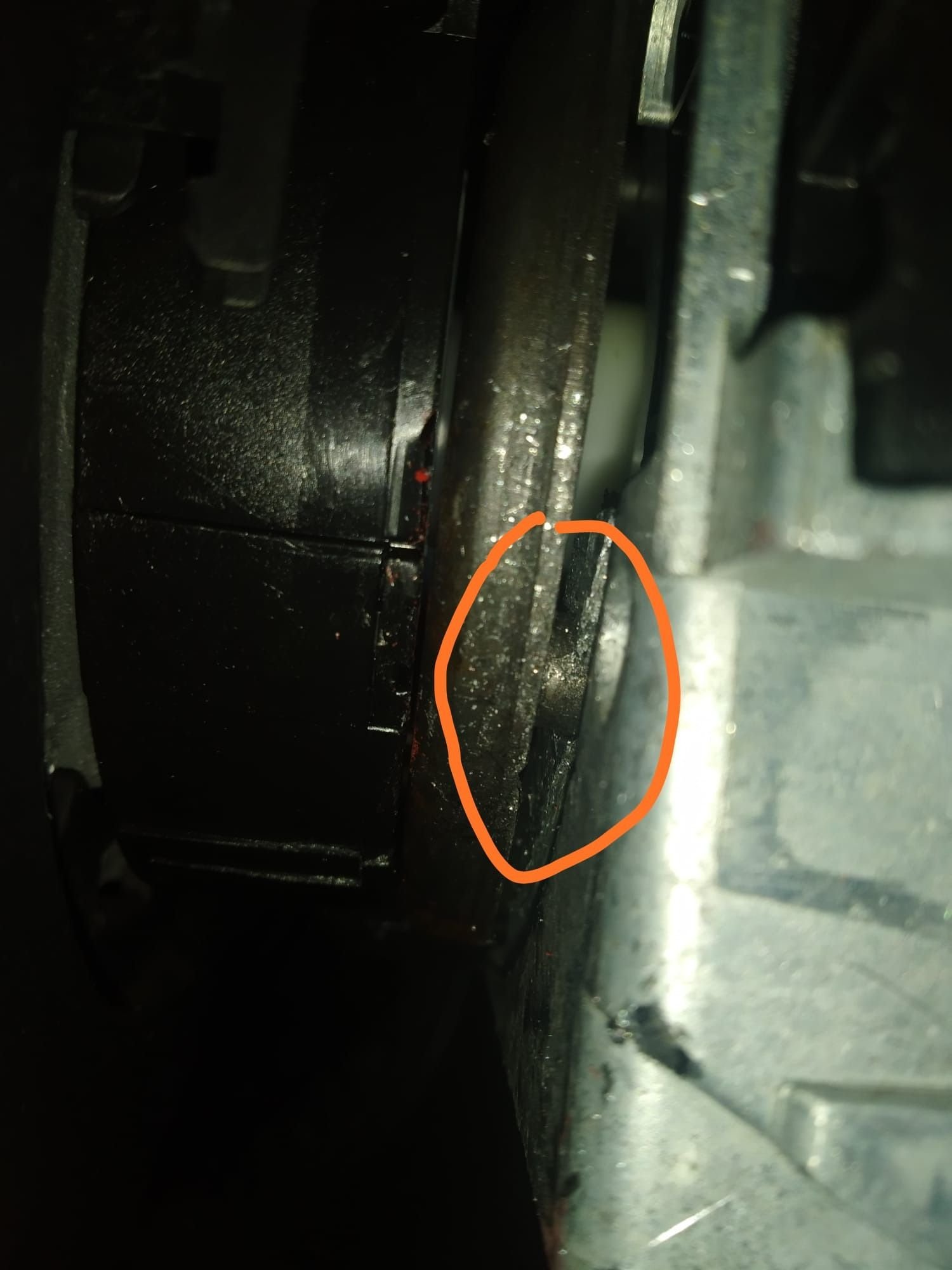

So I finally had the dreaded Steering Column Lock service happen three times in one week in my 2002 C5 Z06. I am somewhat isolated since I live in Central Europe, so I pulled fuses 23 25 and 29, and it worked the first two times, but stayed locked after the third time, and I had to tow my car home. I uncovered the steering column and found the steel pin holding the column, and hit it with a chisel, and it popped back down. In the end, I got a dremel and sawed it off. I now want to reprogram the PCM so that the fuel cutoff doesnt happen at 2mph...I have two laptops here with USB ,etc..IE somewhat modern. So my question is , what do I need to change this parameter? I am not interested in tuning my C5, I just want to change this parameter ...so can anyone either post or link me to a post on our forum on how to do this? Any help is appreciated. And yes the CLM bypass kit is ordered and on the way, but it takes forever out here, and I want to be safe.
the infamous column lock pin

Change from 2mph to 200 mph is one way. The exact steps required vary based on the software you're using.
Looks like the mph in your screenshot is editable, if you change it can you write the new value to the car's software?
If the screenshot is a different cuttoff situation what happens if you right-click on "Column Lock Fuel Cut VSS"?

Thanks, but not my screenshot I downloaded it from another post, but I couldnt get an answer (it was a 15 year old post) on what software, what cable, etc to use, and still looking.

Just to update everyone a year later....mostly because I am in Central Europe and don't have many resources....my 2002 Z06 had the CLB installed in 2005, and it was fine for 19 years, but as I stated, it now happens often..so I got a dremel and sawed the locking pin clearly off. I then took the car to a tuning shop and had the fuel cutoff set to 200 MPH...no problems every since. I did make a small mistake and not catch the pin when it was cut off, and it fell somewhere into the column, and it now makes contact intermittently which activates the horn! so I pulled the fuse for the horn and drive the car in this condition..Ill use a magnetic wand and find the metal tab later this summer.
