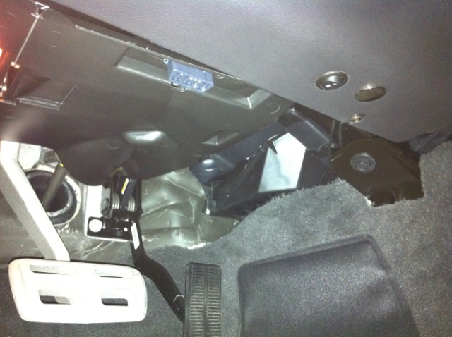

While I can't imagine having the NPP open ever attracting attention of law enforcement (unless you're intentionally trying to be a jerk), I do like having a switch, that way...it can go off for phone calls and when the wife wants to drive.
My under $10 NPP solution:
What I did was buy a switch like this ($1.98):
Wired it with an "add-a-fuse" circuit from the local auto parts store (6 bucks). And mounted it someplace easily accessible, impossible to switch accidentally, and stealthy (i.e. you can't see this switch unless you crawl on the floor to look under the dash and physically impossible for me to accidentally switch it with my knee):
No complexity, no battery drain, and can be removed in a few minutes if necessary for some reason.
Just a thought for you. And since I tweaked my back bending down there to take the darn photo, I'm going to share it everywhere I can!
