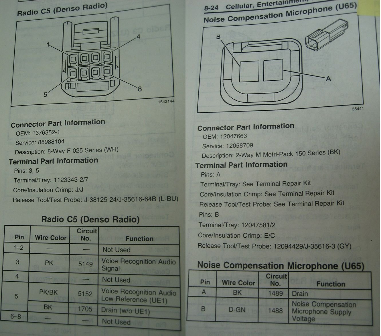

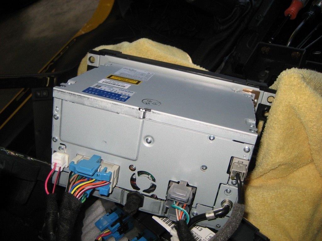

It maybe too late but just saw you old post on the Denso nav unit and have been trying to figure out what the plug on the left rear is for it has a pink and a red/black wires ?

Voice recognition microphone.

Voice recognition mike ? not noise compensation mike?

Ok got it, thanks, Also thanks for the offer but after a fiasco I went through with a company called Karmonauto who unlock Nav units and other things I bought a knock off Tech 2.
