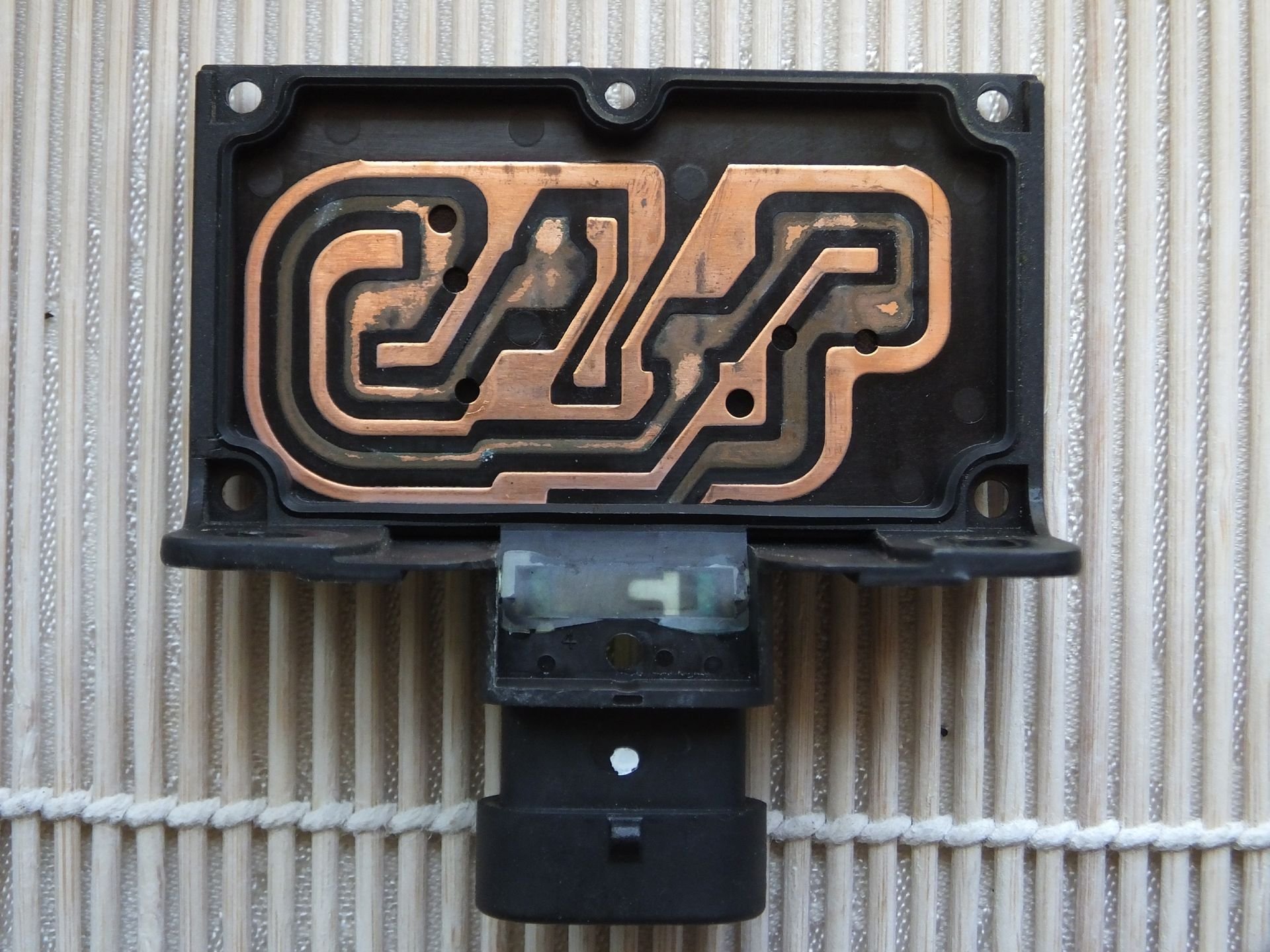

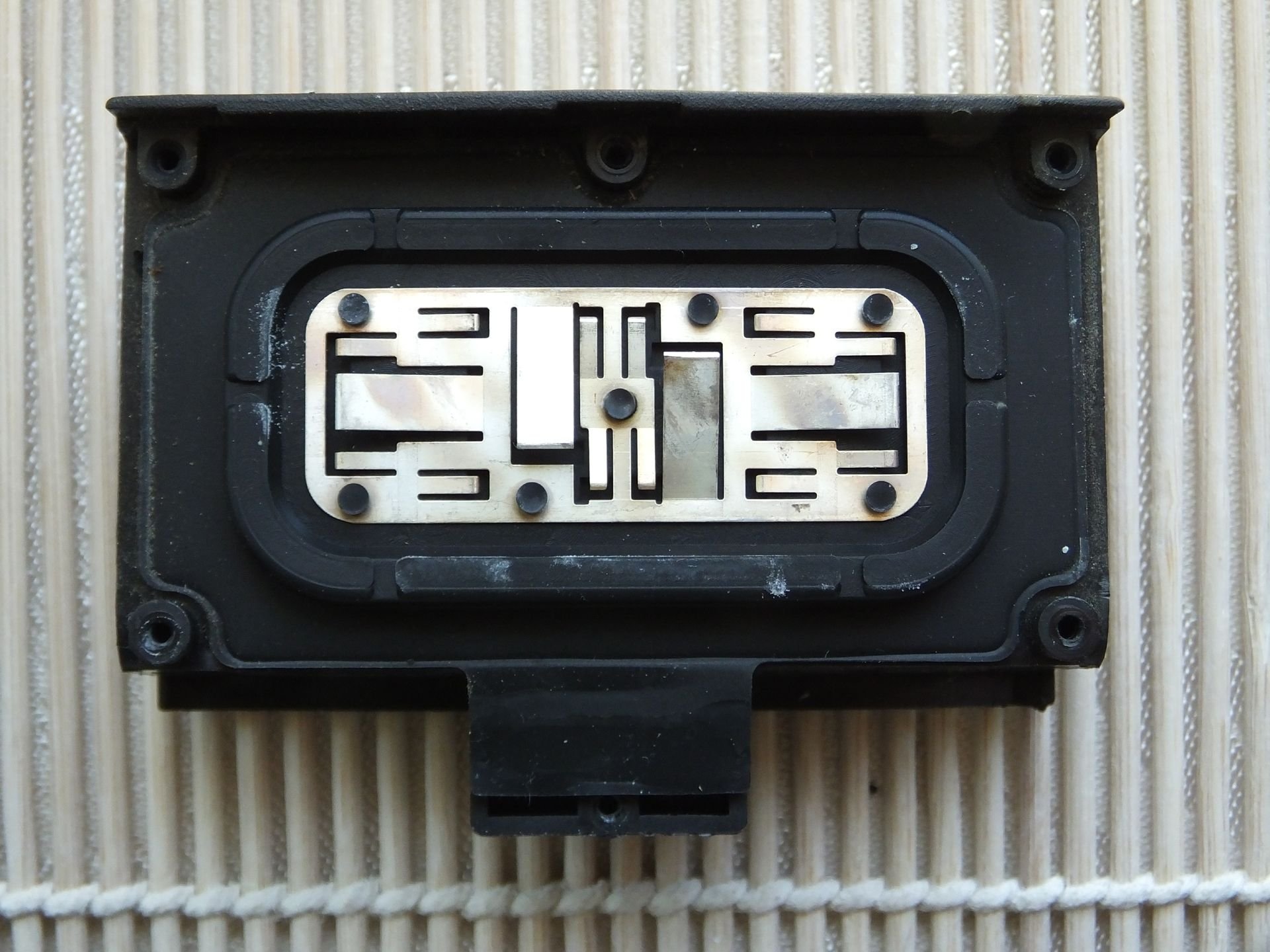

Default Repair update
To try to fix the indicated continuous window up/down cycling, I first tried pulling the battery cable to do a reboot. Results were no change, problem still exists.
Second, I pulled the driver side door switch and disassembled it. I have attached two pictures showing the parts. As you can see there is a lot of oxidation on the circuit side. The contractor side looks pretty good.
I then gave the circuit-side part a good cleaning and removed the oxidation and got looking like new. Then reassembled the switch and put it back in operation. The result at first was encouraging. After re-indexing the window it functioned correctly one time. The second time I opened and closed the door it was back to cycling.
Because the switch I disassembled was so oxidized I decided it would be a good idea to replace both with new units and I placed an order today.
In thinking about the function of these switches I am really having a hard time accepting that they would be the cause of the problem I am experiencing. These switches look like simple momentary contact switches. That means that their only function is to activate the door-open function. Once you release the button their job is done and the don't do anything else until you press them again to open the door. In other words, the act of closing the door does not involve the switch - it stays open. Since my problem is initiated by closing to door I would think that the malfunction would have to be located somewhere else. Like maybe the other door switch, the switch that tells the system that the door is closed.
Any thoughts?

Well what else happens when you push the pad besides the door opening? Right, the window indexes down! When the door is open the car stops trying to index the windows because it is not needed at that point. It's already indexed down. When the door is closed the index process starts to raise the window back up. With a faulty contact in the switch you get erratic behavior with the widow indexing. It is possible you have something else going on but I'd be surprised if the new switch doesn't fix it. In the mean time you could clean the other one on the passenger side and see what happens.
I see what you are saying about more than one thing happening when the button is pressed to open. What I am saying is that the only way for a momentary contact switch to fail is for it either to not contact, or to not open. I know it can't be the first case because the door opens fine. I suppose something funky could happen in the second case where the the switch does not open consistently or if there is some internal current leakage. Stay tuned, we will see what happens when I replace both switches.
