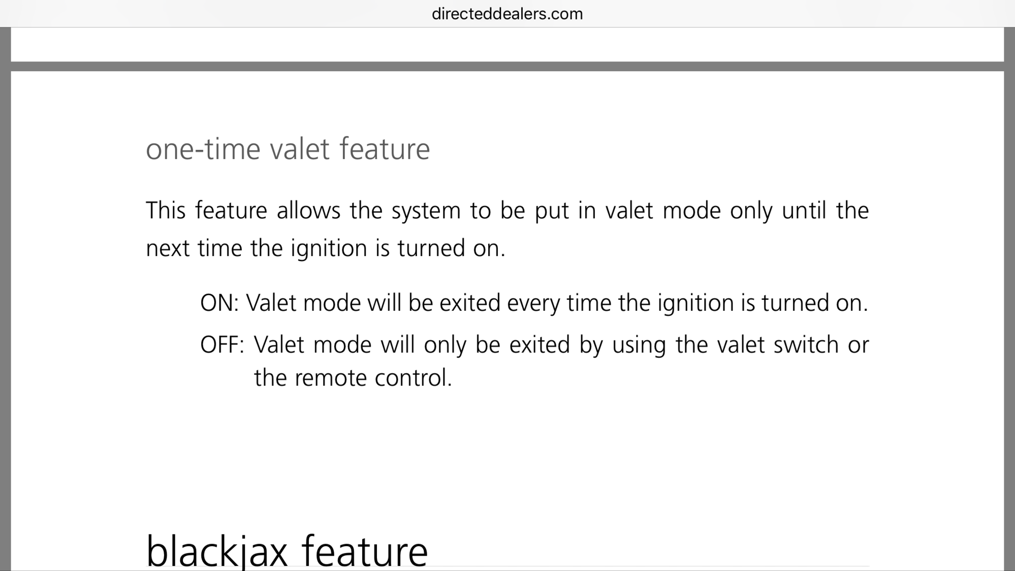

Probably does nothing unless the alarm system is still installed and working. As Slowstang305 posted, it's a valet switch for Clifford alarms. Pic below is from the manual explaining the valet use.
You will need to pull panel and check/follow the wiring. Did the seller give you any non-factory keyfobs or keyless entry fobs? If not, the switch can still be wired up for something third party like LEDs or ? but it's a low gauge , momentarily switch " I think" and doubt it's anything "important" . You will have to remove panel and trace the wires to know for sure as no one will know by online discussion. I have seen replacement panels on eBay for a low cost if it bothers you enough but after you confirm it's not in use. Get a buddy with a little time and a voltmeter.

That is definitely the button I have. Did not get any extra remotes or anything. No big deal. At least I know what it is now. Thanks guys
