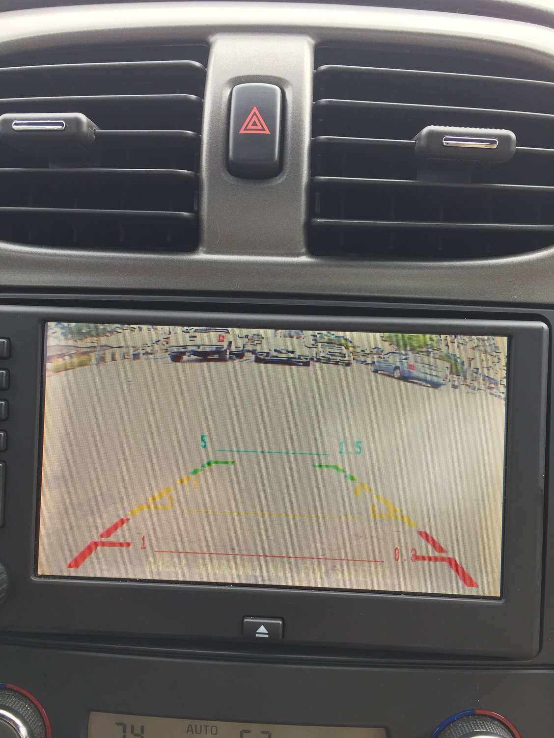

Pic of backup camera on OEM nav unit. It's much clearer than this pic though. Looks great. I put in a ISGM655 at the same time. Both working great.

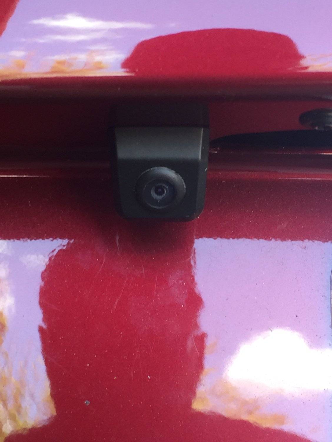

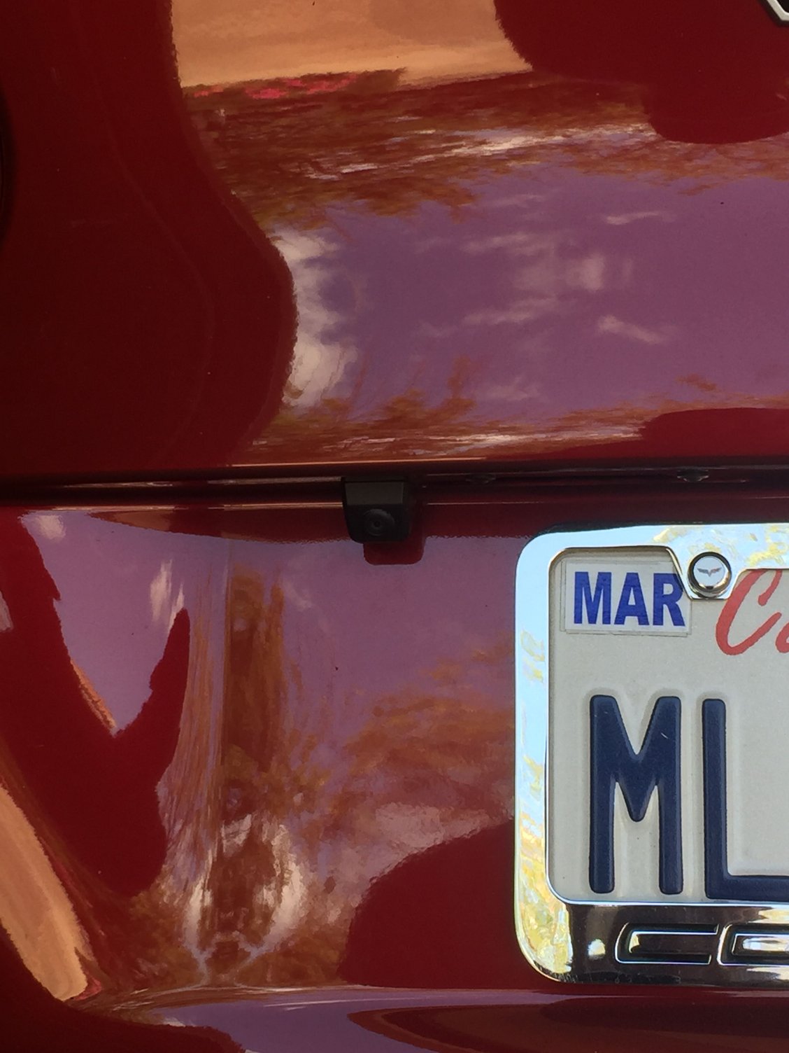

The ISGM655 is a Bluetooth device by isimple that lets me stream music and talk on my phone handsfree. The 200 is pricey but if you want to keep the features of the OEM Head unit (turn by turn directions and song info in the head up display) it's worth it. The camera is not included. But the one I bought was 12 bucks.

Couple of pics of the camera I used.

​​​​​looks great! I just ordered the navtool with the HDMI capabilities for $270, pretty happy to see the camera display looking good on the stock Nav system.

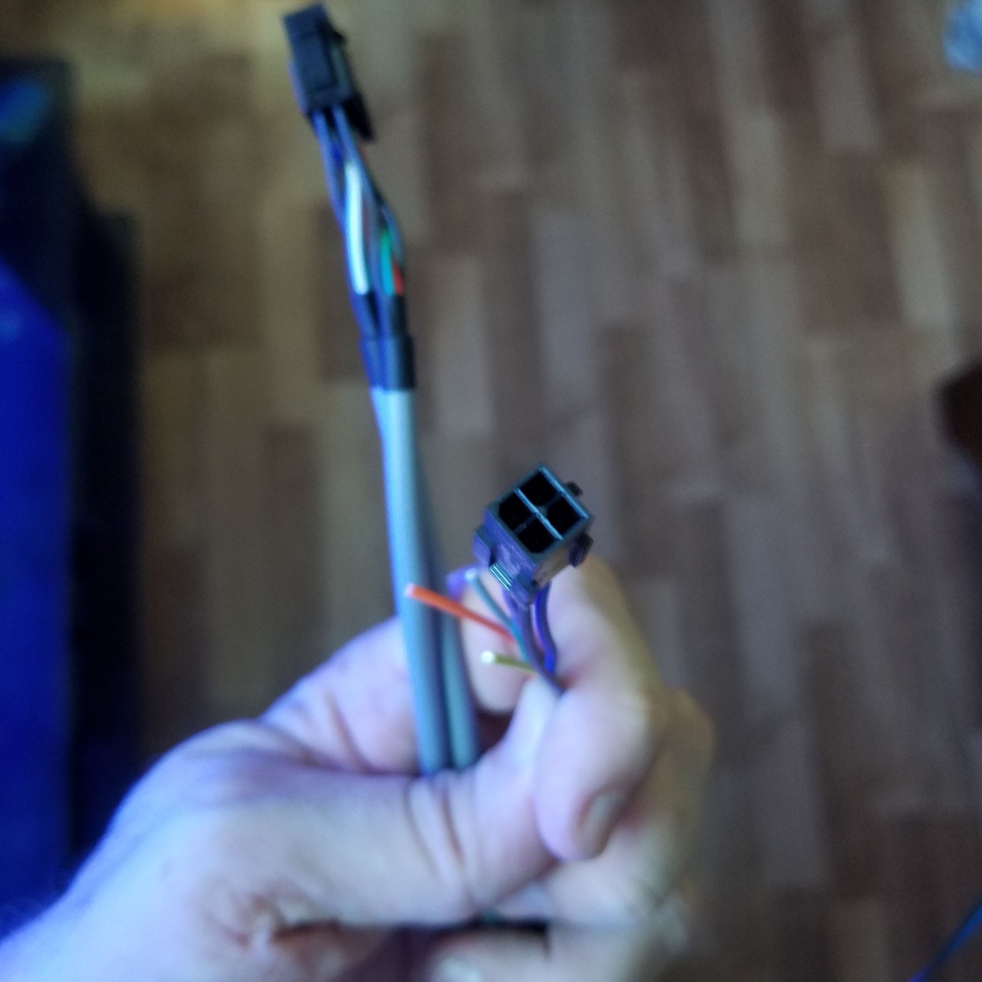

I see no instructions for the individual small color coded wires(Y,R,G,BL,O, where did you connect these. Thanks
Black is ground. Red goes to accessory power. Grey goes to ground with the Black. Yellow goes to a owner supplied switch to switch between video 1 & 2. Orange goes to backup light power source as well as to the camera. There is a backup light and accessory power source in the fuse panel in the passenger footwell. The case of the radio is grounded. That's where I got the ground from.

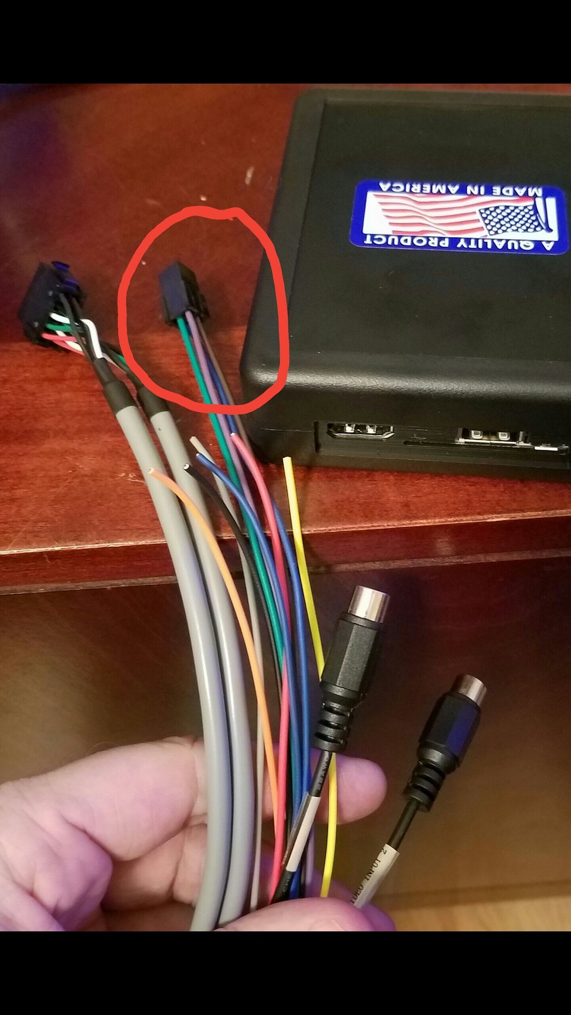

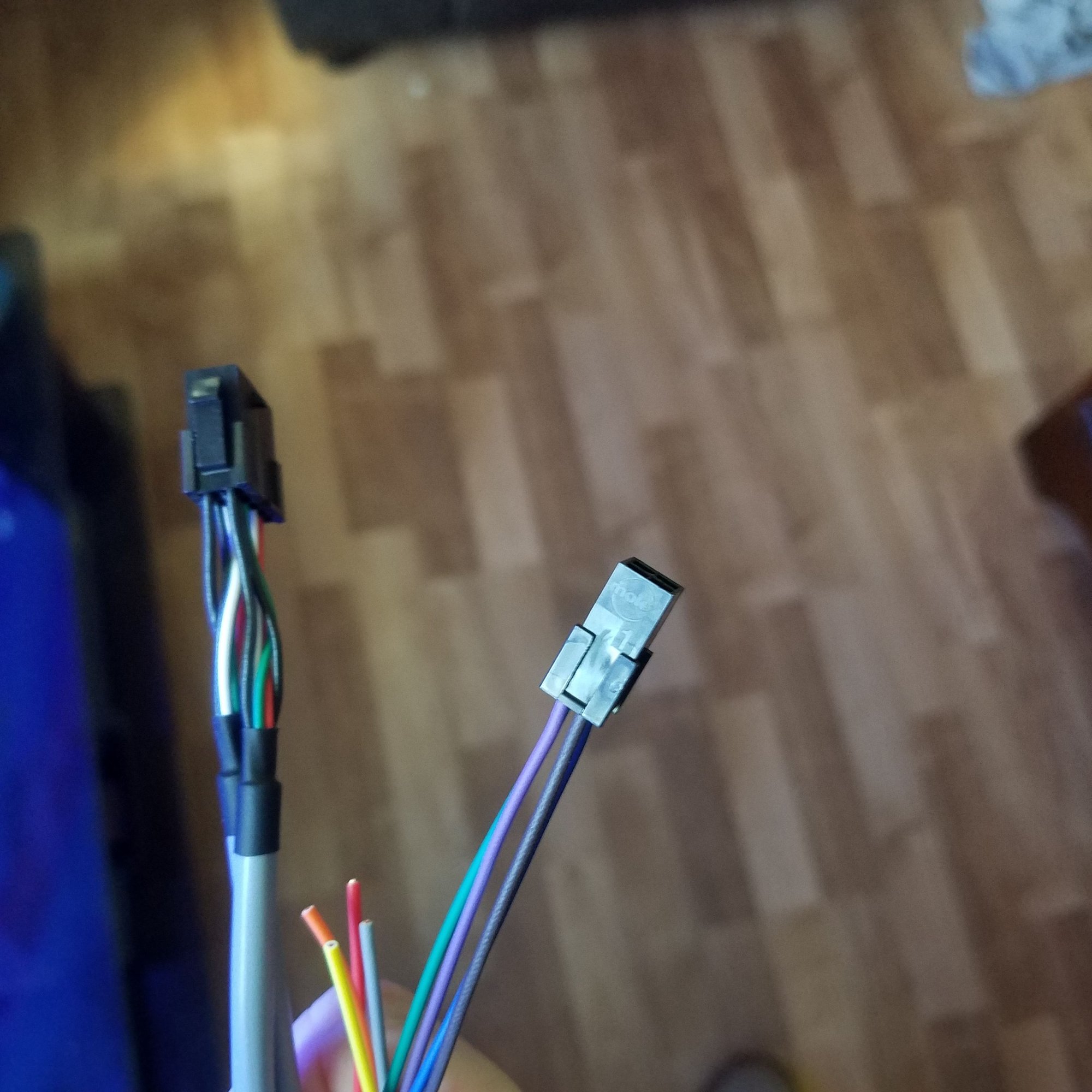

Where did you plug this 4 pin connector? I can't seem to find the place to plug this in.

Anybody know where this navtool 4 pin connector plugs in?
