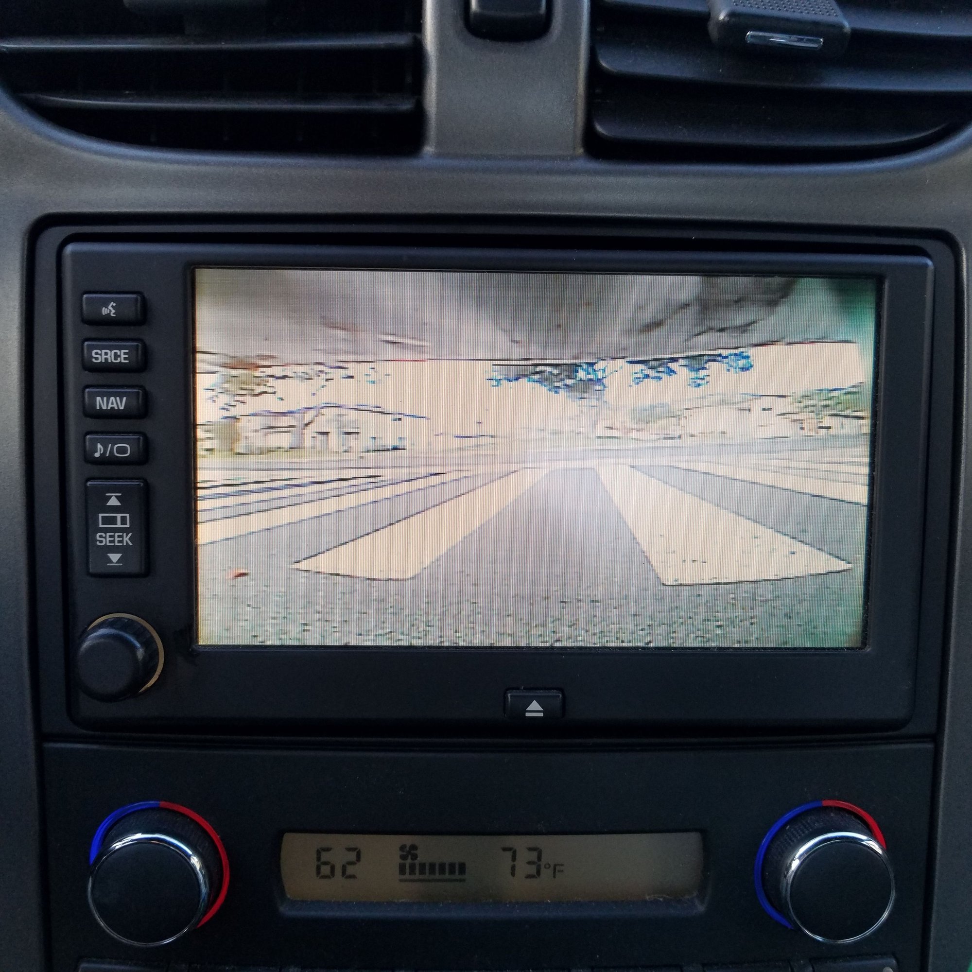

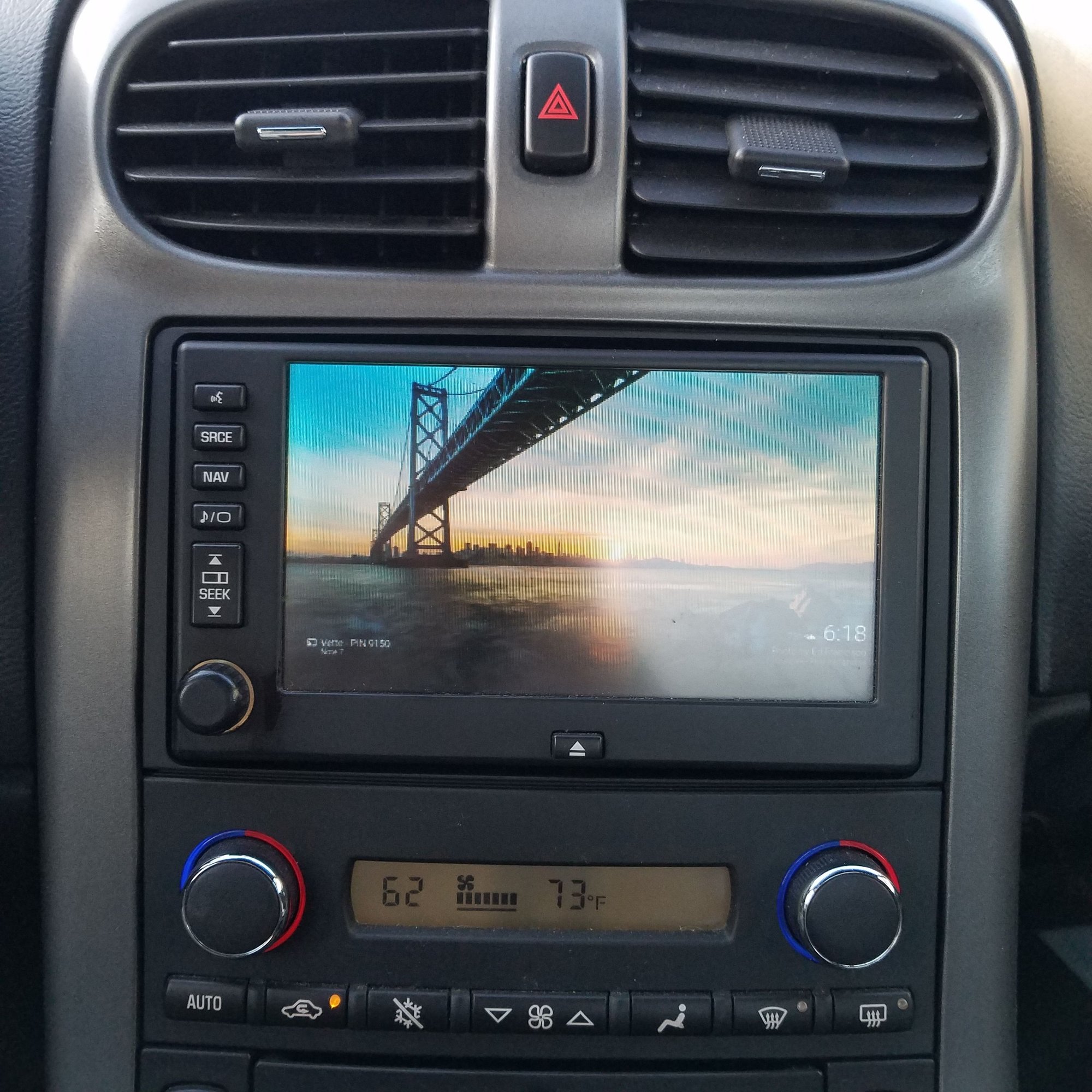

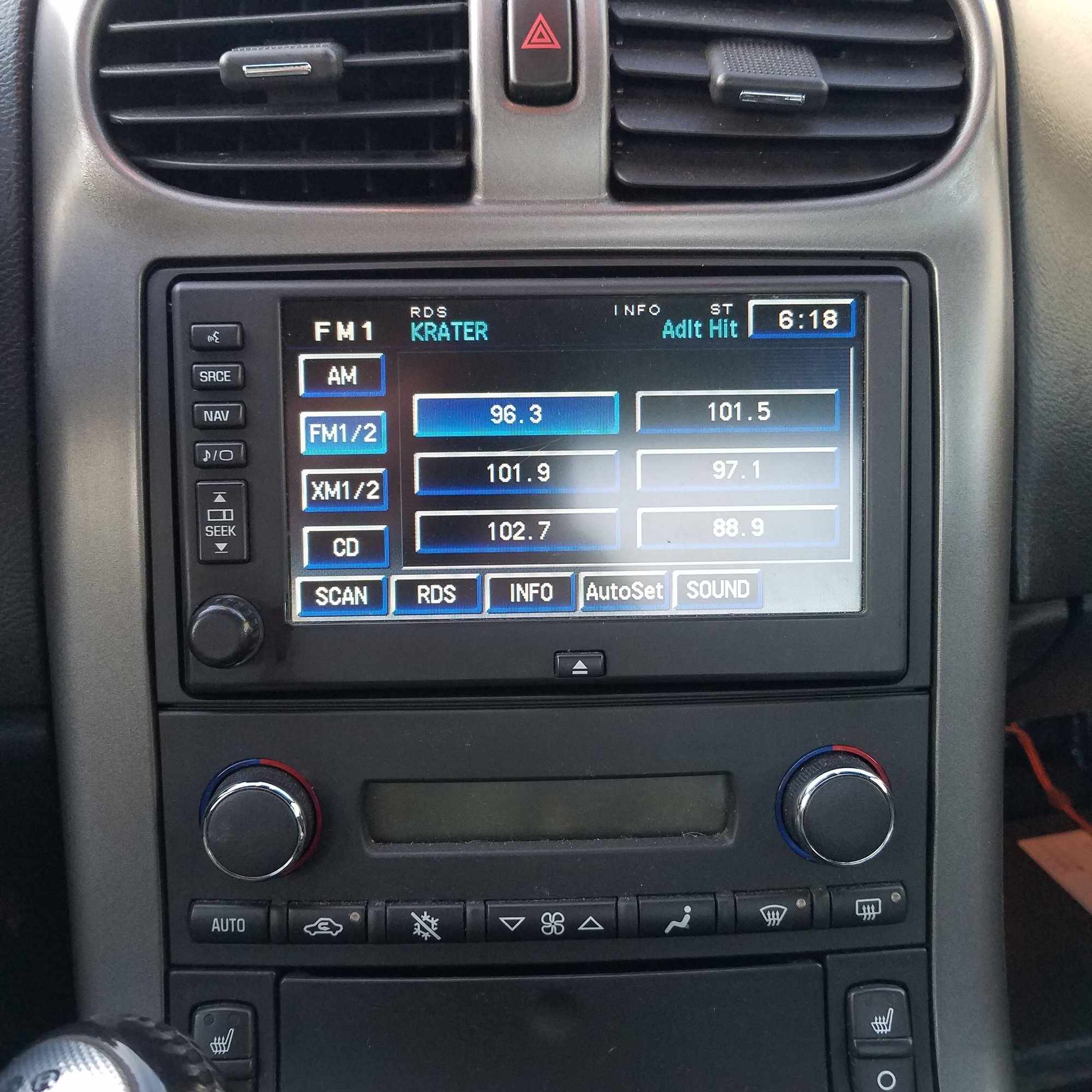

Default Got navtool installed on c6z
Front camera
(Looks like I need to clean the under side of my front bumper)
Backup camera
Screen mirroring via chromecast
