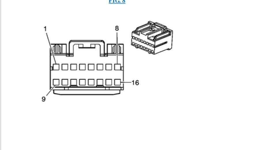

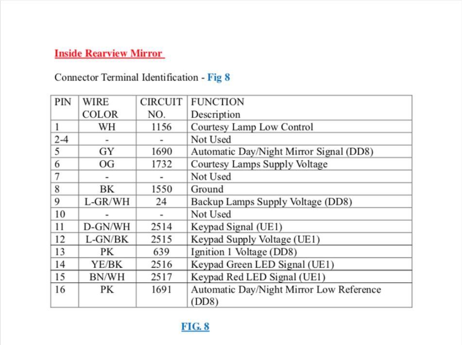

On my 2012 Grand Sport I had my mirror plug tapped with the EBAY cable I bought for my UNIDEN
R3. Was working OK, but now STOPPED working.
Ive checked R3 in another car with Cig Lighter Cable & works
Ive checked continuity of wire tap cable and its good
Ive misplaced diagram for which pins to tap in mirror plg.
Can anybody post help ???
Thanks
