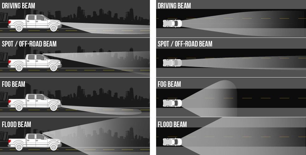

I don't see how fog lights cause issues with on coming traffic if they are pointed correctly and have the correct bulbs. Fog lights are supposed to have a wide viewing angle (from left to right) but a low height. This is why they work in poor weather conditions, they are aimed low in height so that the light isn't reflected back into the driver's eyes.
If your fog lights are bother drivers coming at you then they are not working as intended.
See top image vs third image.

I want FLOOD BEAMS!!!!!

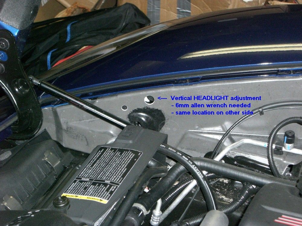

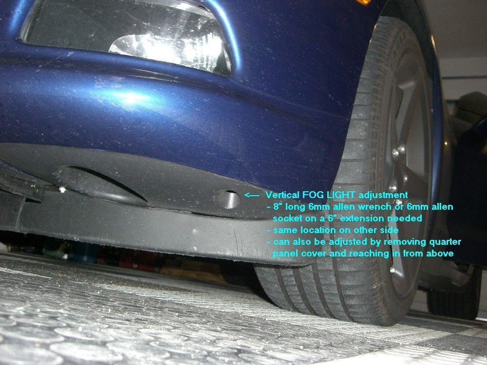

Adjust them down a bit.
Thanks for this, I just had my crazed headlights replaced and even though the shop claimed to have adjusted them, I found one much higher than the other… I found a video on YT that showed how to adjust them yourself… I didn't know the fog lights were also adjustable… Thanks again.
