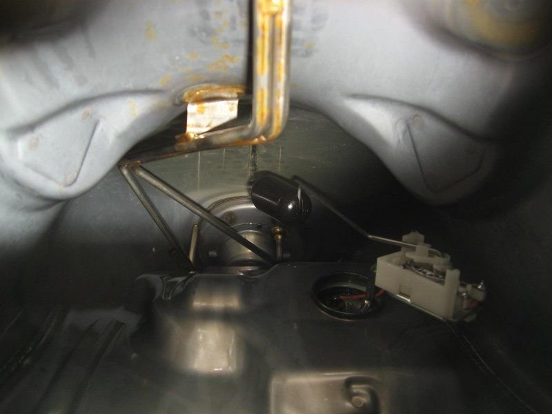

I have proof of the corrosive nature of Ethanol gas. I have a motorcycle gas tank that formed rust on the top side of the tank from ethanol exposure. Toyota has also published reports of pitting found inside of the fuel rails on some of it's vehicles from ethanol exposure. Once it absorbs water, and it will, the entire mixture becomes corrosive. With regular gas, if water gets in it, the water will sink to the bottom of the tank.
The problem with such “proof” is establishing causality. Some damage is found. Gas with ethanol was used part or most of the time. But was ethanol the cause? To determine that, you’d need a controlled experiment. Test identical vehicles (or tanks, or fuel system components) with and without ethanol and see if there’s a difference. Some such tests have been done, but none that I know of have been unbiased. Almost all support the desired conclusion of the sponsoring group. One was just finished by a “green” group, which said pure gas is clearly more corrosive than E10. The bias gets introduced by the exact way they make up the test fuels, or the conditions to which they are subjected. Tests sponsored by “greenies” tend to handle the test fuels with extra care or choose testing situations that emphasize normalcy. Tests sponsored by those opposed to ethanol tend to subject the test fuels to undue stresses or choose extreme testing situations.
While I’m not familiar with the Toyota paper you mentioned, most manufacturer studies are statistical analysis of warranty data, and a favorite saying of engineers is that there are lies, damn lies, and statistics. So about all we can say on causality with certainty is that various plastics, resins, and rubbers used in fuel system components before the early 1990’s were clearly susceptible to attack by ethanol containing fuel. On more modern cars, all you can say with confidence is that differences are not large, because if they were, all would have to acknowledge that obvious an answer. On engines other than cars (such as motorcycles, lawn mowers, etc), while the answers still aren’t clear, there is more room for questioning because their fuel tanks are not as well isolated.
As far as water absorption, as I pointed out earlier, pure gas absorbs water too. Yes, E10 will absorb more, but it’s not true to imply that water drops out of gas without any absorption while it gets massively absorbed into E10.

Rust was found in tank when motorocycle was less than 2 years old. E10 gas is all that has ever been used in it. Tank is kept full all the time. Rust is evident even on internal tubes inside the tank.
There is obviously no point in arguing with you. Don't believe me if you want, I don't really care, but the fact is that E10 gas becomes corrosive when it absorbs water as it holds the water in suspension.
Rust was found in tank when motorcycle was less than 2 years old. E10 gas is all that has ever been used in it. Tank is kept full all the time. Rust is evident even on internal tubes inside the tank.
Did you have an equivalent motorcycle next to it at all times, the only variable being that it had non-ethanol gas?
Without that control, how can you conclude anything about the rust?
