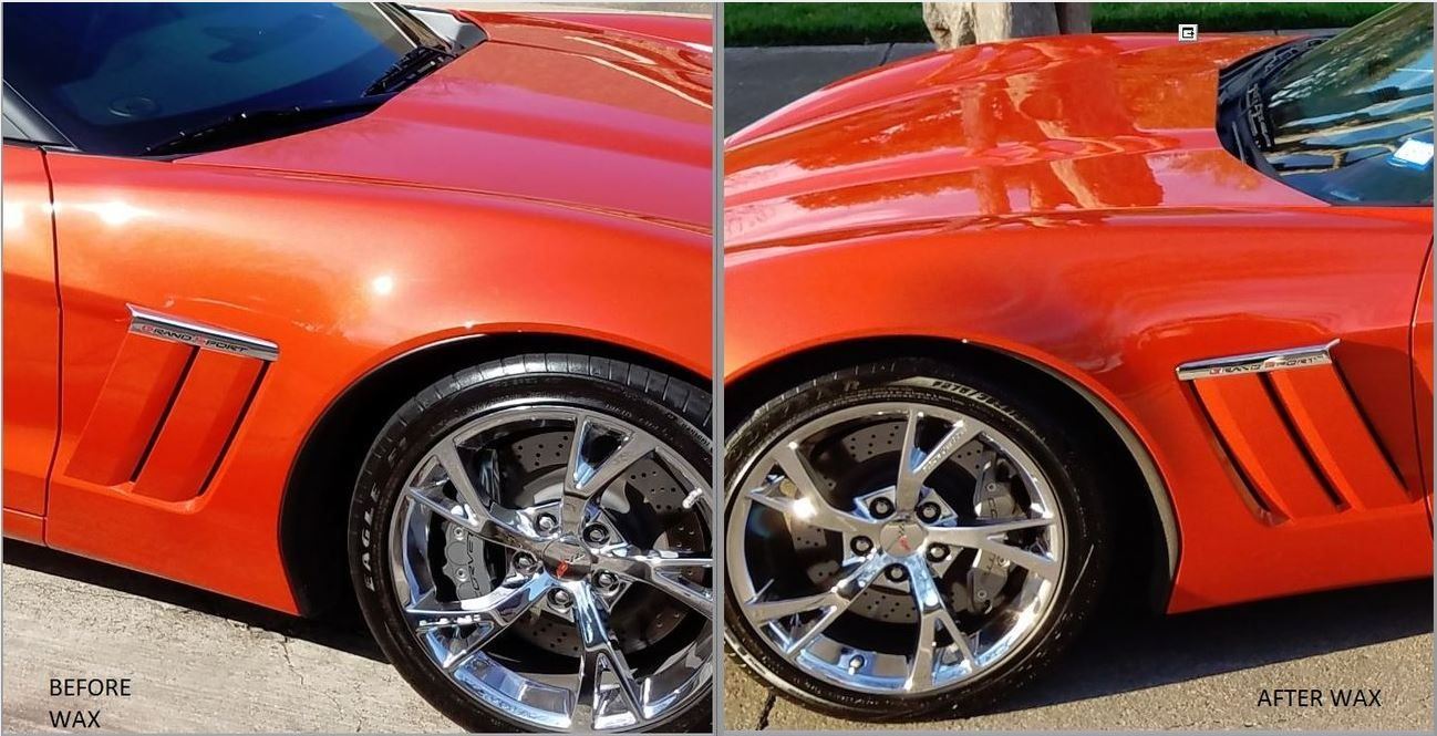

JABMAN - I'm in far north Dallas and also interested. I have the Porter Cable XP, 7 different pads, and two massive tubs of the Meguiars cutting compound and polish. Bought it all in order to due a correction myself, just haven't gotten around to it. Willing to give it a try if you are. I also have an Inferno Orange GS (best color, obv). Let me know if you ever want to do "Detail day".
Also- if you find a good guy to do paint correction professionally at a reasonable cost, let me know. Interested. I'm also overdue for a clay.

Also- very happy with the results with the Porter Cable XP. I used it once so far- did a wash, clay, and wax. Gave it a great glassy finish. Like you though- swirls (thanks, GM) at close look under direct light.
