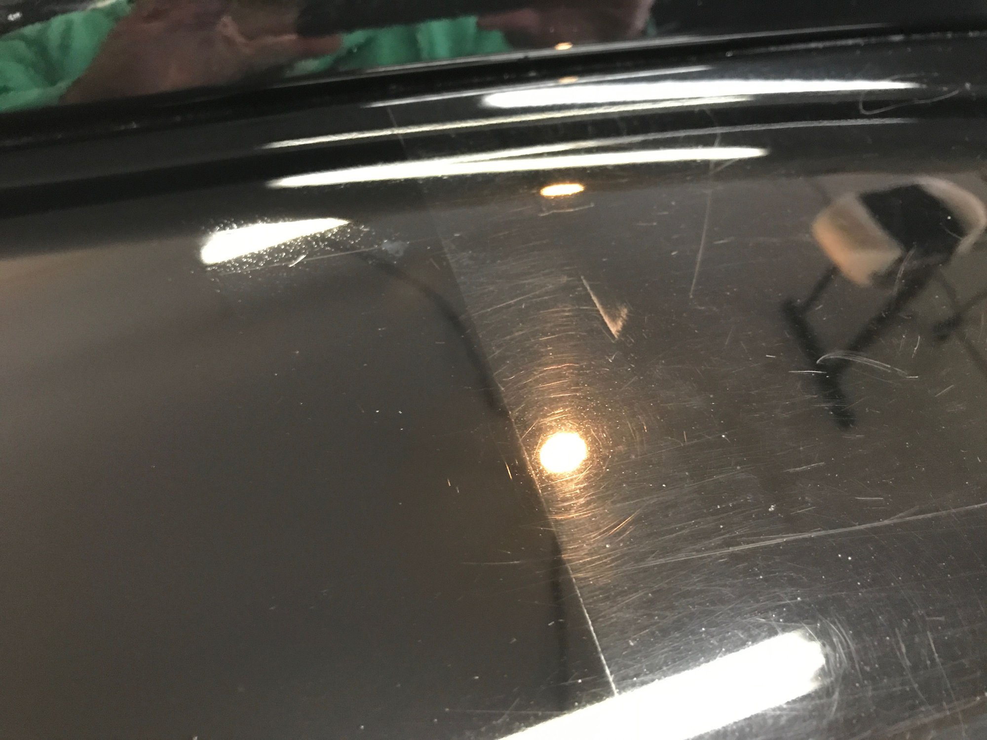

I finally clayed the car this weekend & while it is now super smooth, under florescent lights you can see all the imperfections, swirls, fine scratches, etc. It seriously looks like it was washed & dried with sandpaper. Luckily in the sun you don’t notice it as much, but I want to get that fixed & then ceramic coated. What is a typical/fair price for paint correction? Pics for attention - thanks!
This is the nature of the beast with clay. No matter how much lube you use, if your paint is contaminated and you clay you WILL induce swirling and scratching. Clay should always be the first step in detailing, not a standalone process. BTW, grab the Mother's SpeedClay 2.0 it is leaps and bounds ahead of traditional 'clay'.
If you are so inclined, pick up an inexpensive orbital polisher, or spend a buck or two and get a Porter Cable 7424, or go nuts and get a Rupes. Then grab a polishing pad and some Meguiar's Ultimate Compound. You will get all of those clay scratches out. Finish with wax and you will be amazed at the results. FWIW, my PC 7424 has been a workhorse for me for 12 years and I've done dozens of cars.
To answer your question, while it's impossible to quote what it will cost you because we don't know the exact condition of your car, I would say exterior polish and wax only should be somewhere around $150 - mind you this isn't slapping on some concealer and Turtle Wax; this is a proper detailing shop correcting your paint. I picked up detailing about a dozen years ago and not much more in my life is more therapeutic - to see fouled paint turn into liquid metal.
On that note, here's a Jeep Wrangler I recently did: 8 years of neglect + 2 passes with clay on the right...on the left, the result with a PC and Meg's Ultimate Compound.
Thanks for the additional info it is helpful. With regards to the swirls & fine scratches, I’m pretty sure most, if not all, were there well before I clayed the car. I would guess from the condition of the engine bay, undercarriage, wheel wells, etc. this car was probably never hand washed by the previous owner(s). I’ve clayed my other two cars & not ended up with any swirls or fine scratches, but I also bought both brand new an take care of them meticulously. Trying to get the GS back to my standards

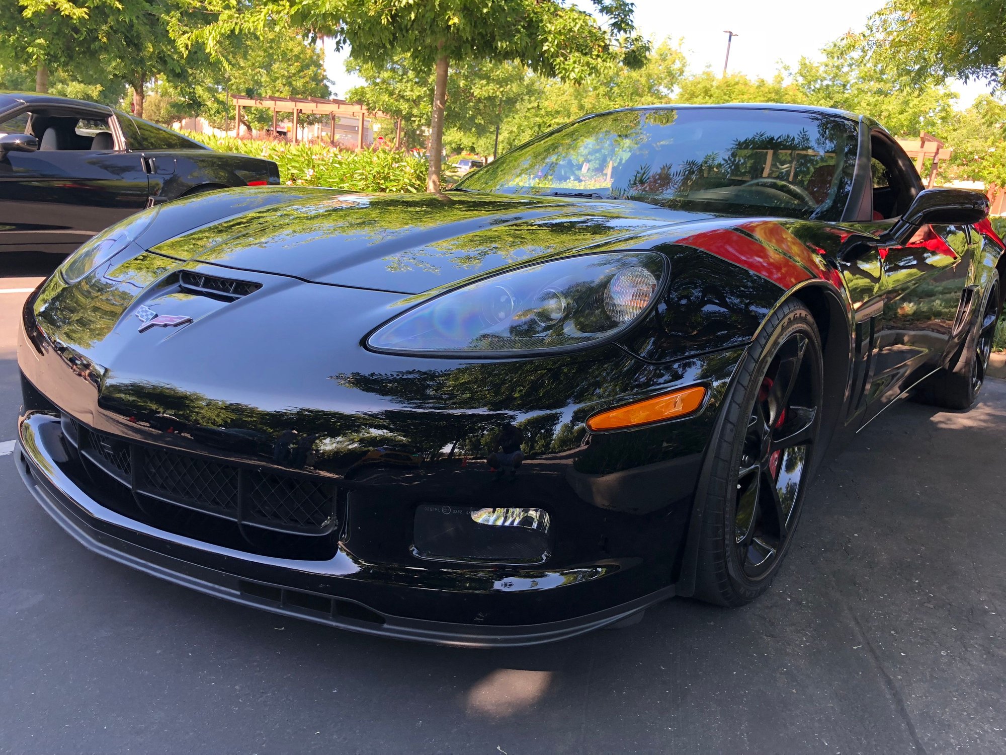

After a true paint correction, the swirls do not come back after a single wash. Now you might introduce new swirls if you have a poor washing method or not the best washing mitt. Also depends if you used a real polish or a glaze which just fills in the swirls. Those swirls will come back after a couple of washes.
I did a full paint correction on my 2013 GS when I first bought it. Wash, clay, 2 stage polish with my Flex, and seal. Now in 2018, my GS has reached the point where I can tell it may need correcting again. Just haven’t done it yet because (1) I am being lazy and (2) it is hard to see the swirls from 5+ feet away. You really have to get close to the paint to see the swirls.
Here are some pics from 2013 right after I did the paint correction.
Mirror-like finish
Looks like it is wet
Zero swirls
Here is a picture I took in April
And a picture I took from this past weekend.
