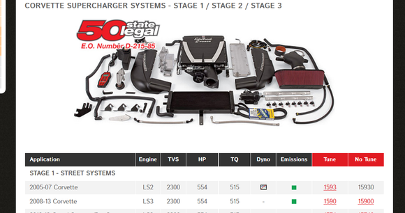

I once looked into supercharging and found this Edelbrock eForce supercharger. When I read the chart in their catalog I thought it had to be a misprint when comparing the net HP gain by putting the stage 1 kit on an LS2 and LS3.
