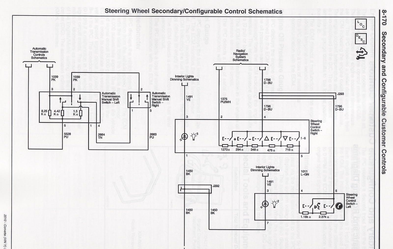

you can disconnect the clockspring plug at the steering column, you would check for resistance on 2 wires when you push the paddles, I'm not sure what wires, I think Black and Blue or Black and Green but not 100%

The steering wheel position sensor is about half way down the steering column, and is not part of the clock spring.
So tech II will only tell you if the steering wheel position sensor is set to zero, or the wheel is one rotation out instead.
So what you have is either a problem in the shifter buttons, the clock spring, or the wires/connectors for the clock spring and shifter buttons isntead.
If the shop did not pull the steering wheel, did not screw up the connectors under the dash, then bank that the problem was either the clock spring destroyed by the wheel turned a few winds disconnected, or they did someone in the tune that took out the shifter buttons isntead.
