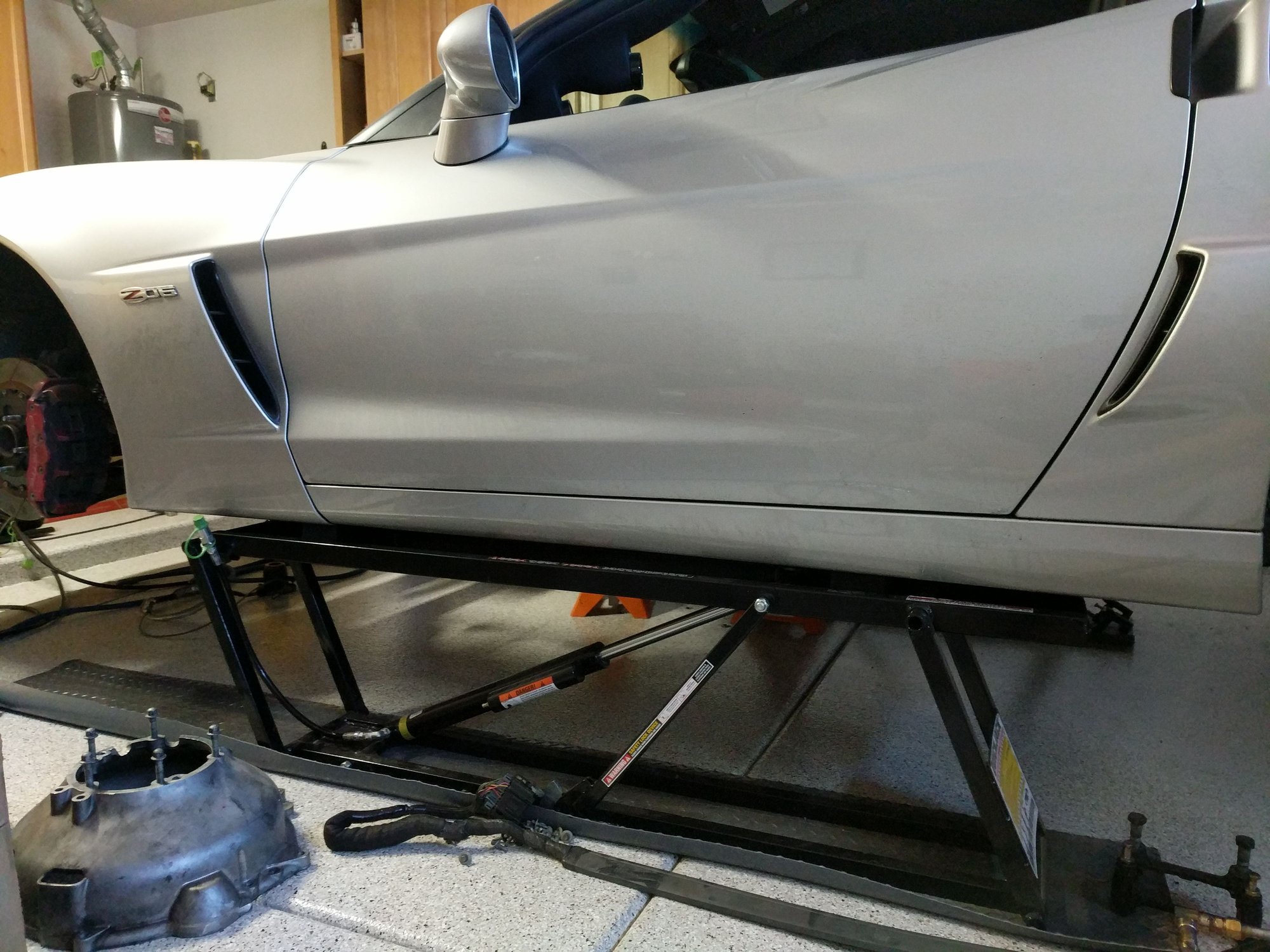

Just got my Quickjack put together, but haven’t tested it with my C6 yet. The lift points on the car in the owners manual don’t seem to be compatible with the quickjack. Can anyone show me what lift points they are using with their quickjack? Photos greatly appreciated.

+1 and most of us will use jacking pucks to make sure the lift pads stay clear of the body panels where they wrap around underneath.

I get the quickjack supplied rubber blocks positioned directly under the lift points on the frame rails, and they fit easily in the body panel “cut out” area around the frame rail lift points. Using the metal jacking pucks that I have, made the car pretty unstable during the lift process ....mine actually started to slide off on one side when I lifted the car...with my jacking pucks installed and also using the quickjack rubber blocks....so I don’t use my jacking pucks with my quickjack. Maybe “rubber” jacking pucks might work better vs metal ones....but the different sized rubber blocks that quickjack sent along, work fine.

I also have the 5000, and plan on using the lifting points shown, with the supplied rubber blocks. In the owners manual it shows lifting points on the frame, just inside the wheels. I don’t see how a quickjack could use those points. They seem to be more intended for a professional lift like what you would find at a shop.

From reading what you just posted, it sounds like you are confused. Those Red Circles are the same place the owners manual shows. The Red Cirlces are the frame. They make “pucks” that lock in to those holes in the frame so you can use a lift. The manual also shows one place front and rear on the crossmembers that you can “jack” the vehicle up, but those points are not for using a “lift”. Once you have your vehicle up on the QJ, you will see. I love my QJ, but before I bought it, I lifted my Vette using the crossmembers as mention in the manual... I would not want to lift the whole vehicle that way, only one end at a time. But it’s good enough to get some Jack Stands under.

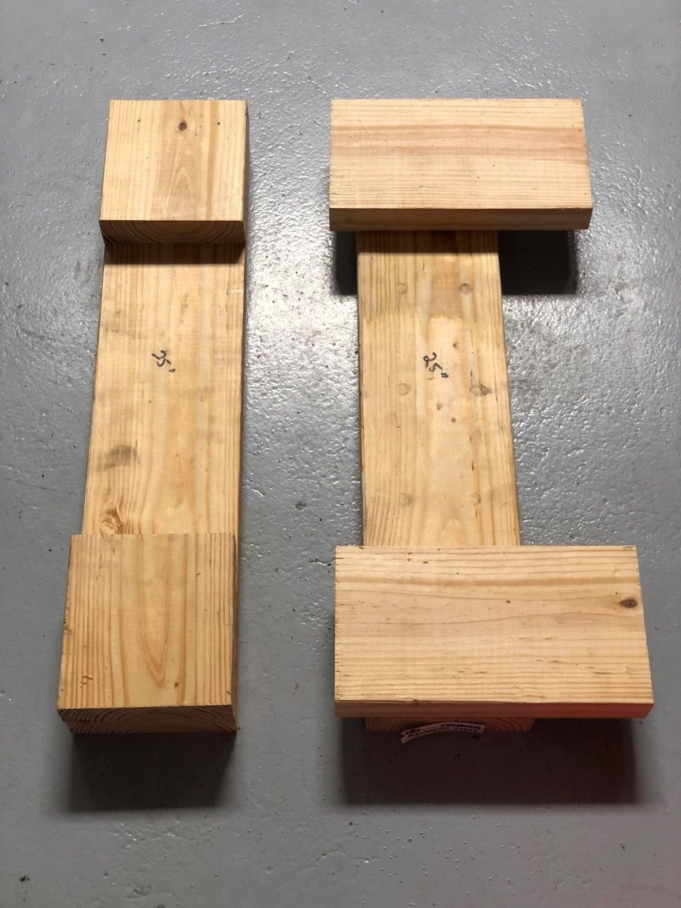

Originally Posted by toytruckman
Sorry for the guy going turtle, but can some one point arrows to the jack points other than the frame pad points. That is the perfect picture for demo purposes.
Like where to place jack stands.
Thanks
Dave
Ok. Yellow arrows below point to jack stand locations on the front and rear cross members. These locations are not to be used with the QuickJack. This photo actually isn't great to show the rear locations. In the front, the cross member behind the leaf spring (not labeled) can also be used, but is hard to reach with a jack. It's not a good idea to jack directly on the cross members. At a minimum a 2x4 should be used. Some people say that while it's ok to support the car at the yellow arrow locations shown, it's not a good idea to lift the car from the center of the cross member even with a 2x4. The second photos shows 2x6's with blocks on each side to allow the jack to be used in the center with weight being transferred the sides. (Front on left and rear on right.) Once lifted the jack stands can be put in place and the jack lowered. Some people worry about the wood giving way and fabricate a metal version of these supports. It's also a good idea to drive the car up onto 2x6's before jacking so there's enough room to get the jack under the front cross member. Probably more than you wanted to know and sliding off topic for this thread. QuickJack is so much more convenient.
