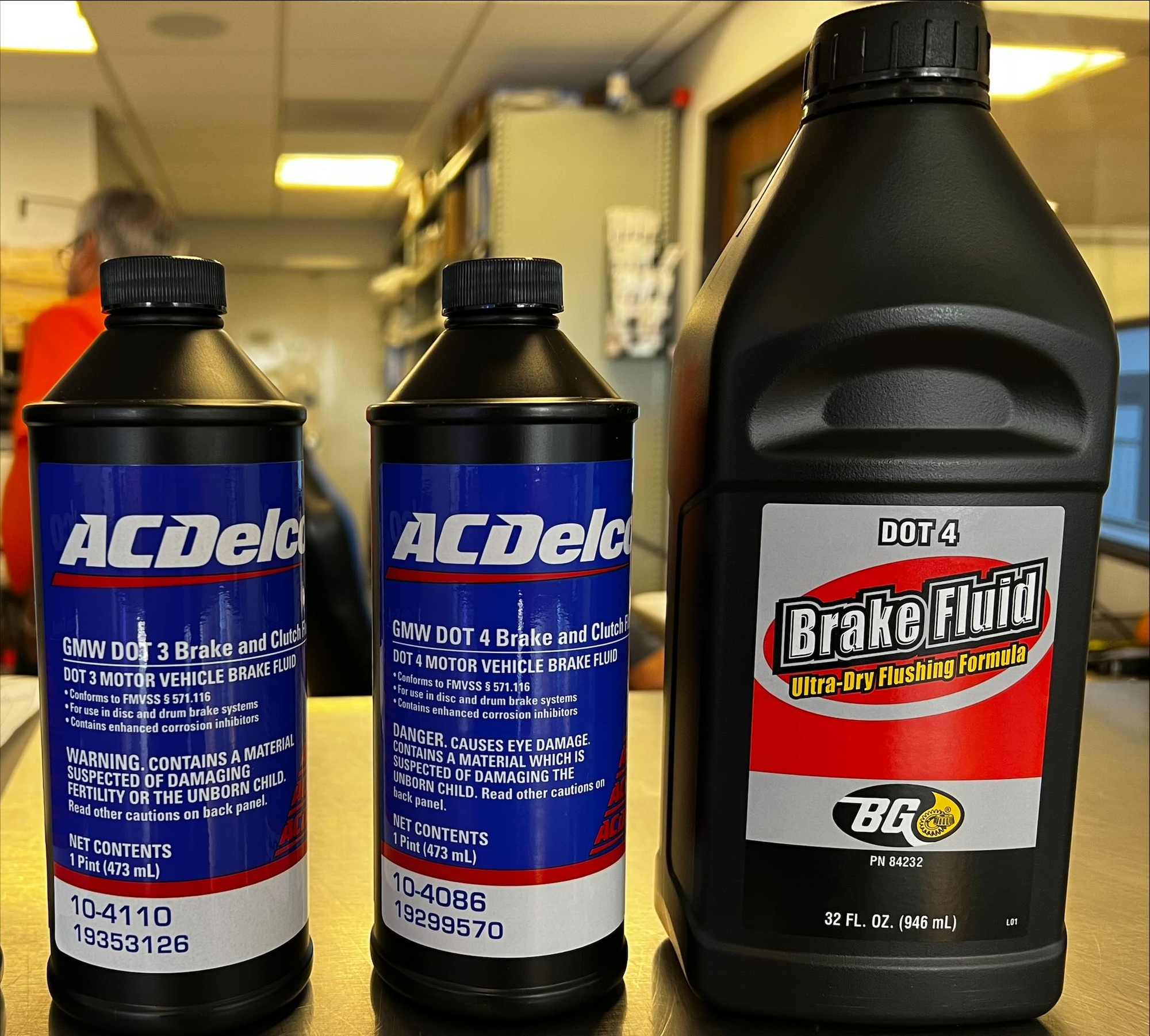

I have a 2007 C6 and want to do a flush, the owners manual says to use "Delco Supreme 11 DOT3 brake fluid" but I can't find it. I went to the dealership to see what they use. The Dot 3 ($10) on the left is what the car originally used when new. The Dot 4 ($20) (middle) is what they use in the new Corvettes and is okay for the C6. The jug on the right BG ($80) is what the dealership will use if you get the brake flush service. Just want to share this research to maybe save you a trip to the stealership.
