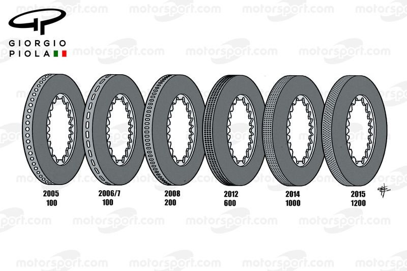

Exactly, which is why I showed brakes from LeMans cars and motorcycles as well. Eirher way. F1 cars don't run the same pad or rotor compound every race, just like what was mentioned they change depending on ambient temperatures or rain. They would never run hot weather setups in the rain for the exact reasons mentioned, however once once they're hot, braking dynamics are still the same.

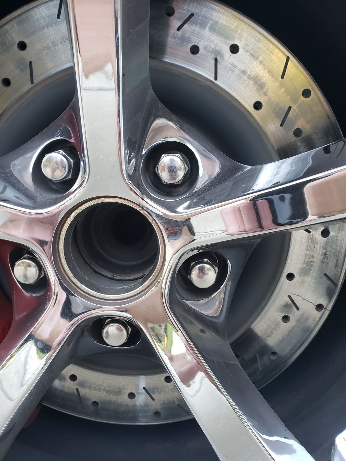

To the bolded part from Hoxxy. Road course cars get a cool down lap for this reason. Where you're supposed to make your entire lap without applying the brakes at all. The times I see the biggest problems are limited cool down then applying the parking brake. Still, you can do everything right and still break apart a drilled rotor. I have a box of them somewhere. Beyond thermal cracks I have never broken a blank rotor, and once switching to only slotted never had another thermal crack either.
