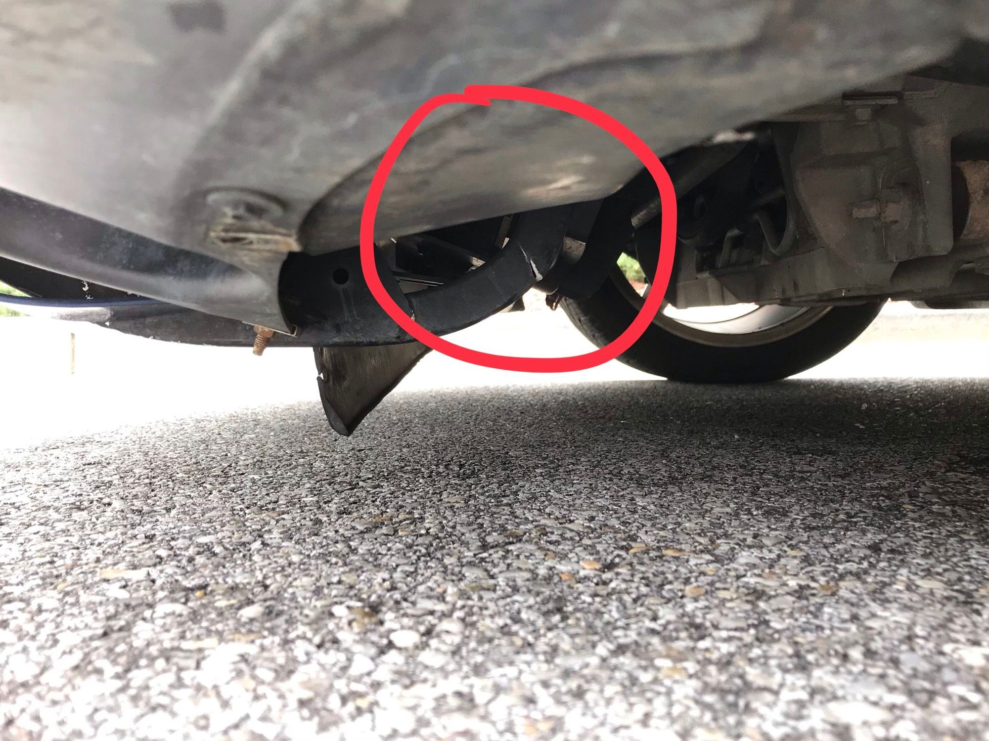

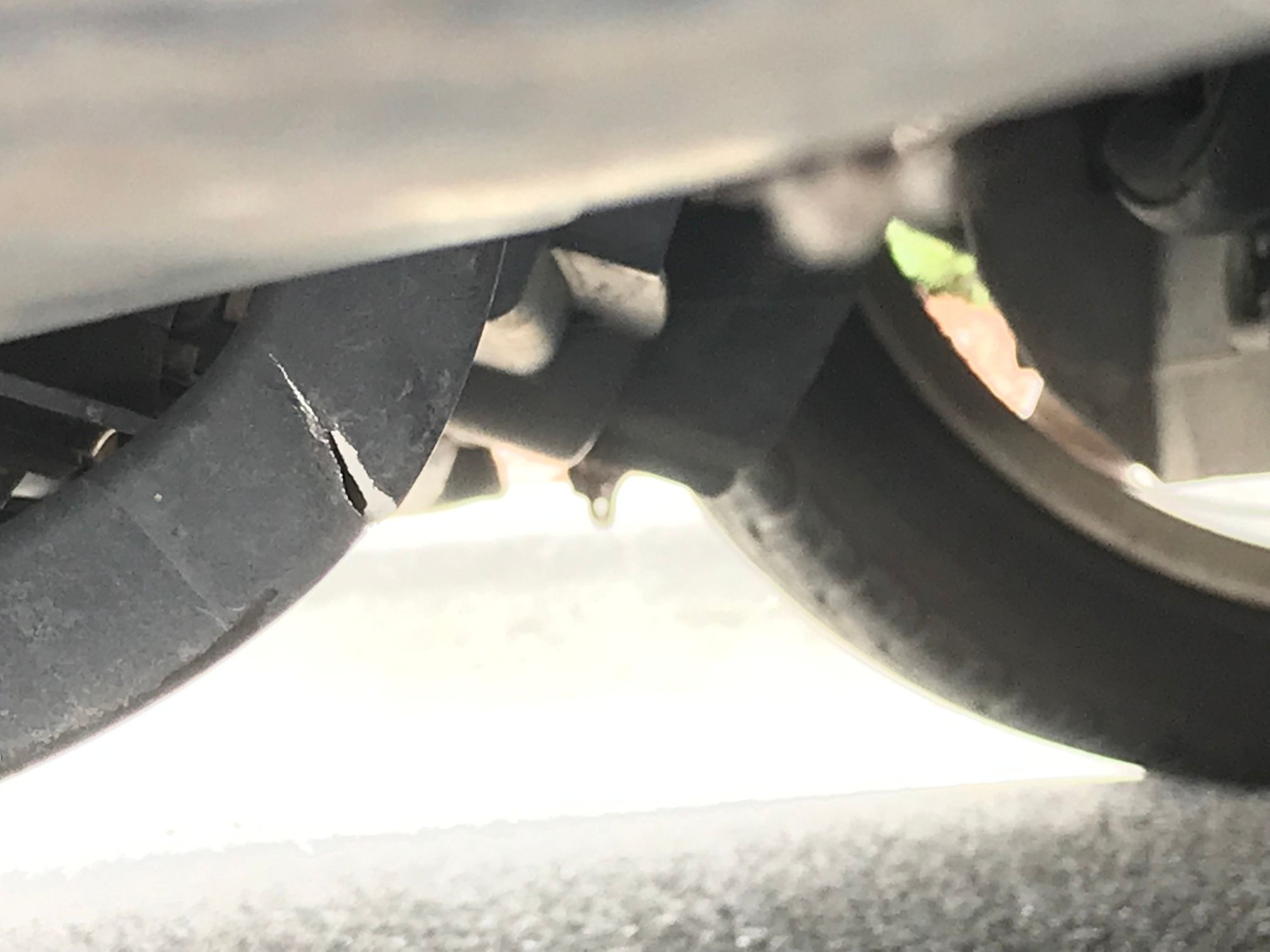

I hit a speed bump a bit too fast in my 2005 C6. I looked underneath the vehicle and see a piece that broke or at least cracked. I'm on a business trip and am trying to figure out if this is something that can wait till I get home or needs immediate attention.I'm in Mobile on my way to New Orleans. I'd rather deal with it in Montgomery when I get back.

That's your radiator support frame. I wouldn't be driving it in that condition.

It’s not broken clear off, if I was in your position, I’d get a piece of flat bar 5-6” long, form it to fit and get 4 of the most robust hose clamps you can find and clamp it on there and finish my trip. OR find someone that will weld it up for you.

I agree that you should get that looked after ASAP. If nothing else, do a temp fix, or try to find a welding shop that can at least tack it until you get back home.
It would only take them 5 minutes to do a quick patch job.

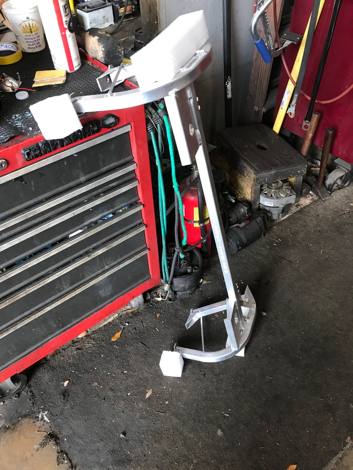

I'm in a good company at Florio Corvettes.
Old Mar 14, 2019 | 04:35 PM
Efendi007's Avatar
Efendi007
Joined: Aug 2018
Posts: 19
The support was broke off at the top in both mounting spots. It only held on one side. Not fixing it was not an option.
