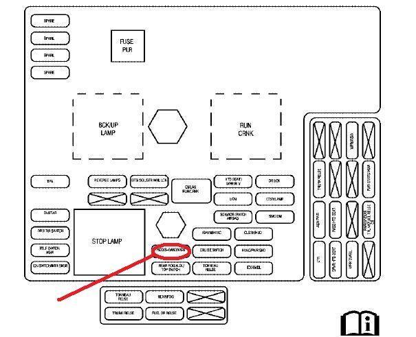

Well, I just tried the update. It seemed to do everything it was supposed to do. The progress bar did it's thing. Then the Corvette emblem came back up so I took out the disc and put the NAV DVD back in. But when I went to set the clock it still wouldn't set. I got out of the clock setting screen and went back in several times but still no go. Any ideas?
It’s been quite a while since I did this, but I believe you can either set the time manually once the fix had been applied, or set it up to use the GPS signal to supply the time. In the latter case, your time zone and DST settings must be correct for your location.
It’s all explained in the user manual which I’ve attached. Keep in mind that you need to have the car outside in order to get a GPS signal.

You could try pulling the fuse for the nav unit and then reinstall it after a couple of minutes. Maybe a reboot will bring it to its senses. If that doesn’t work, you could try reinstalling the fix that you applied.

Disconnect the battery for a couple of minutes with the fix-it dick in it before you disconnect the battery then hook battery back-up and see if it will recognize the disk. Mine went out meaning clock when I pulled the battery for the winter and six months later no clock.

Maybe I'm a little slow. I'm not quite following the sequence you're suggesting. Are you saying to run the fix-it disc, then disconnect the battery? Then re-connect the battery and eject the disc? Or something else?

No I did not say it right. Before you disconnect the battery have the fix-it dick already in the cd slot and then unhook-up the battery then hook-up the battery again after 5minutes and make sure your outdoors when you do it. I have aluminum insulation on my roof on the inside and did not work the first time then read the disk instruction that came with the car and it said it should be clear to have the satellite communicate with your car. Don't ask me where but I did read it. Worth a try.
