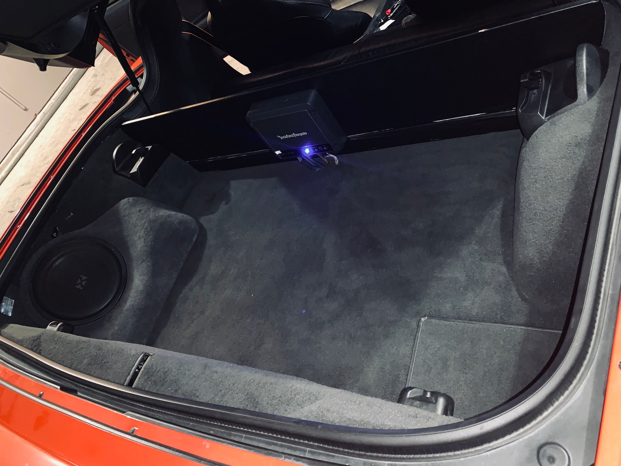

I have this NVX sub & Rockford Fosgate amp in the rear. 1/2 the price of the JL Audio sub enclosure & obviously not as high quality but sounds good to me. I can always replace the sub itself down the road. I can fit 2 carry-on suitcases plus the targa top with room to spare.
. How does this help the OP when he has a Convertible ?
It appears I missed the last sentence in the OP's post prior to responding - my bad. Obviously my intent was to offer a suggestion, & the OP could easily ignore it if, but thanks for pointing it out without adding anything useful yourself
