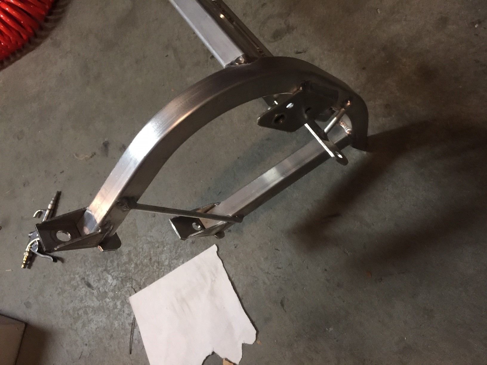

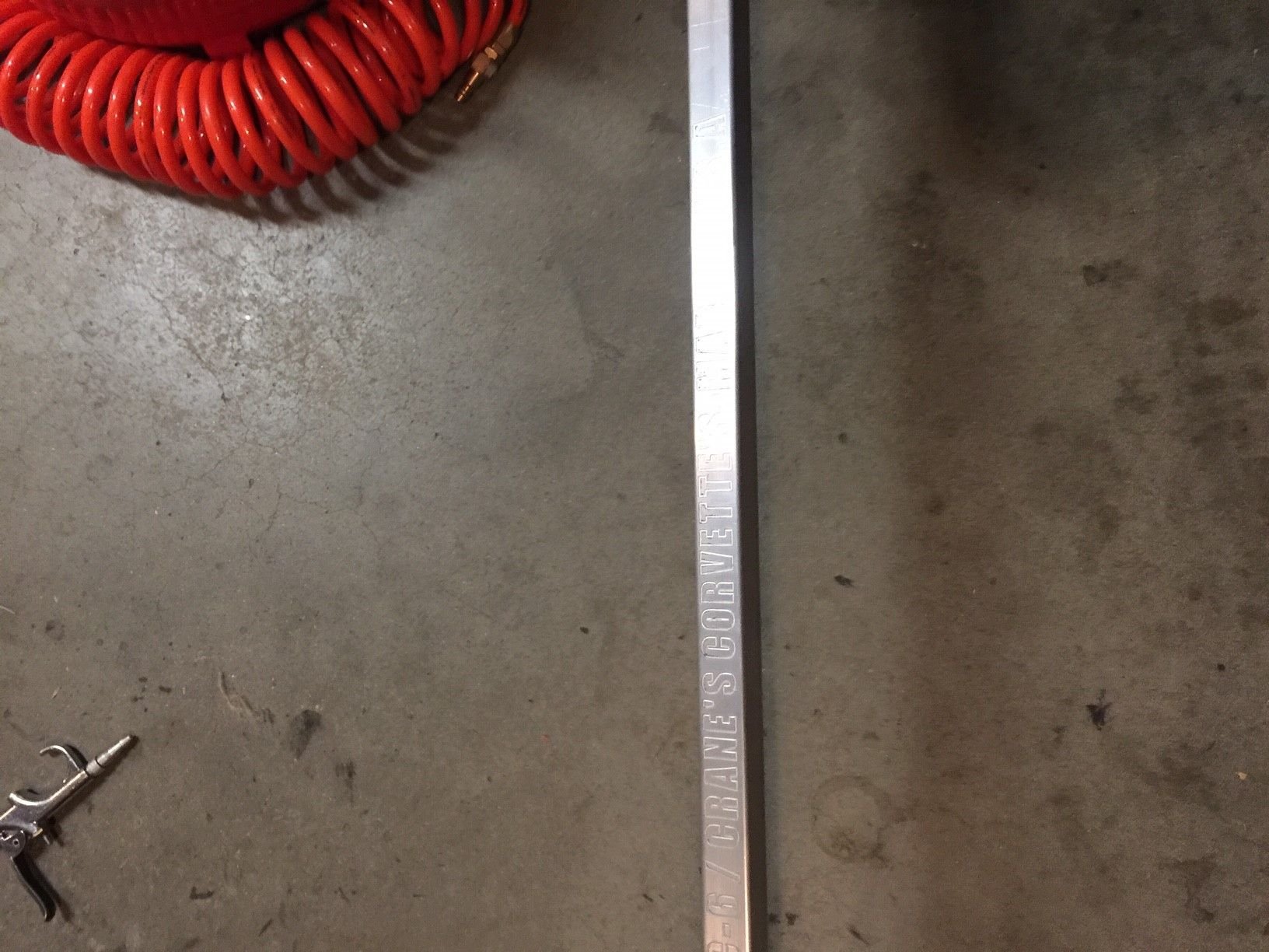

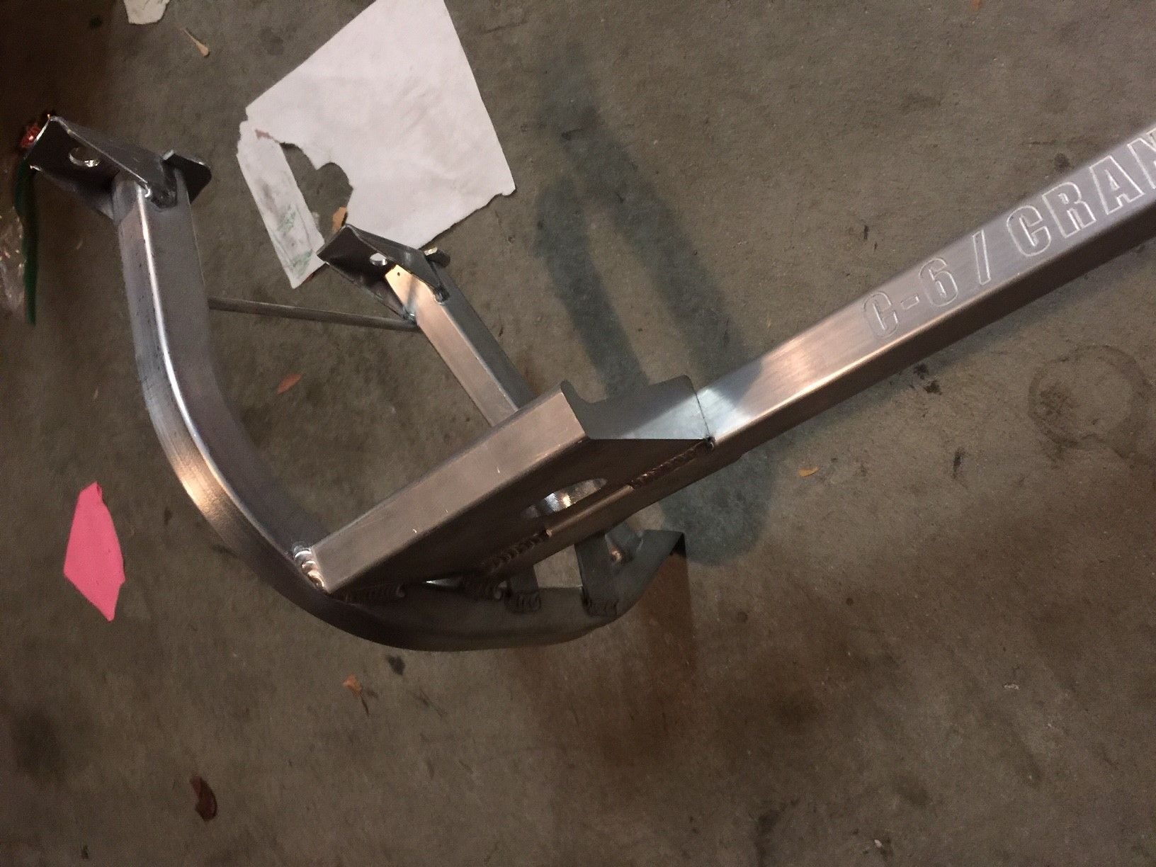

I purchased one from Dave, owner of Cranes Corvettes, in December and picked it up in person. I won't post his phone number here, but I can PM it to you if you like.
As you can see in the epics below, I further modified my support using Delrin rails for a skateboard so that the support now slides nicely over pavement and concrete. I used Delrin rather than steel or thick aluminum so that when the support hits pavement, it slides rather than drag (causing the support to be pulled down and under the car as it travels forward), and I am happy to report, it works exactly as I had planned. The rails are also replaceable @ $10/set which is pretty cheap insurance if you ask me.
I purchased my support unfinished and applied a baked on enamel finish (@ 400 deg for 15 min) so it looks like stock except for Dave's logo on the front, which I don't mind at all. Dave's product is much heavier than stock, but very sturdy so in my opinion, its worth the weight penalty. I've seen others on ebay and I can't speak for those, but I highly recommend Dave's product over stock.

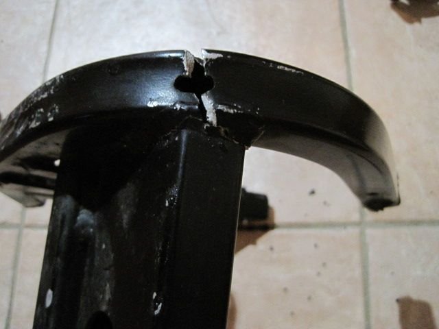

The damage shown below was not caused by bad parking habits. The welds at both flanges broke and the curved part also cracked. This was caused by a pothole. I imagine you do not have those in Phoenix.
