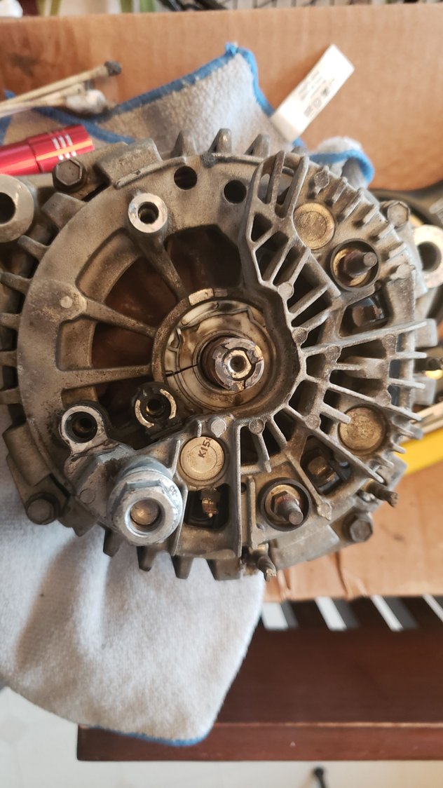

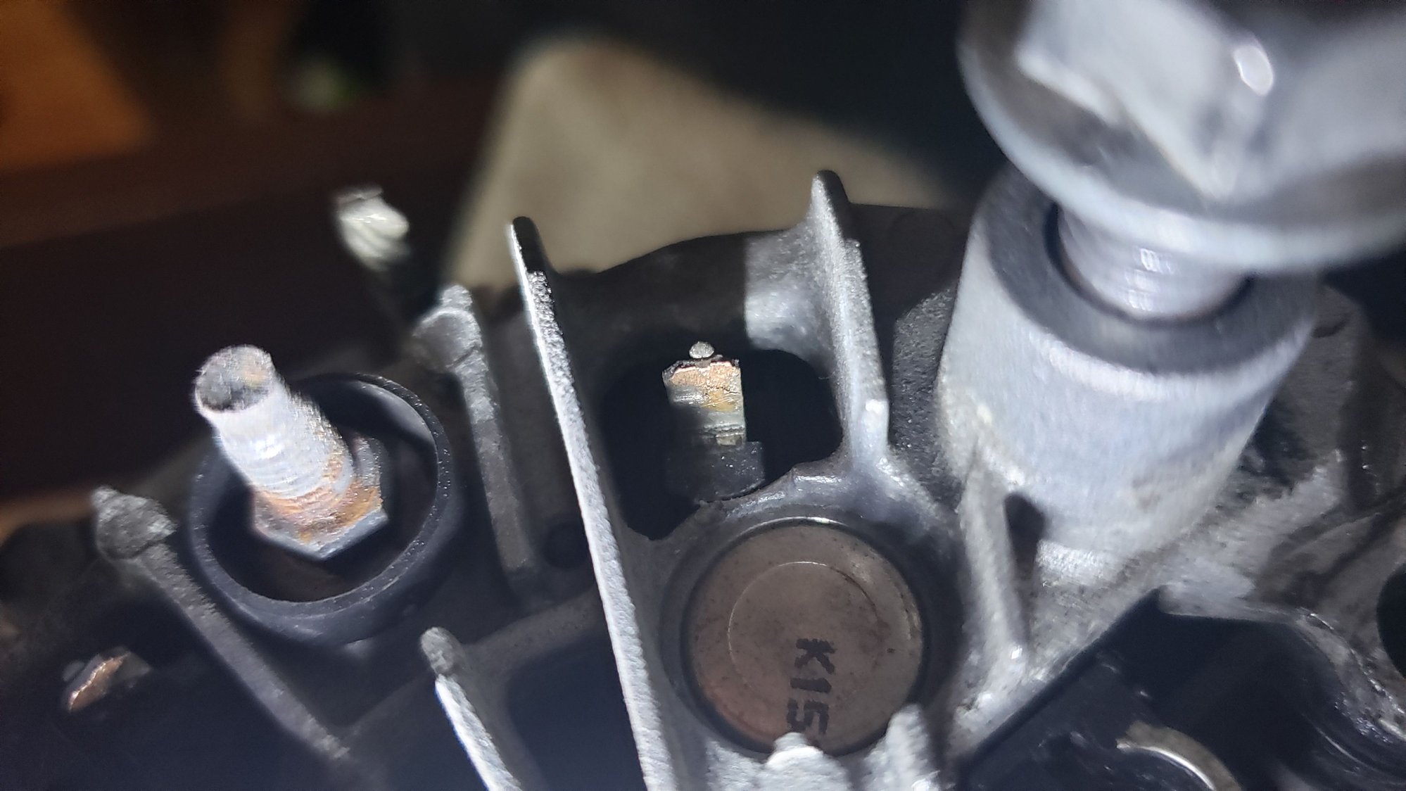

I am not very good with electrical stuff, but there are some obvious things I see. The center shaft bushing cracked and the electrical contacts looked corroded. Would appreciate some input on this and some knowledge if I should buy an alternator or have someone rebuild it.
Old Mar 14, 2020 | 10:14 AM
Dano523's Avatar
Dano523
Joined: Dec 2013
Posts: 12,502
Likes: 3,629
Slip rings look like they can still be cleaned up/still useable, Brushes look fine but would contact clean out the housing to make make sure they are not bind in the channels at higher RPM's.
As for the rest, basic cleaning with a little dielectric grease to make sure you have good connections across the board.
And if the coil winding plastic Cage was broken, would not be getting higher voltage even at lower RPM's. Same for bad grounding connection of the alternator to the bracket and motor.
https://www.corvetteforum.com/forums...nator-fix.html
