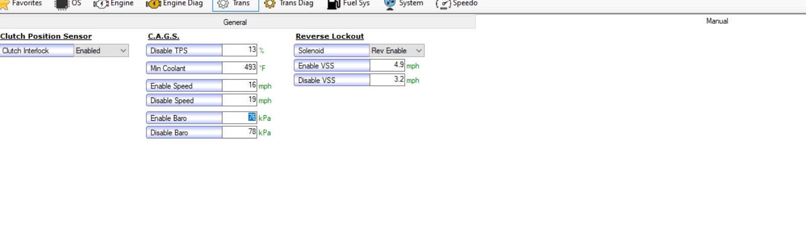

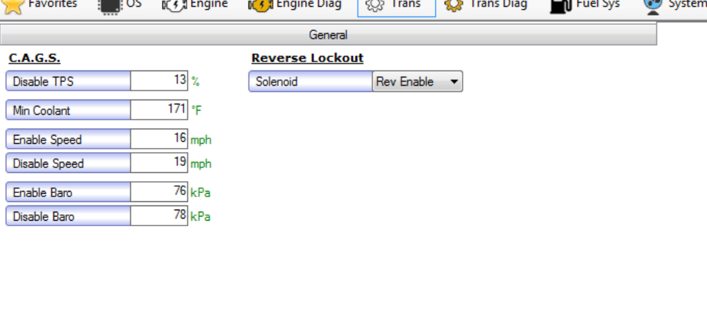

Most likely your tuner just did it while in the tune. I recently installed an A&A setup on a 2009 base model and tuned it. I tuned out CAGS while in as a courtesy.
There are a number of ways to accomplish, the most popular of which is maxing the ECT which I usually do. Any will work to completely eliminate CAGS as the new threshold could never be reached. I could also change enable speed. or baro too (or all of the above). They all have windows large enough in the tune table to never be accomplished in the real world (thanks GM). I am guessing, BC I can't see inside, but Diablosport is likely just doing the ECT via a menu driven SW.
Here are factory CAGS parameters on an E38, then followed by the one I just tuned.
BTW, it is not practical to access the tune just to tune out CAGS. Of the other ways, I don't like the fuse one albeit the easiest. The trans resistor is more reliable and more permanent.
