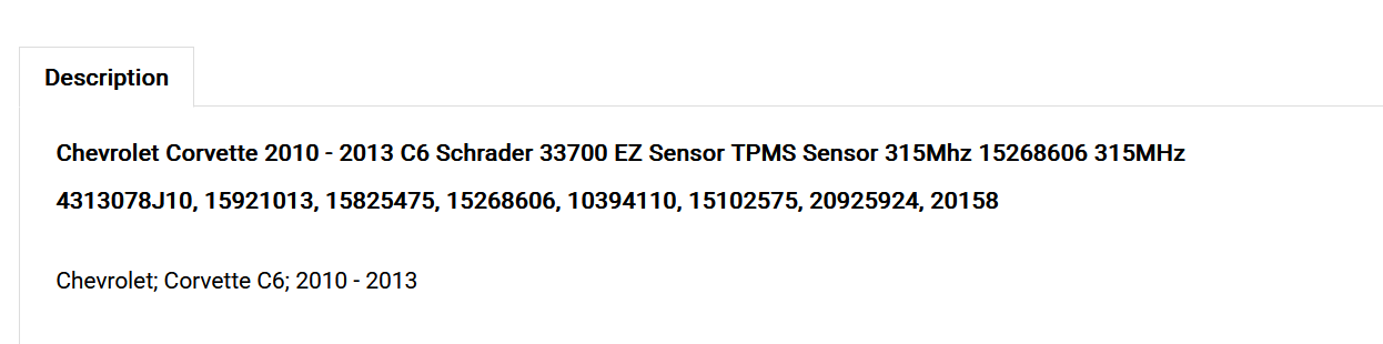

I went on TPMS.com and this is what came up for the 2013. A slightly different part # but they look identical and cross reference with the 15268606

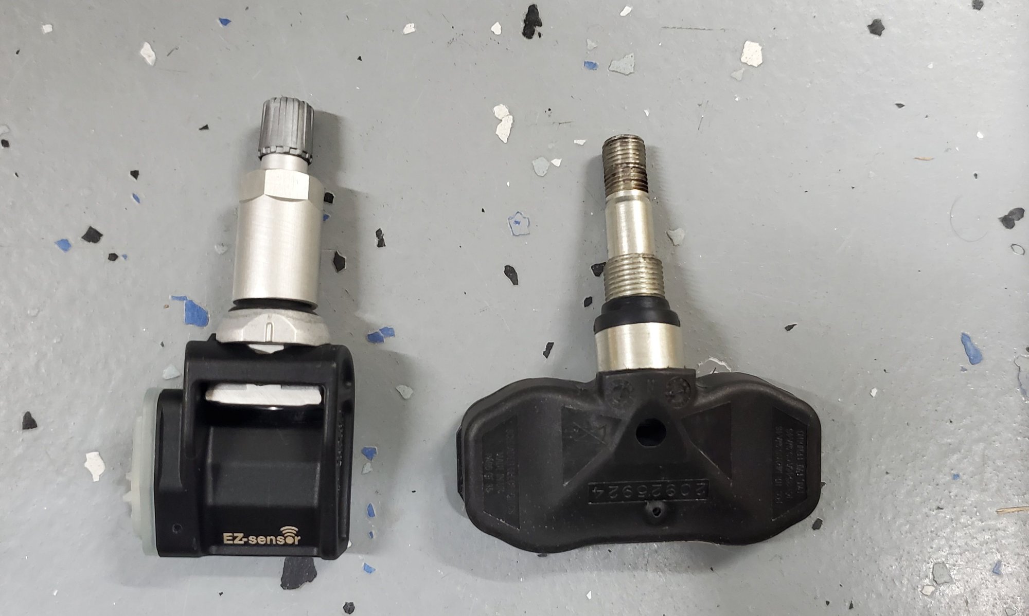

I got this on TPMS.com. It's a Schrader 33700 and comes pre-programmed for the 2013 Corvette. The new sensor is on the left, the old on the right. The OEM is Schrader but of course it appears different than the new Schrader. Hopefully it works well and doesn't cause any issues. Old one lasted almost 12 years.

I like it! Don't want my tires de-mounted and re-mounted any more than necessary!
