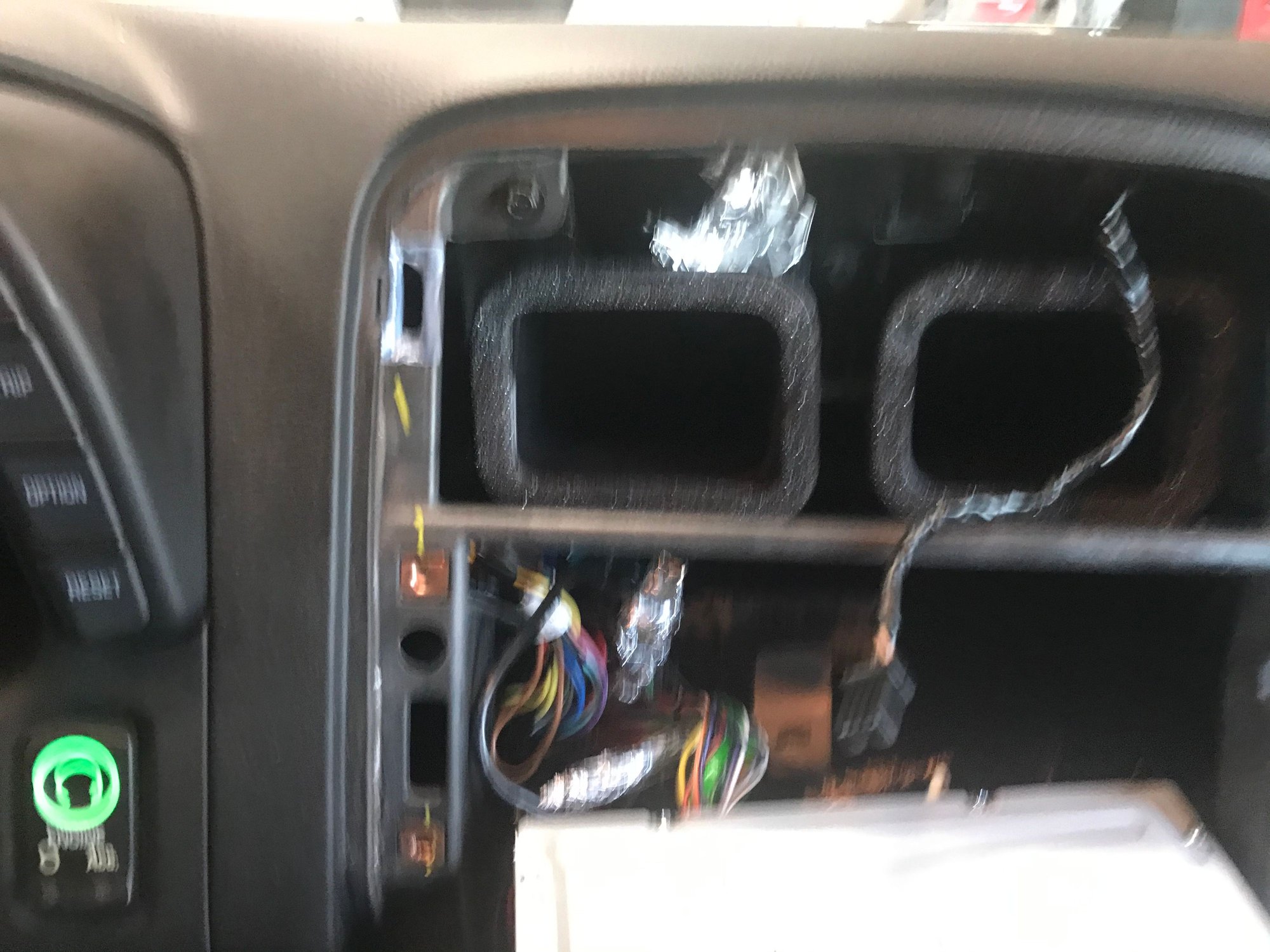

Yeah, I was including the 2 hours with the fuse out.
There is definitely more room towards the passenger side and I had to work to get everything packed tightly to get the head unit to fit with everything behind it.

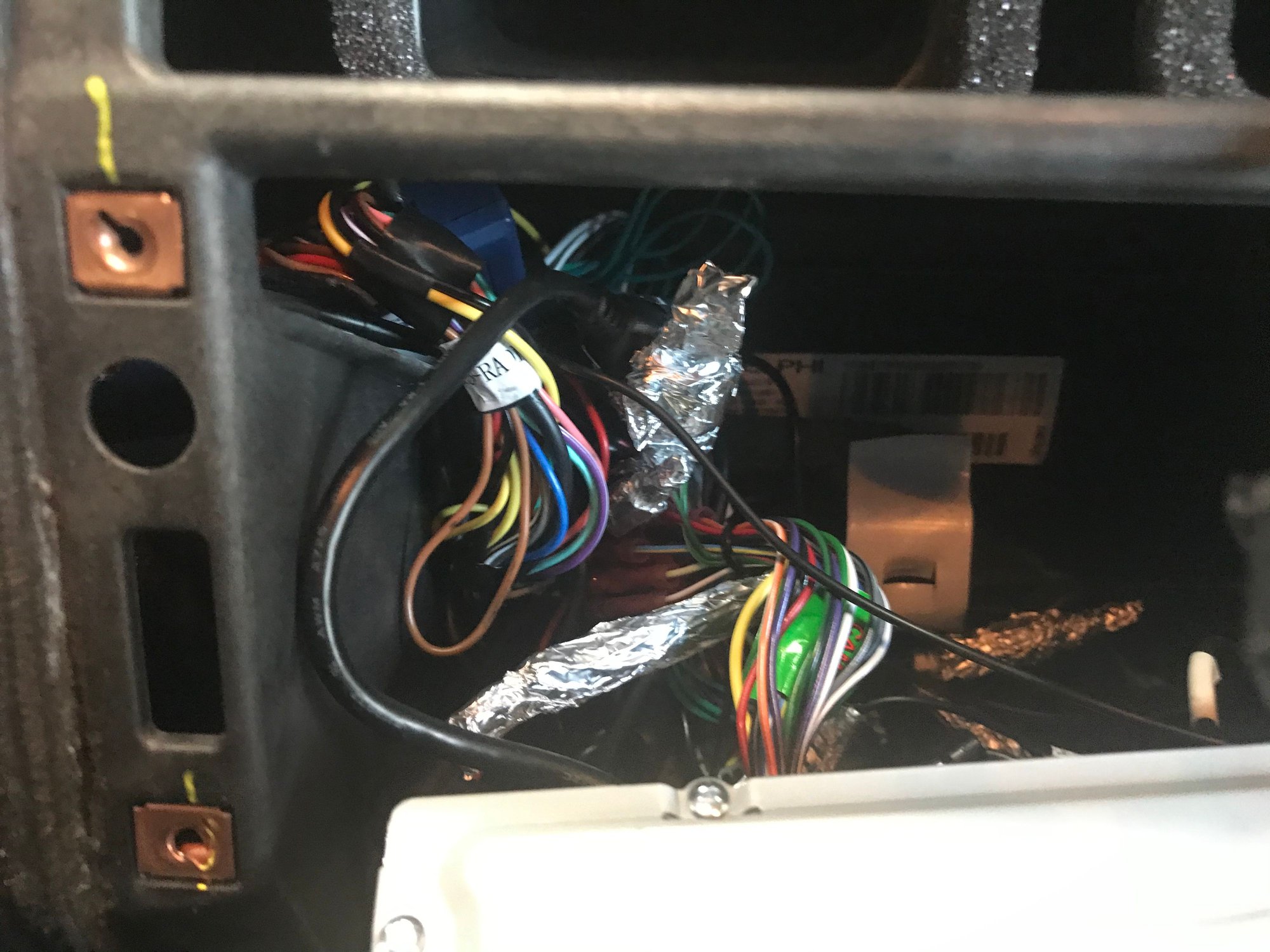

I only took a couple and the first is blurry
Upper is the shield for the GPS antenna. Nothing too technical, basically wrapped all the antenna connections, camera connections, and anything else hanging off the PAC harness that was unterminated.
