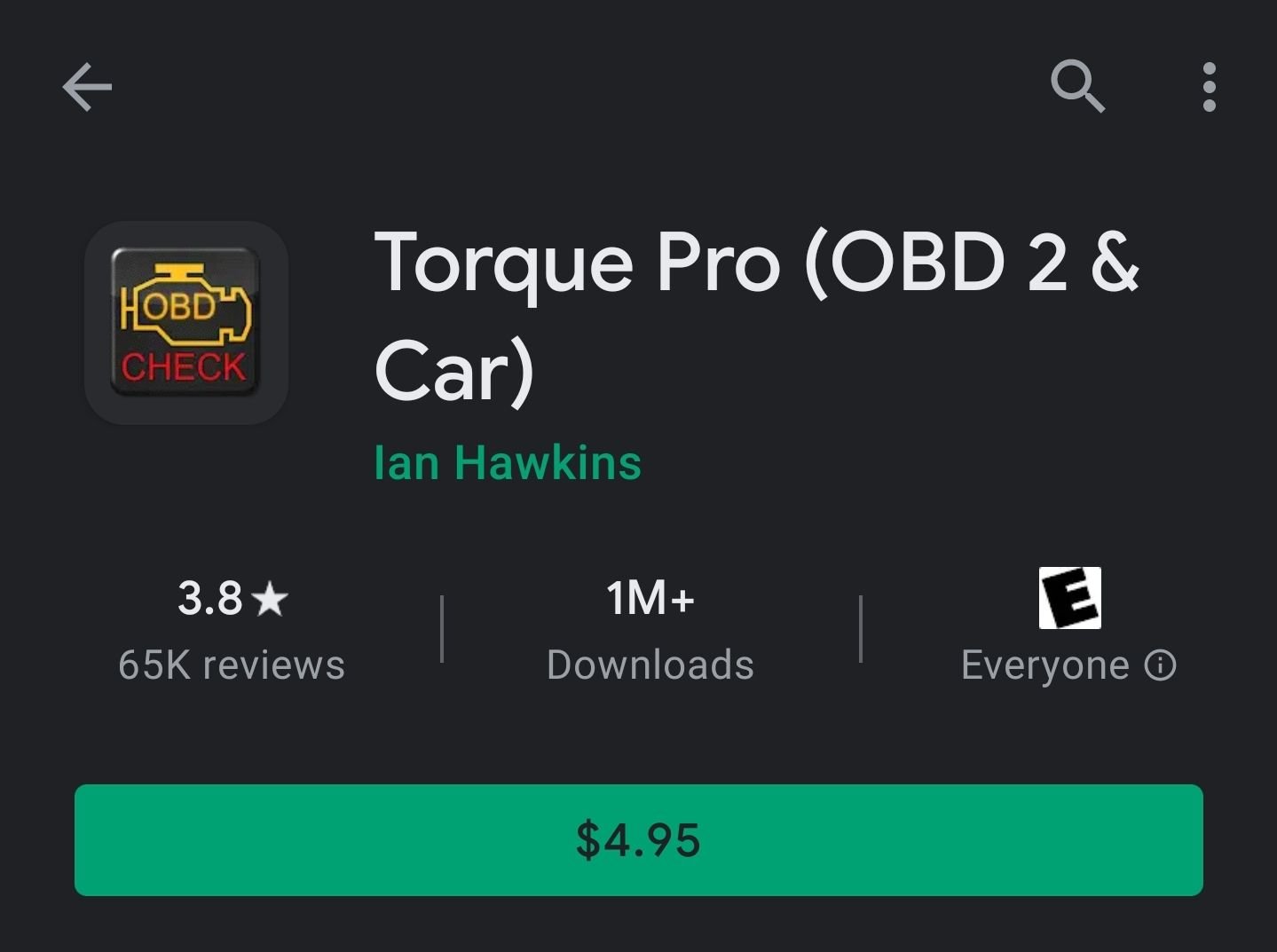

Speaking of the Torque App...Is this the one you are talking about? I've never used it. Are you saying that it will project on the head unit screen via Android Auto or otherwise? Also what OBD2 reader are you using?

Yes, that’s the one.
I have my head unit (Xmas present to me) but unfortunately it’s not installed yet.
The car is hibernating elsewhere for the winter.
The app can be installed on the head unit (android) and is displayed on the screen.
The head unit came with some accessories including the OBD2 thingy https://www.eonon.com/m-ProductShow....roductNo=V0056
