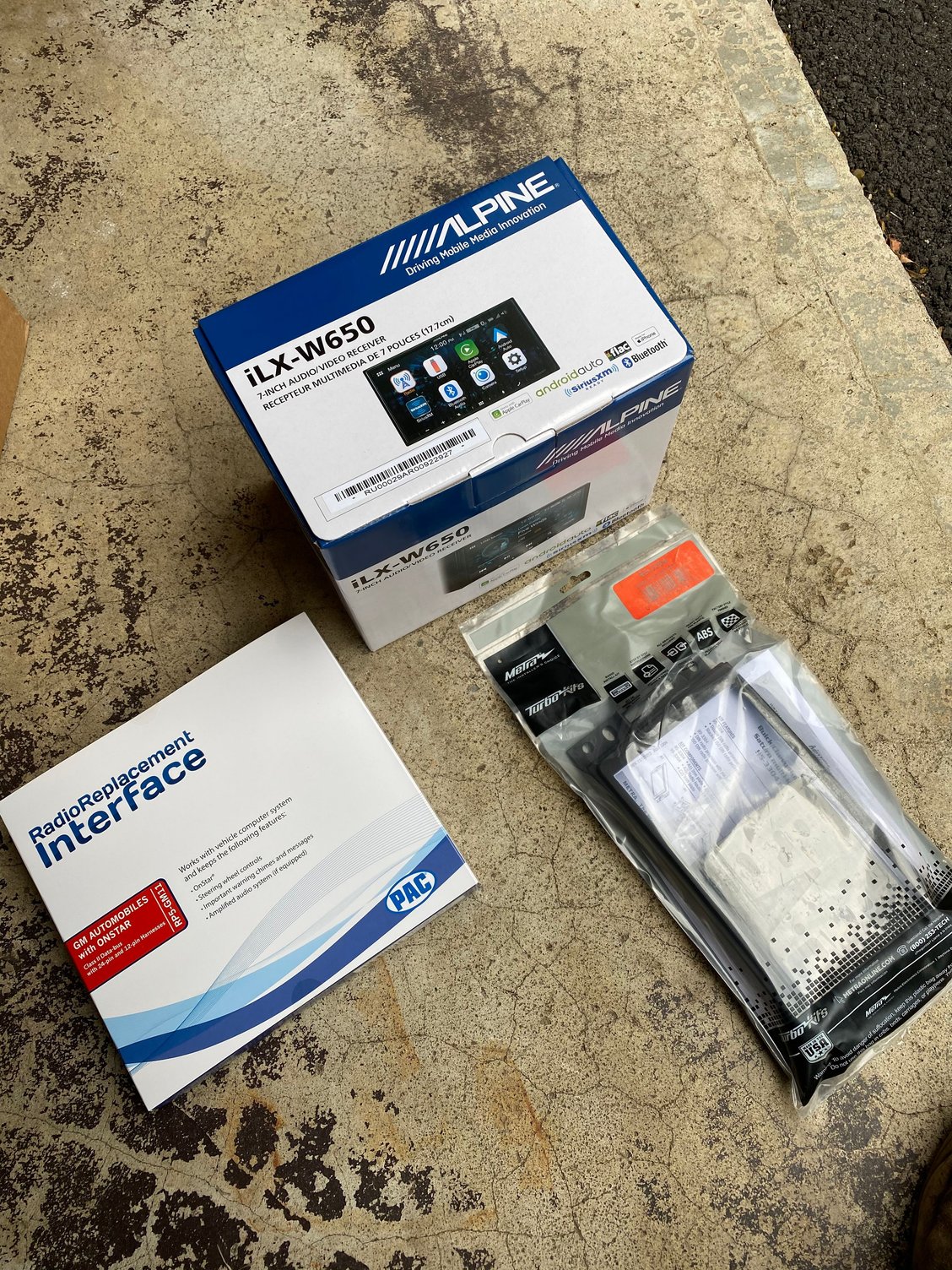

Awesome
Has all the bells and whistles you need , fits like OEM & wont break the bank from Crutchfield yes SWC also

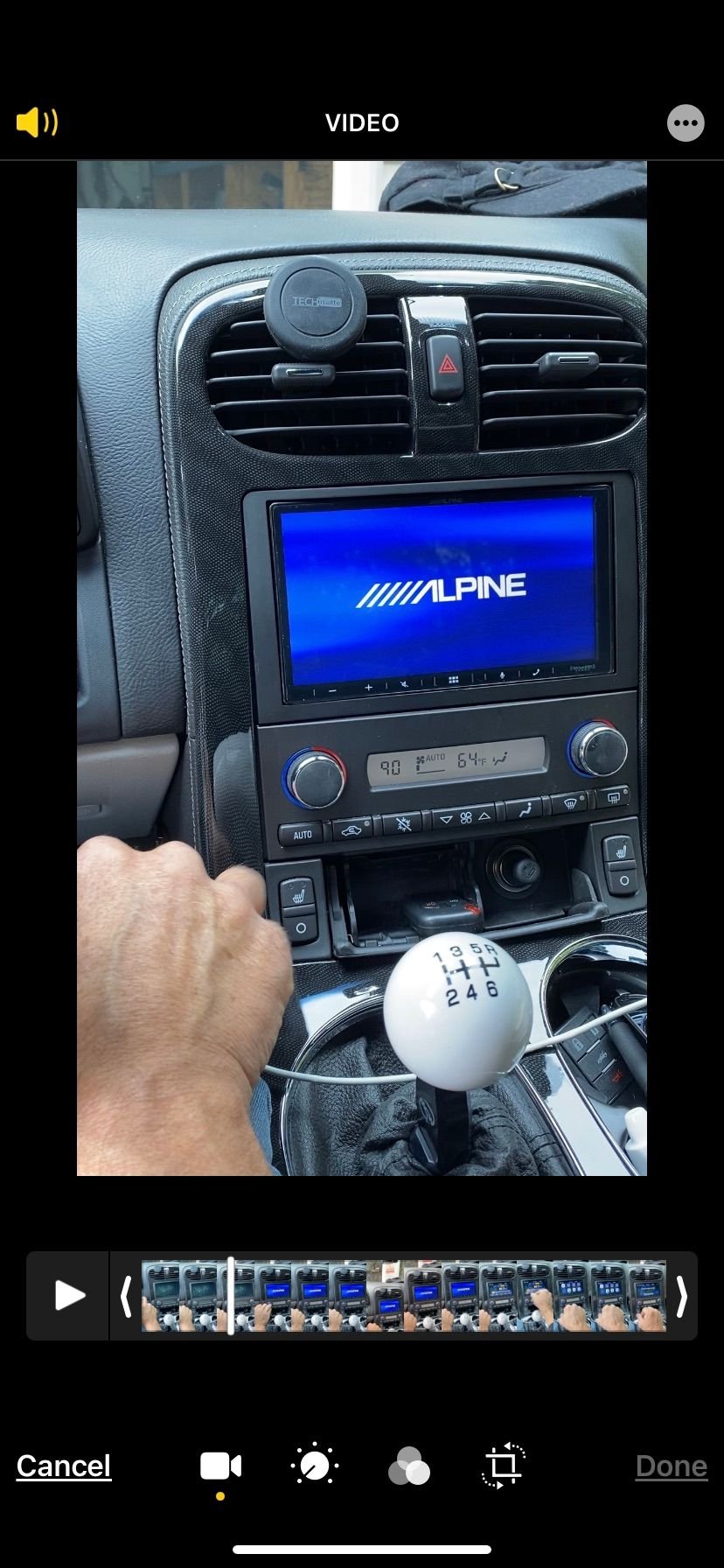

Exactly why I ALWAYS plan my route out on paper as well.
OP - NAV is not needed as you will have Waze and/or Maps to help you out there. I put this one in my 2012. I am VERY satisfied with it's performance and I have the base speakers. I would assume it would sound even better with your Bose speakers. When purchasing through Crutchfield get the prewire service as this will save you a lot of install time. You may have to call them to add it to your cart. It's only $25 but IMO it's well worth it.
