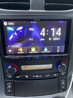

As the others said...one of the best mods to do is to change the head unit. I just did it the past few days. It took 2 days because I took my time. I did a lot of research and a preliminary overview on the whole thing. So I am not caught with any surprises. Went smoothly. Head unit and backup camera.

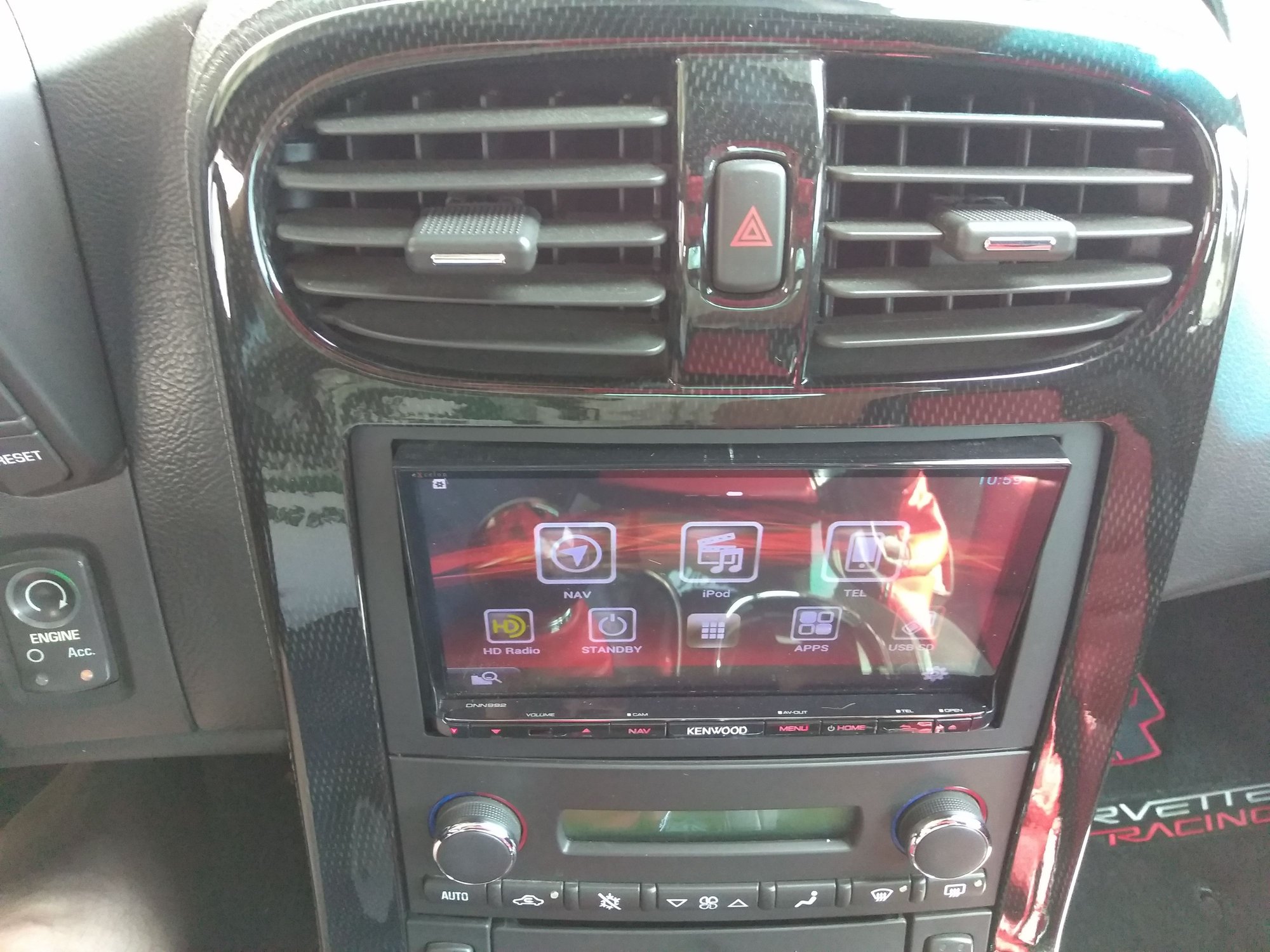

Kenwood Excelon DDX9907XR DVD/CD no GPS.
