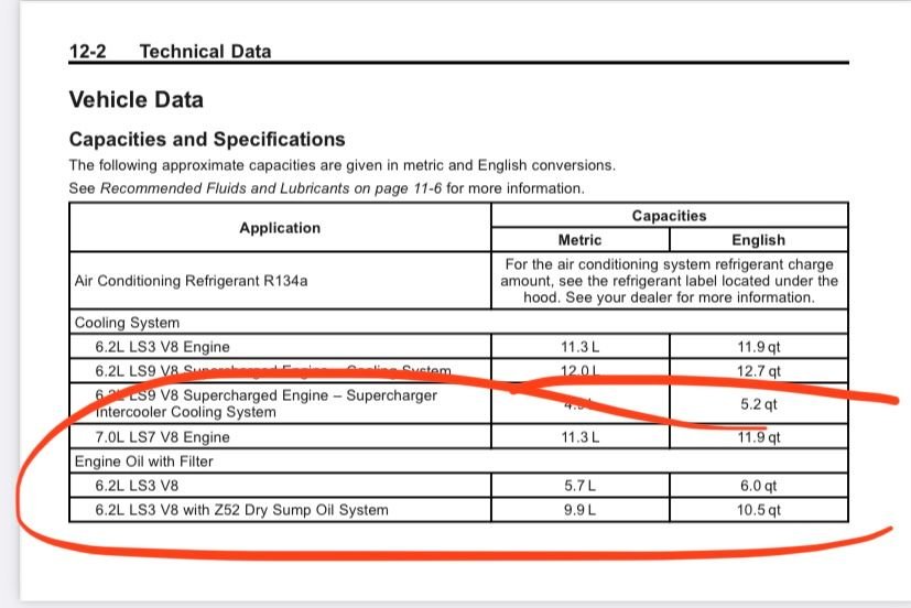

If you have this.....
....you have a dry sump. All GS coupes with manual transmissions have dry sumps. All automatics and all convertibles (auto or manual) are wet sump.

* For GS Manual Coupes only. As already stated, if the car is an automatic (as the OP said) he has a wet sump system and it’s 6 qts.
I’d also recommend reading the owner’s manual for the correct information, because as you can see from this thread alone it’s a crapshoot getting the right info on something so simple
