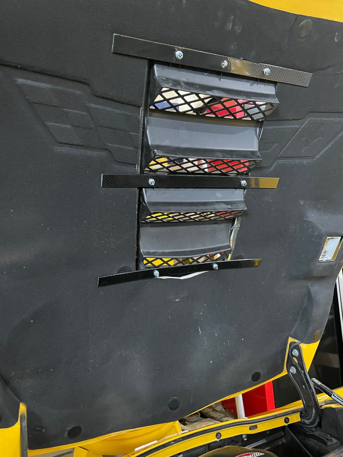

Here's the back side of mine, I re installed the hood liner. Measure like 100 times, went smooth as silk!

I wonder if it'll interfere with a Magnuson Heartbeat sc?

Looks great. Contrast with the yellow is spot in!
