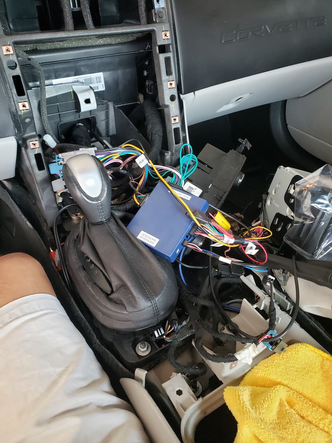

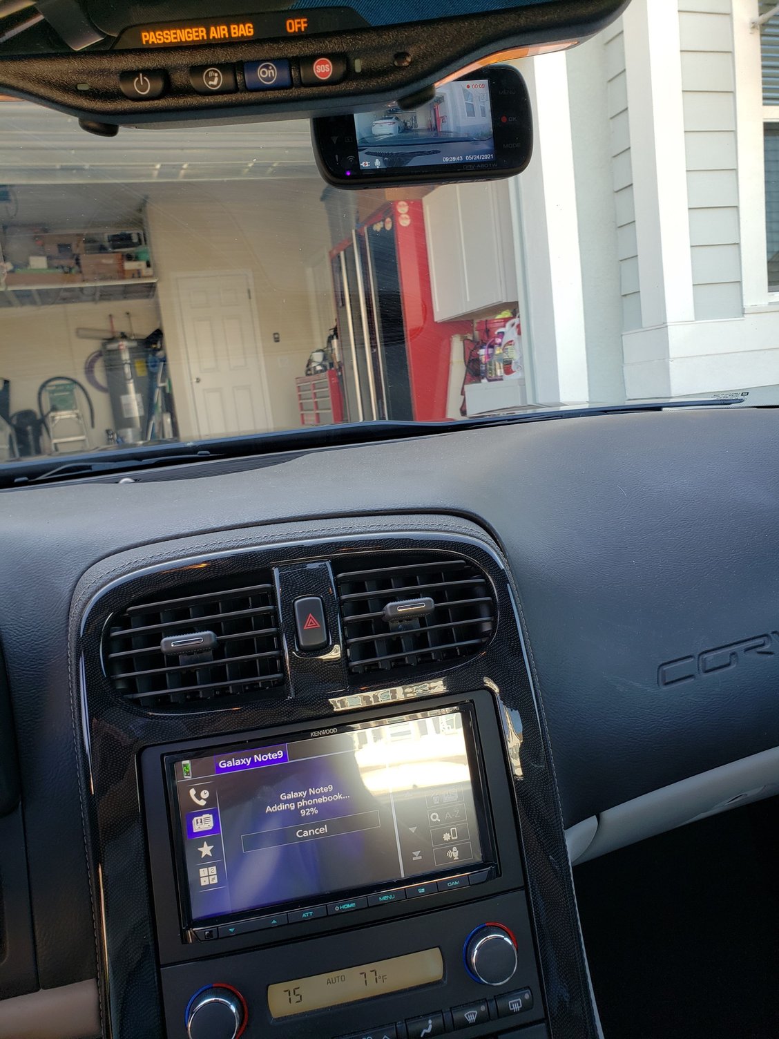

I did the install myself.. While I am pretty technical I still asked lots of question before I tackled it..I soldered my wires and I also put in a back up camera and dash cam.. The hardest part for me was running the wires for the rear camera... I got my HU from Bestbuy because crutchfield couldn't deliver. here are a couple of pics.. any questions just ask away..

I got lucky and picked up a HU from Crutchfield (lucky because they seem out of stock on lower to middle range units) it came with the sheet for C6s on removing center console and speakers. I’ll wait for the speakers for now.
overall it was a smooth process. Took me a little longer than planned but looks and sounds good. The only mistake I made (that I haven’t fixed yet) is I tired the rear camera to the brake power. Oops. Just haven’t gotten around to fixing it yet.
