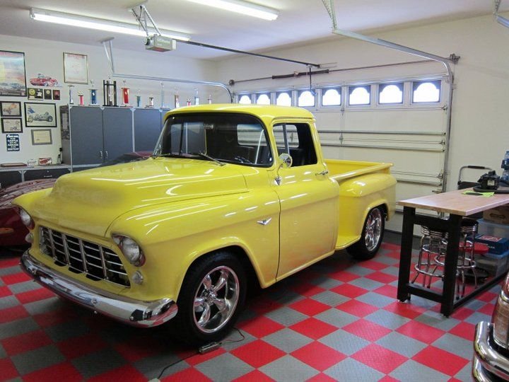

Yes, that is what I've been using on my Corvette's and 56 truck for the over 12 years now. Note the Ctek 3300 unit on the floor.
I have two of them that I have used on 4 different rides on and off.
