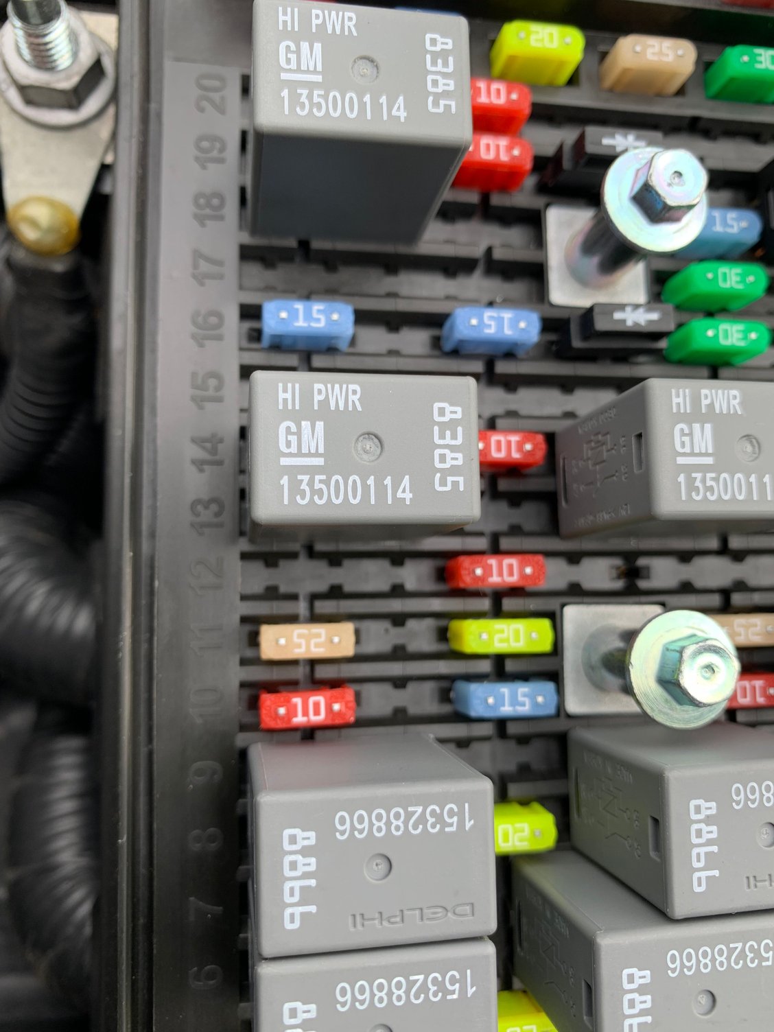

This is what I see in the fuse block. #13 is the GM #13500114 is that correct?
I don't think so. The fuse no. 13 in the picture is on the right side of the box. The fuse you're talking about is on the left side of the box. Look again at the picture I posted.
There are 2 of the fuses you're talking about that have that same number on them. The pic seems to indicate a small fuse.

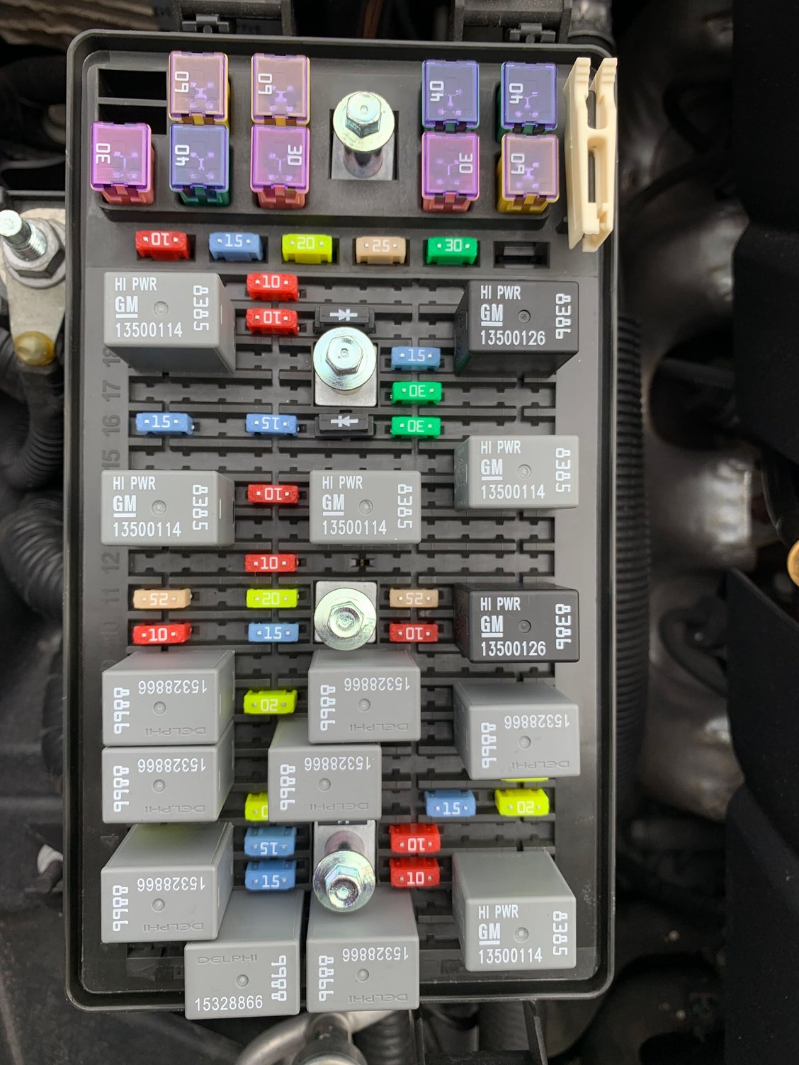

This is a better view of my fuse box. If you count the third mounting bolt down there are six fuses across. The 25 amp beige fuse next to the mounting bolt is the magnetic ride fuse (?). I pulled the fuse and visually looked at it and tested the continuity and it was OK. And just to be sure I changed it out with the spare 25 amp fuse in the top row. I also pulled and visually checked all the fuses in that row and all were OK. I've never abused my car with burn outs or hard riding since I've owned it! Took it out for a ride and there is no change in ride.
This is a better view of my fuse box. If you count the third mounting bolt down there are six fuses across. The 25 amp beige fuse next to the mounting bolt is the magnetic ride fuse (?). I pulled the fuse the visually looked at it and tested the continuity and it was OK. And just to be sure and changed it out with the spare 25 amp fuse in the top row. I also pulled and visually checked all the fuses in that row and all were OK. I've never abused my car with burn outs or hard riding since I've owned it! Took it out for a ride and there is no change in ride.
I think you got the right fuse.

There is a diagram on the fuse box cover. #13 is a 25 amp mini fuse labeled MRRTD (25A). Does MRRTD stand for magnetic rice control?
I suspect that it stands for "Magnetic Ride Real Time Damping".
