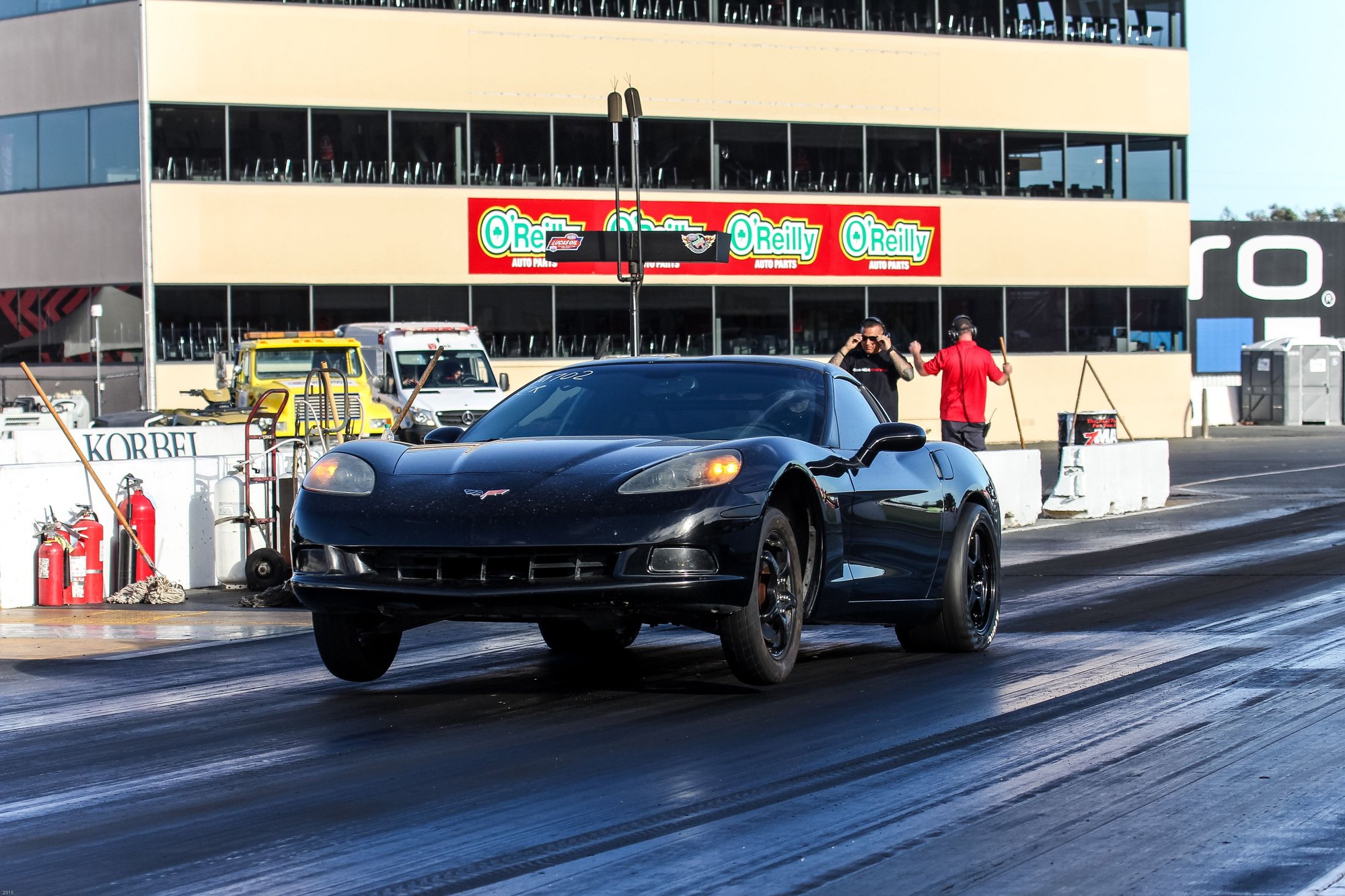

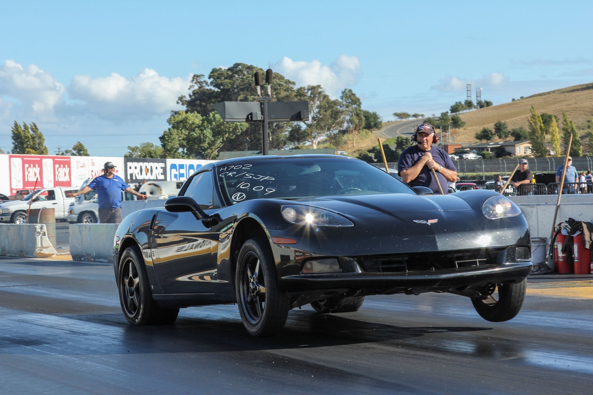

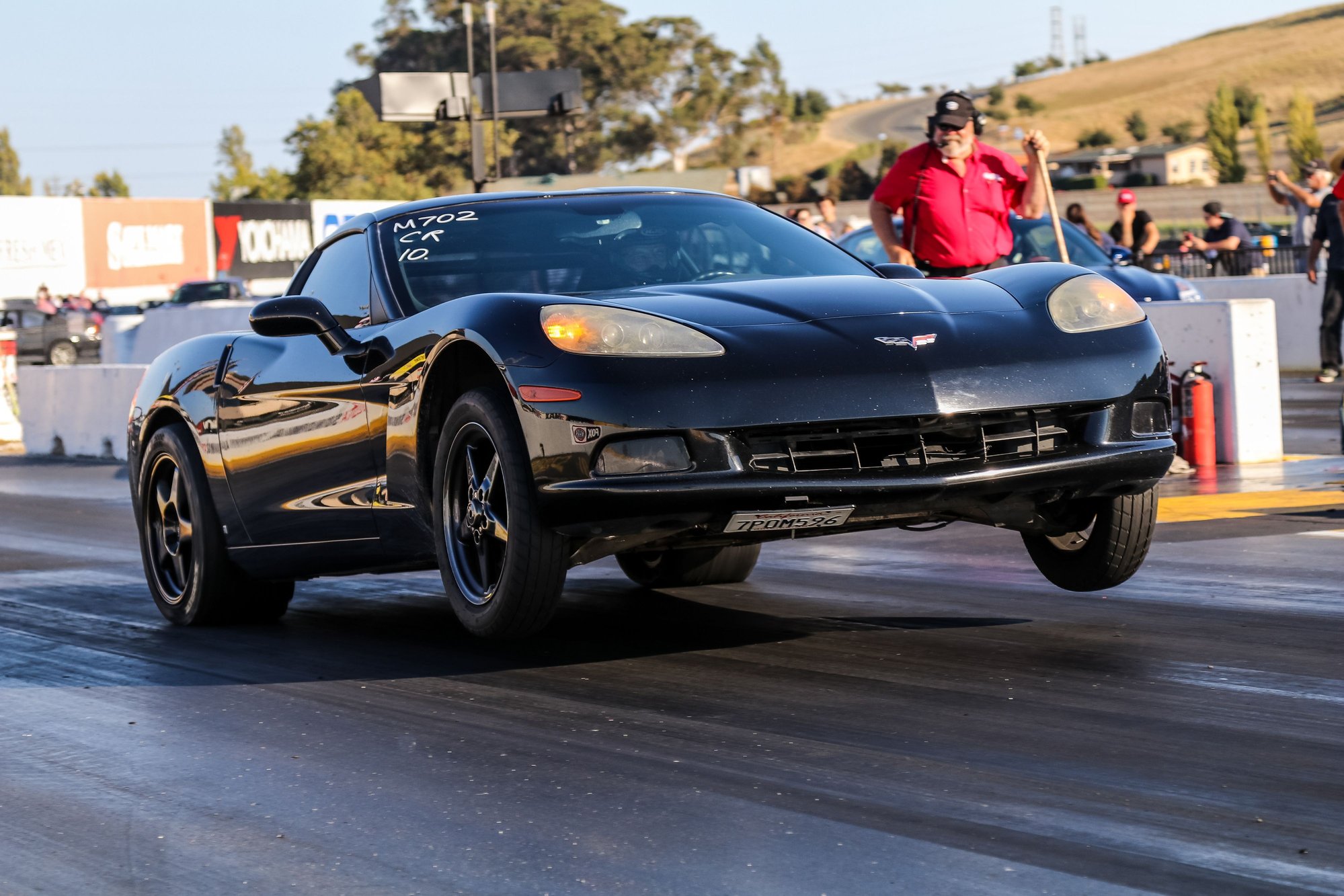

Yes, that's exactly what it'll do in both my race car and the Grand Sport. I need a pretty extensive burnout in the race car but with the Grand Sport I only needed to heat up the tires a bit.
Some action shots of the race car are shown below and if you zoom in you can see just how well they're able to hook as they wrinkle like a full slick. Again, this isn't directly applicable to the OP's car but does illustrate how important good traction is.

Wow, that car is hooking hard. I am not looking to do that. Just want it to get good launches and not wheel hop. If my local track would reopen Id buy drag radials in a heartbeat. I just do not have the ability to drive 2 1/2 hours each way to race on a regular basis. THANKS for your input.
