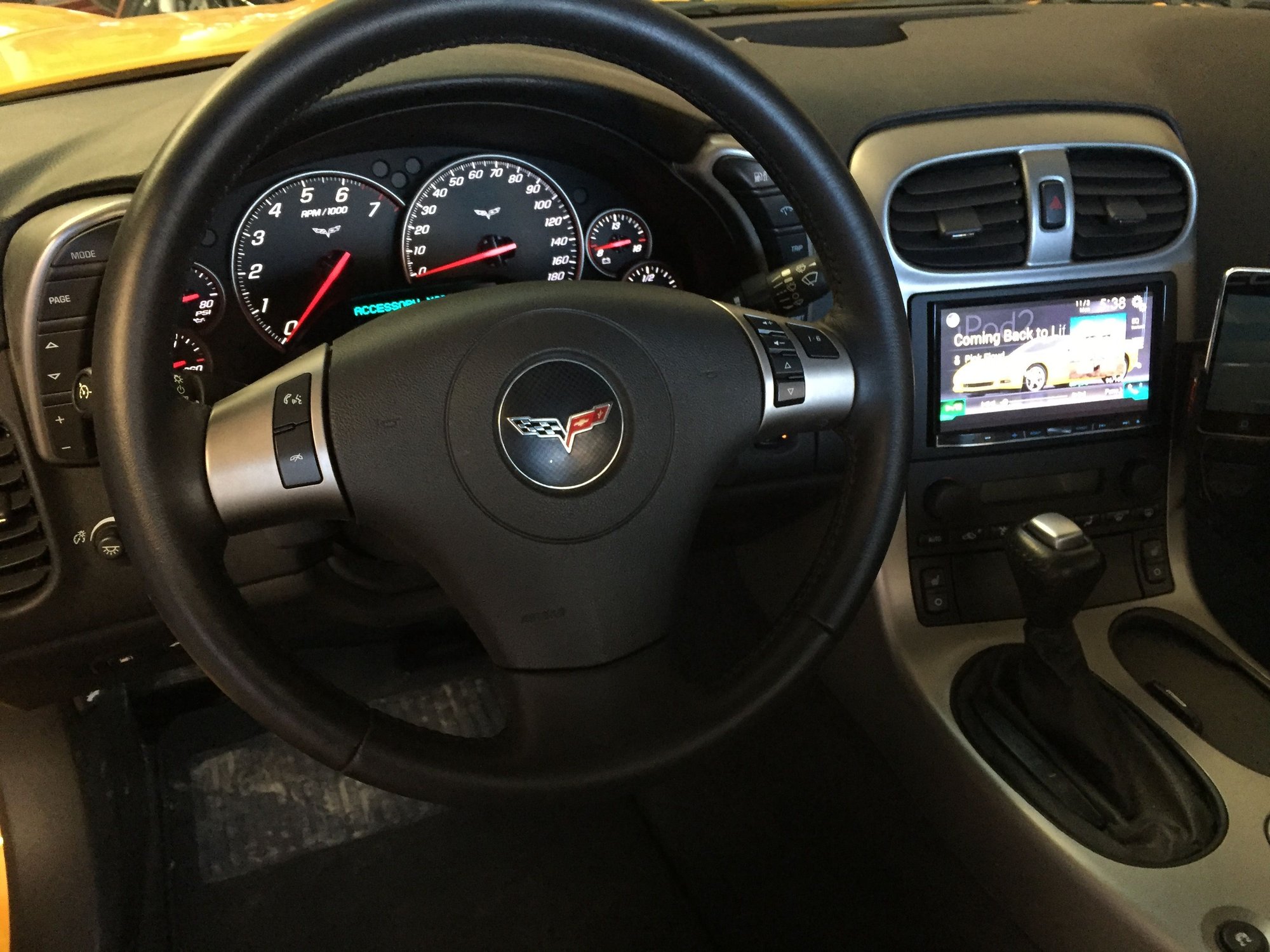

Nice system, I can send you some info on adding steering wheel controls to your 05 if you're interested, I added them to my 05 and they work great. You just have to get a newer steering wheel with the controls on them (I found a good used one for sale on this forum) then find a newer air bag (I found a used one on eBay) then get a new clock spring (I bought mine from a forum vendor) Then just run three new wires to the old stock head unit connector that the interface plugs into. Here's the old dough boy steering wheel on my car (note the remote control on the center console which is what I originally used to control the Pioneer before adding the new controls).
Then here's the new steering wheel with controls in my car which now controls my Pioneer system
