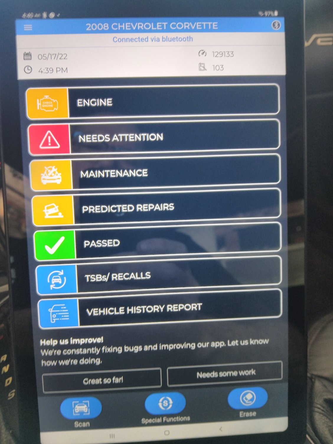

OK so I disconnected the battery last night to clear everything. I connected the battery today and started the car..... No codes
I took the car for a short ride and no codes while I was driving, the second time I hit the brakes I felt the pedal move a little and the these came up on the DIC in this order.
Service Anti-lock brakes.
Service Active Handling System.
Service Traction System.

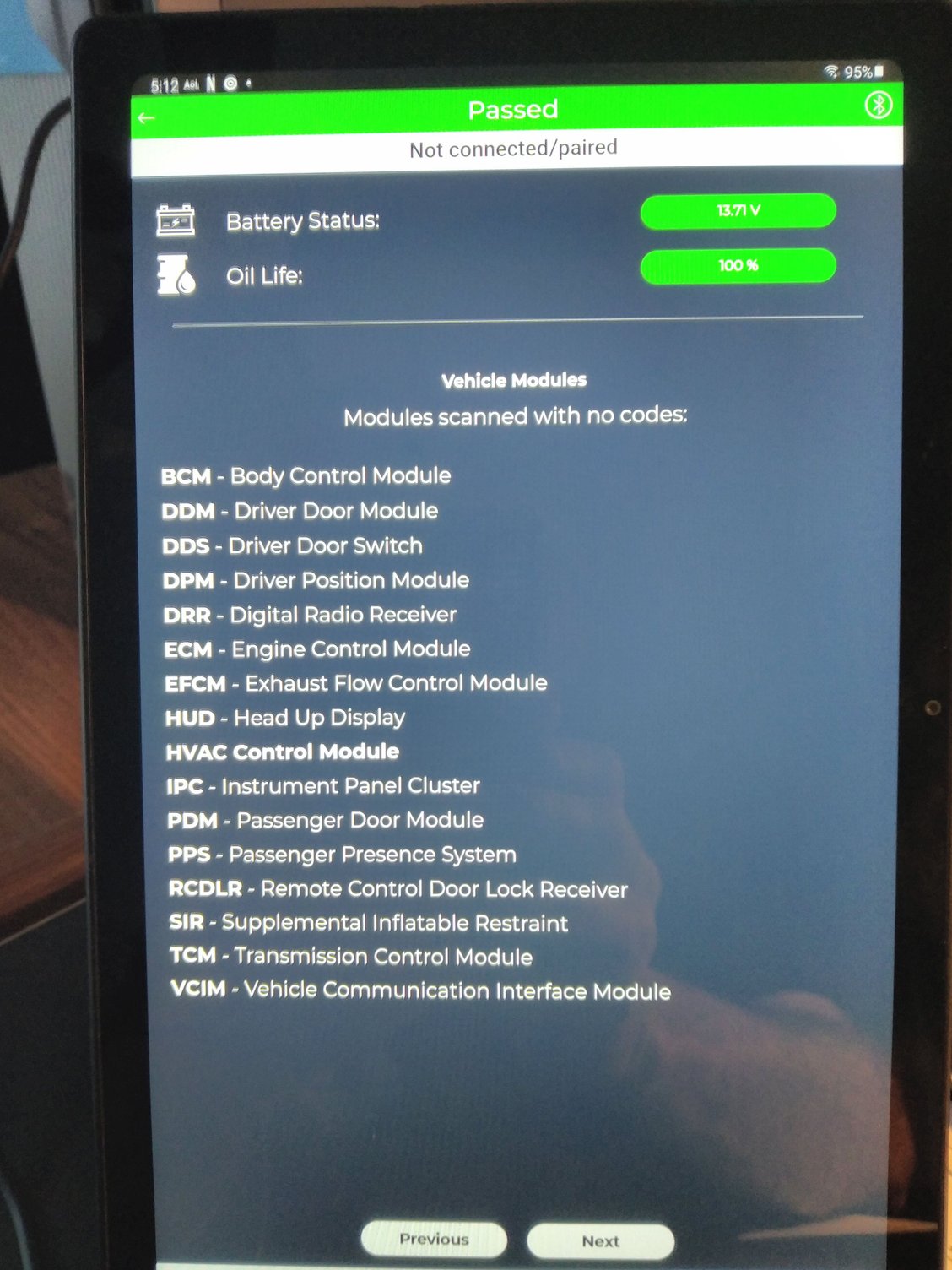

Here are 2 photos, 1st one is the software that I am using and the next are the fault codes (I believe) that cam up after the scan.

So now that I have these can you guys please help educate me.

I think all the other codes (bcm no com, left/right rear) are all historical data? I could be wrong in how I'm interpreting the results though. Someone with more knowledge on that particular scanner can chime in.
I think the BCM connections are under the passenger footwell so you may want to take a look at those and give it a good wiggle to see if its seated right. I think its rare that both L and R will go out at once so I'd guess it was accidentally disconnected, has intermittent connection, the BCM is bad, or there is some damage to the wiring loom from the rear to the BCM.

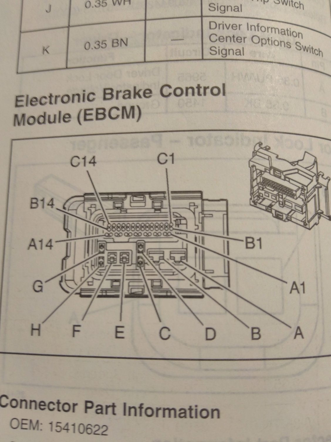

From what I read in the service manual If I disconnect the plug from the EBCM and have the car on jack stands with the car running in drive it should be about 8 mph. If I probe terminals A5 & A6 left rear and A7 & A8 right rear I should get the same ac voltage that I got from the rear hubs. That would tell me that the wires to the EBCM are in good working order. Does this sound right?

Looks like the rear wheels go first to the abs module? then somewhere else?
