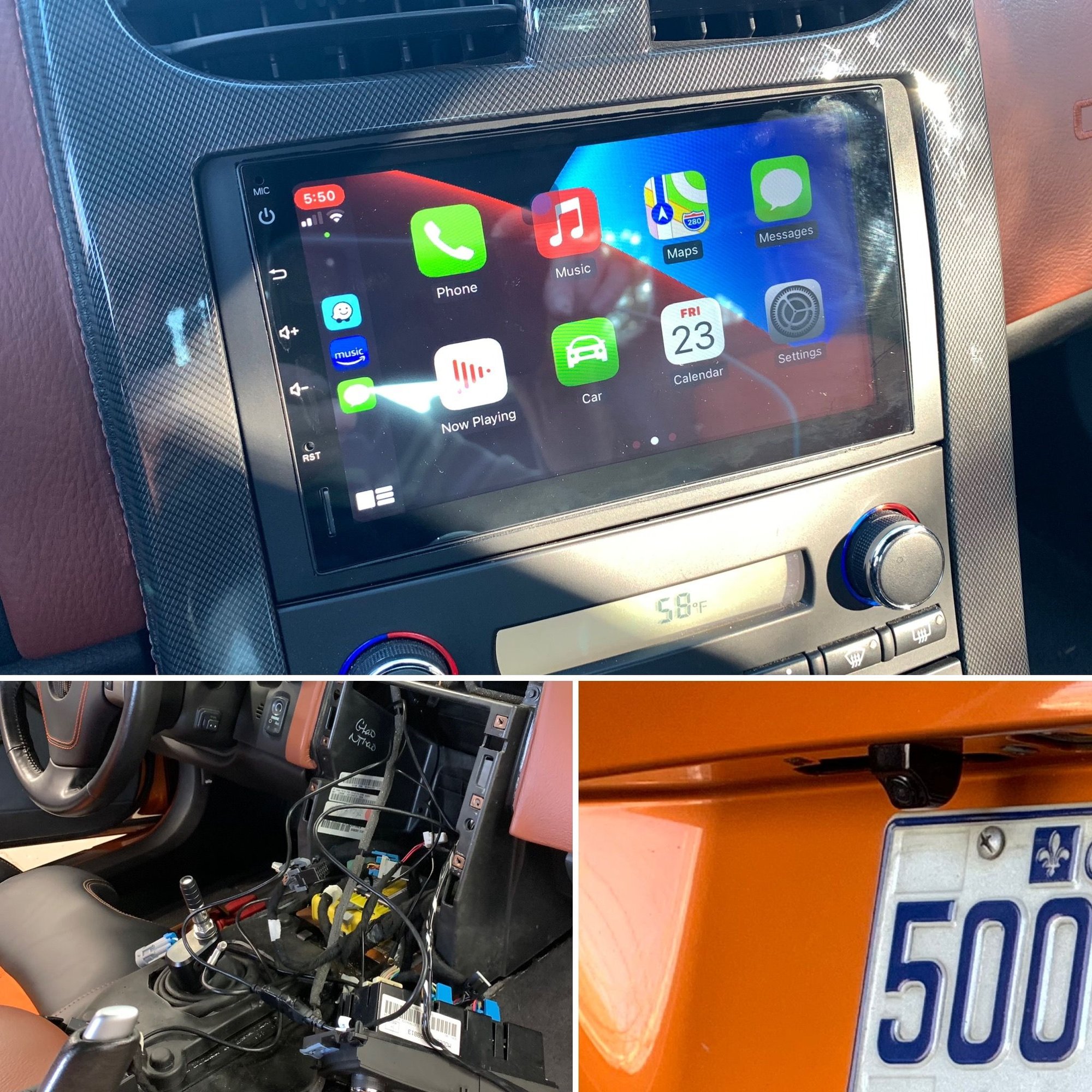

it's not even a consideration...I got a cheap 'Eonon' headunit to replace my 6 disc Bose NAV and have seamless car play with modern navigation, WAZE etc, backup cam, traffic cam, etc. Seamless.
Installation cost me $150. I wouldn't invest a dime or 10 minutes time on the OE type units. They are obsolete
Oh...and sound is much better too, although I prefer to listen to LS7 in this car ;-)
