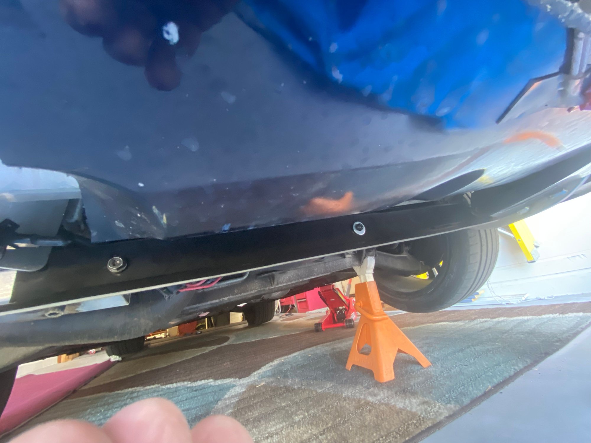

Default Air diverters to hopefully divert more air directly from the radiator.
Attached is the pic of the small air diverter I fabricated underneath the car. It is bolted to the lower radiator support. Also, today I just finished fabricating 2 additional "plates" attached to the plate that is part of the S/C application. (also attached). I did this to see if they will help "push" the air from the radiator fan in a more direct flow to the front of the engine. I will see later today if they help even more.
This is the air diverter that I fabricated to help move more air to the front of the radiator.
Today I fabricated 2 plates to possibly divert more air to the front of the engine. Obviously this plate is on the passenger side of the S/C
This added air diverter plate is on the drivers side of the air intake.
