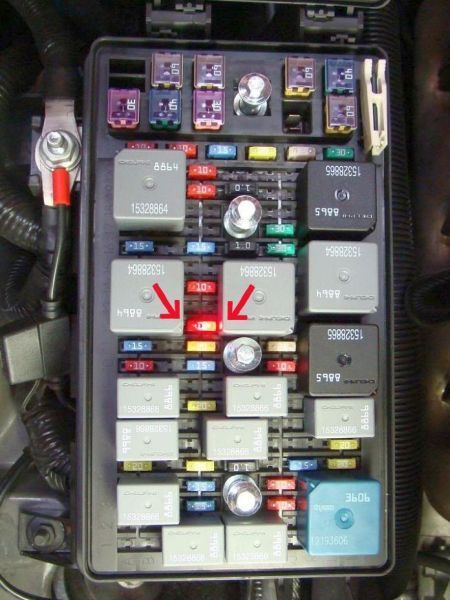

Here are some options: https://xse.com/leres/z06/cags.html
I blew a smart fuse with a motorcycle battery and that's been working for me for over a year with no issues.
I have 2 more that I blew using the same method as backups if the LED ever goes out. Super simple, easy to un-do, and no need to jack up the car.
I used this method 5 years ago, still works great.
