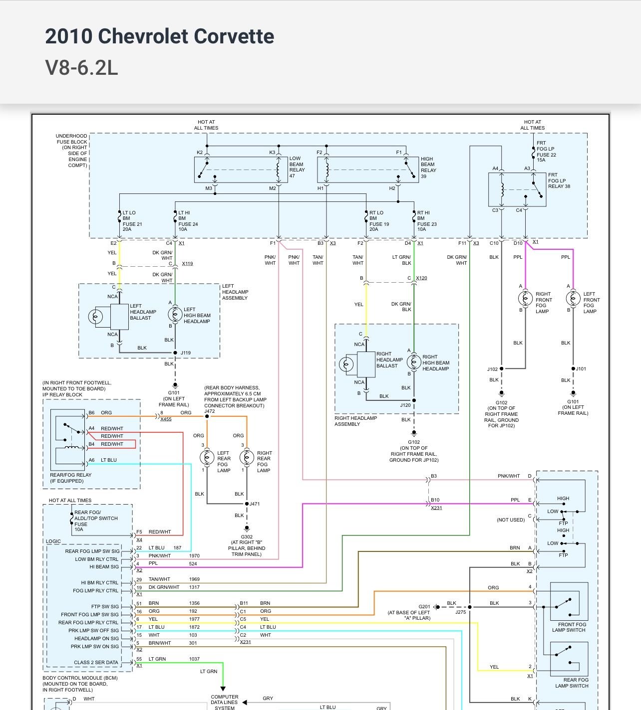

Headlights and Foglights are on 2 separate power and ground circuits…may be best to start a new post with your concern..you can’t go by it “appears good” !!…there was a TSB (Campaign) concerning this but only affected the low beams and not the fog lights.

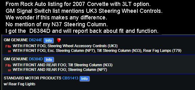

My 2007 with the 3LT package has the same problem as the OP.
I'm having trouble trying to find the correct switch. It has the N37 Steering Column (telescopic & tilt) and the UK3 Steering Wheel Controls.
Rock Auto offers them with or without Steering Column NP7. No mention of Steering Column N37.
Anyone know which switch is correct for the N37 Steering Column that comes with the 3LT package?
Update 3-11-2025
The Delco 6384D Turn Signal Switch fit perfectly with the "Tilt & Telescopic" steering column in my 2007 Corvette.
All the functions wok and the short that caused the bright headlights to come on when signaling, is GONE!
Steering Wheel Controls doesn't effect the multifunction switch. So, just choose the one for tilt steering.
