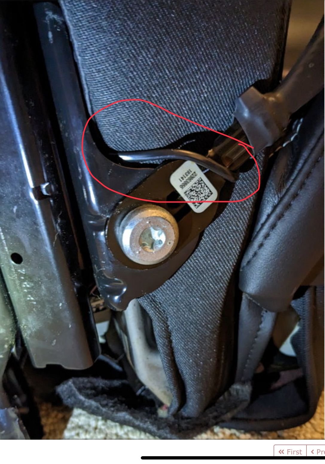

@C6_Prodigy Just got some GT C7Z seats and trying to get passed step one of removing seat belt buckle lol. I swear I’m equipped to handle this, lol. How do you disconnect the black wire on the C7 buckle? Am I missing a step here?
Old May 24, 2024 | 01:53 PM
C6_Prodigy's Avatar
C6_Prodigy
Joined: Sep 2022
Posts: 851
Likes: 390
It's not easy but if you dig around in the side of the seat you can find the plug and disconnect it. Once it's disconnected it will pull out. It's very tight but doable. Depending on the positioning of the seat, it may be easier/harder. Depends how far forward the seat is on the track as well as how far folded over the seat back is. I had no problem on the driver's side but found the passenger side very difficult. Sounds like that may be what you are coming across.

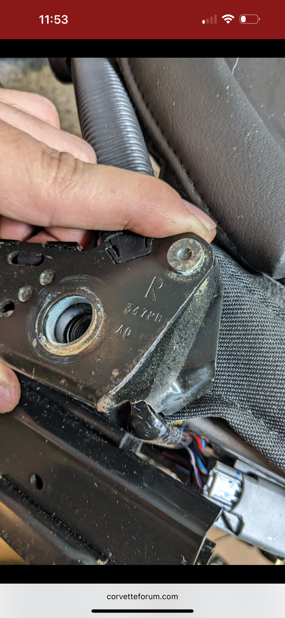

How did you get that bolt head off that uses the 13/16 socket?
Old Jun 20, 2024 | 12:17 AM
C6_Prodigy's Avatar
C6_Prodigy
Joined: Sep 2022
Posts: 851
Likes: 390
If I remember correctly it's a very shallow nut and I know I had to use a 3/8" impact gun on it.
Old Jun 20, 2024 | 05:24 AM
Chillwill_g007's Avatar
Chillwill_g007
Joined: May 2017
Posts: 150
Likes: 6
From: Michigan
I understand that and I got the pretensioner off the seat. But I still have to remove the shallow nut off the pretensioner cause in the picture you show when installing it back on the c7 seat. The shallow nut is not on there..
Old Jun 20, 2024 | 09:09 AM
Tim90NOS's Avatar
Tim90NOS
Joined: Sep 2021
Posts: 176
Likes: 58
From: Long Island, NY
You can pop or press that "nut" out of the pretensioner from the other side, it's more like a hollow bolt that goes through the pretensioner. It doesn't need to be drilled out.

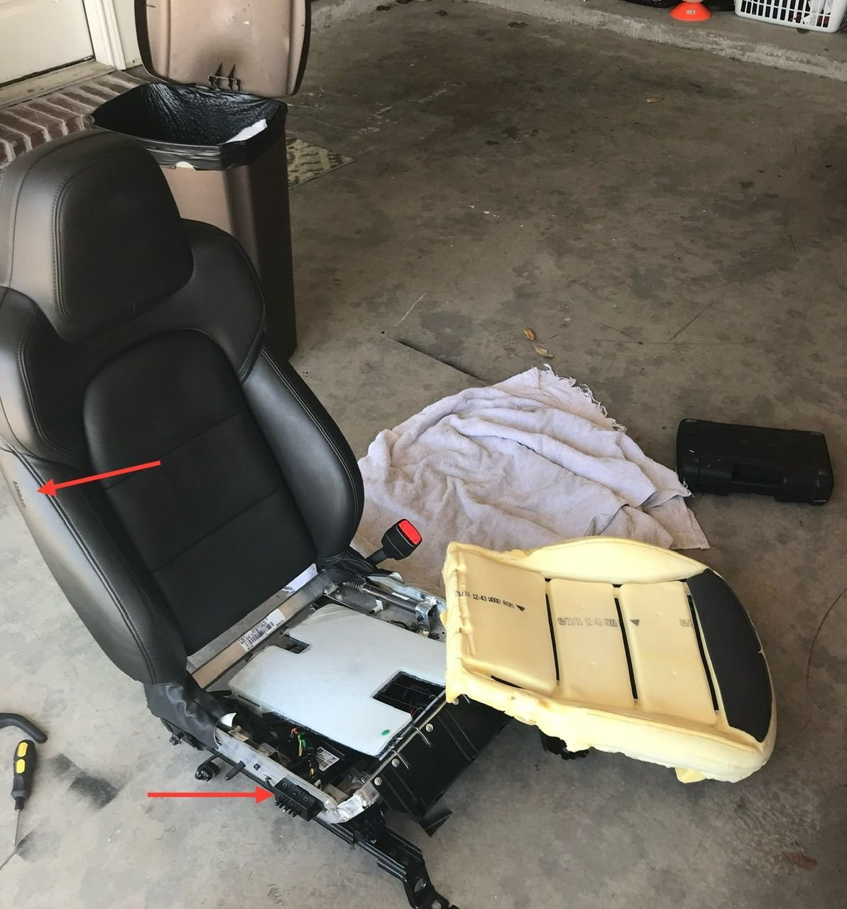

I followed this thread very specifically but didnt have the results you had. After about 20 minutes of drive time my car throws the airbag light. Code B0092. If i unroll the occupancy bladder, the light will go away and it will reports a passed condition. Ive tried this 3 times now, each time slighty changing the location of the bladder or how tight the zip ties are. Each time i have the same results. I can only clear the code from the scanner if the car has already removed the light itself. I have the bladder tucked in the back of the seat, and the sensor under the seat above the plastic seat framing.
Anyone have any sugguestions or input on what i possibly have done wrong?
Old Apr 21, 2025 | 02:08 PM
  #40
Tim90NOS's Avatar
Tim90NOS
Joined: Sep 2021
Posts: 176
Likes: 58
I moved the C6 bladder over to my C8 seats and it works as designed. I lifted up the cushion and put it in a similar area, ran the hose out one of the holes on the bottom seat pan. Been working fine for 2 years this way.... worth a try
