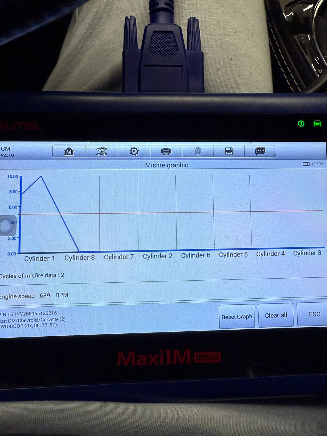

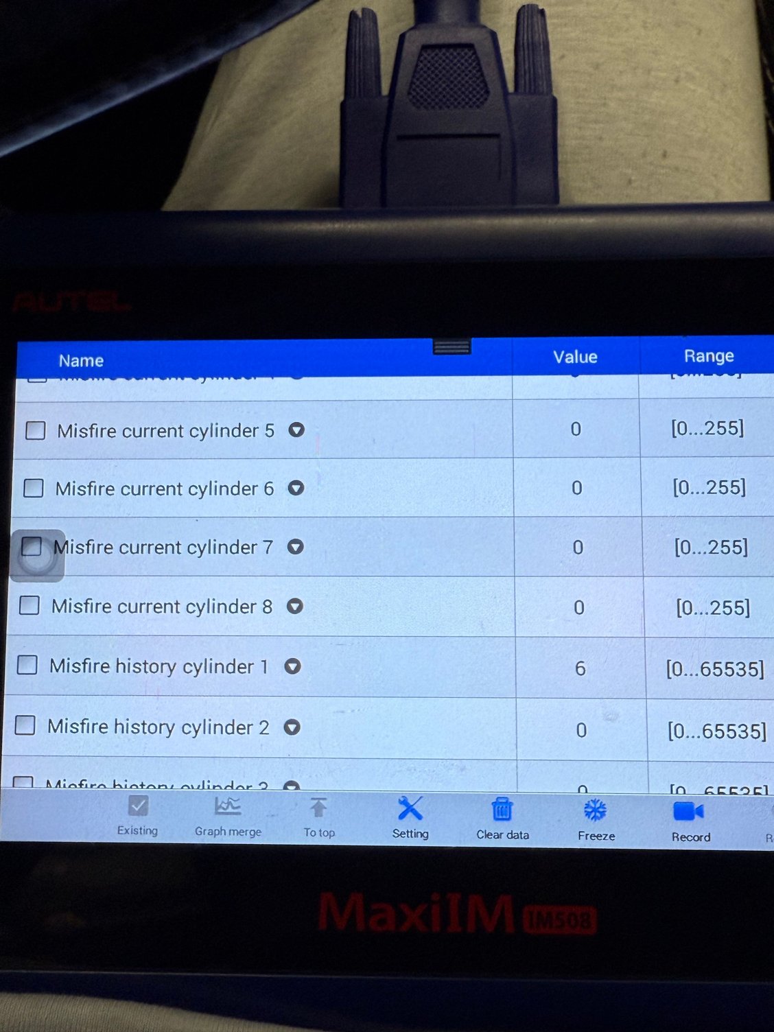

From: Florida

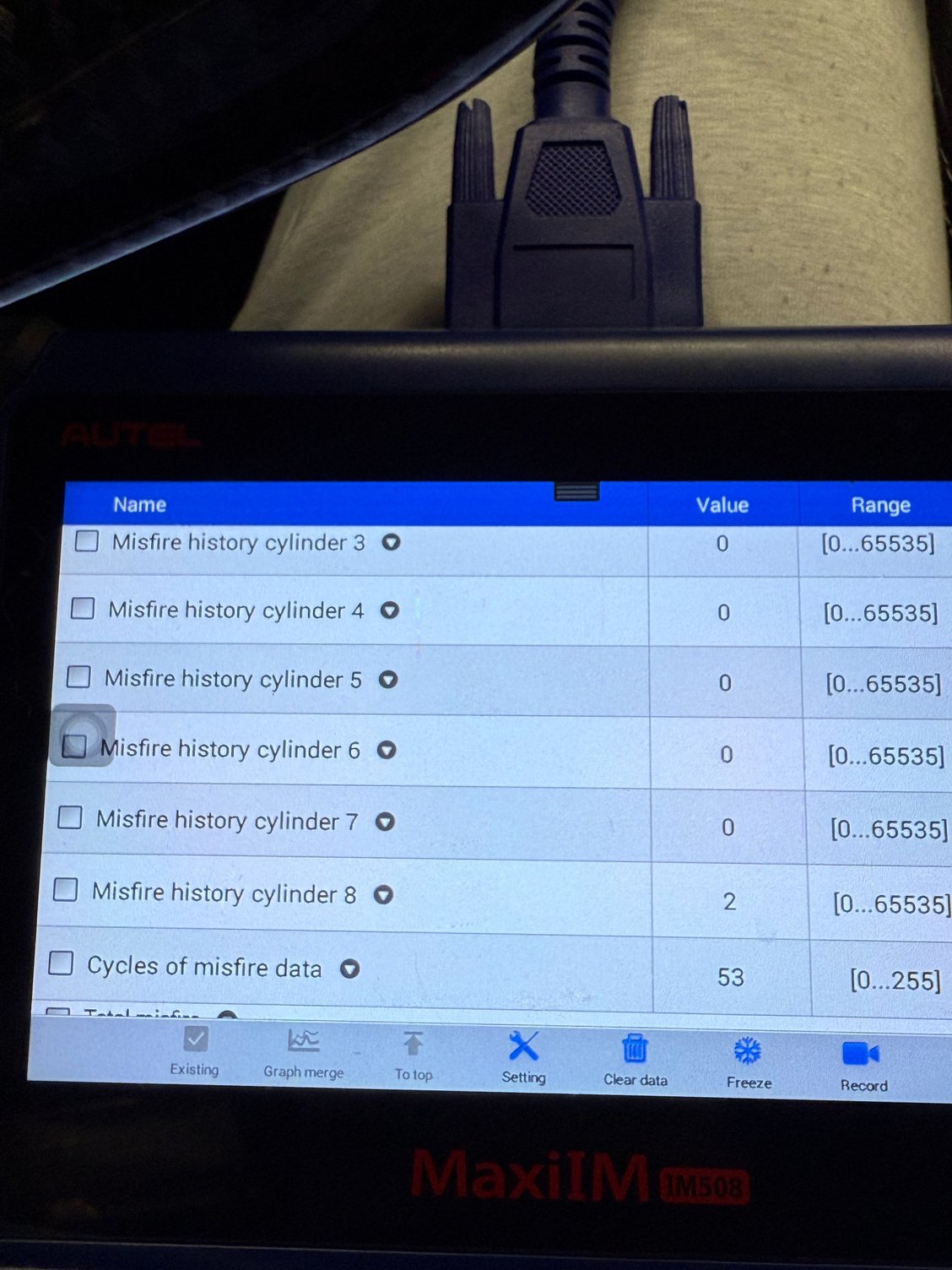

Not sure what these values mean

Looks like cylinder #1 is your misfiring cylinder…hope you haven’t been driving around for 4 months with a misfire.

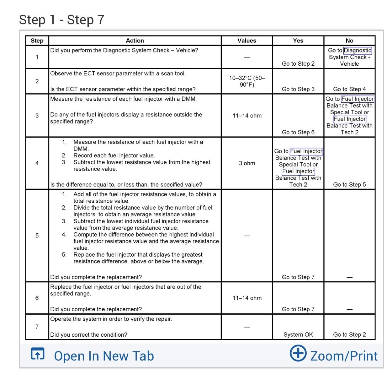

You will need a fuel pressure gauge and a factory level scan too to perform an injector balance test or with an injector “pulser” which you can buy on Amazon…you should also check the resistance across the injector looking for 11-14 ohms…read the procedure below.

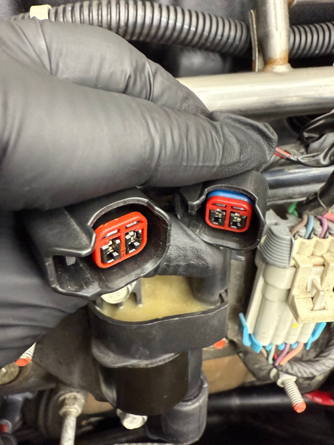

Just noticed the cylinder 1 injector clip is missing a washer , could that’s cause an issue , where can I get this washer?
To Check engine light help

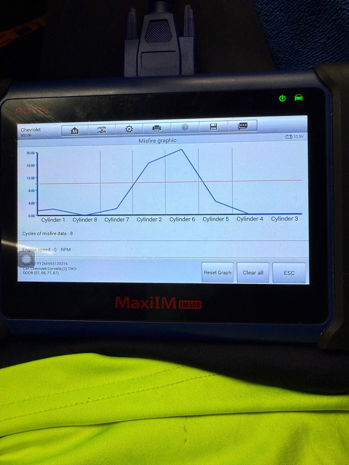

Old Jul 3, 2025 | 04:47 PM

So misfires on 2 and 6 ??

From: Florida
Car warmed up and the misfires went away lol idk what’s going on
