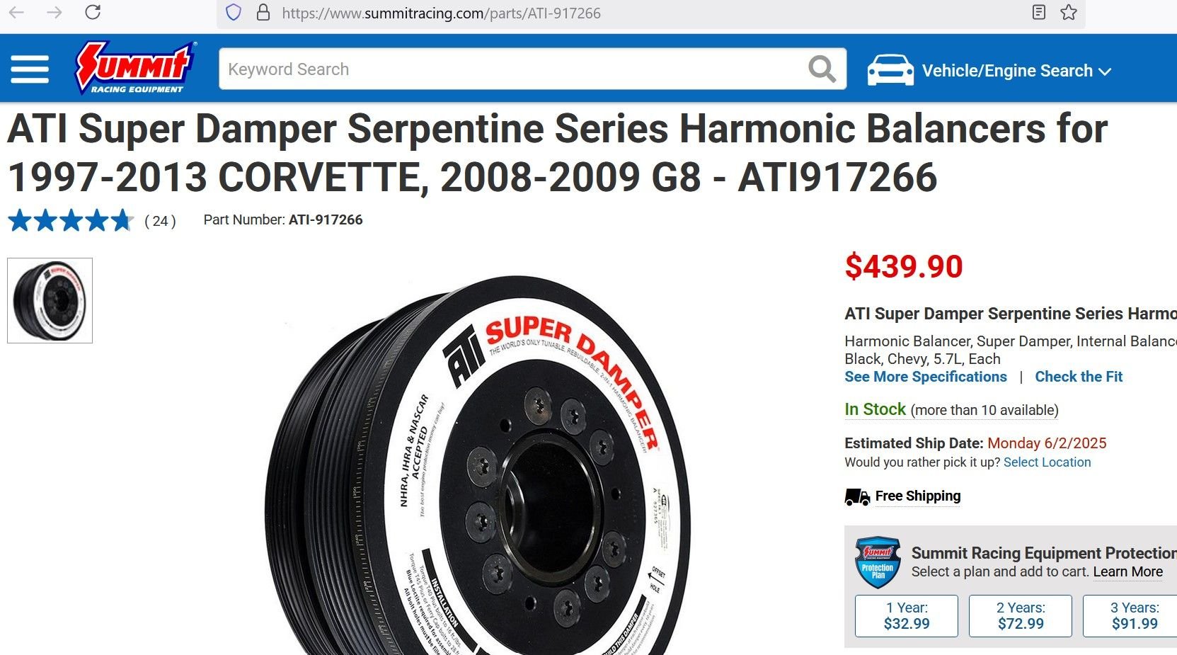

Spending the extra $200 for this balancer is money well spent. It is USA made and top quality.
Also, pinning it while everything is apart is worth it in case you or future owner want to install a blower.

Spending the extra $200 (It is $357 more incl tax than a Powerbond oem-style)
for this balancer is money well spent. (for a non-modified engine??)
It is USA made (Powerbonds are made in Australia....they're our friends...right?)
and top quality. (Yet to hear of Powerbond quality issues).
Keep in mind that their website says it has to be removed and sent in to be rebuilt etc every few years.....verified in their FAQ and by a sales rep of theirs
That is to maintain SFI Certification. I have not heard of one ATI balancer ever failing. Search the forums and tried to find one single post or thread of the ATI failing. What I can find is dozens of factory balancers failing and a few failures of the Summit balancers failing.
I run ATI on a few drag racing engines (low to mid 10s) and they have been on the engine for 10+ years and the balancer looks like new.
If you are putting down over 1,000 HP + then I can see having the balancer checked rebuilt after hears of drag racing.
When GM wants to avoid HB failure in engines, including the LS series, they always use ATI exclusively. GM uses ATI balancers in their OEM applications with supercharges.
