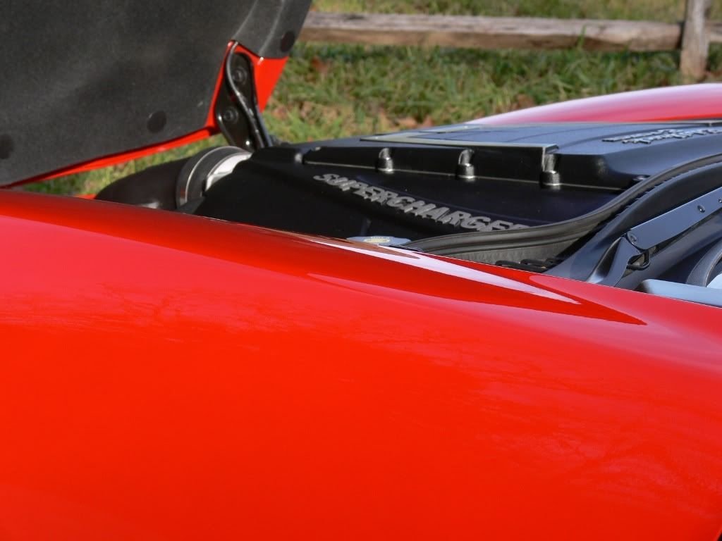

Originally Posted by DarkC-6
Never heard of that, but I don't see a need for a tool. You can completely remove the front 2 cradle bolts and loosen the rear 2, then the cradle can drop low enough to replace the balancer without removing the rack. Keeping the rear 2 bolts in slightly helps to make raising it back into place an easier job as far as aligning it as well. This is the method I used and it worked well.
That’s exactly what East Coast Supercharging did when installing my E-Force years back.... HB was pinned and after 8 years haven’t had any issues. I do check it frequently but (knock on wood) so far all is still good.
