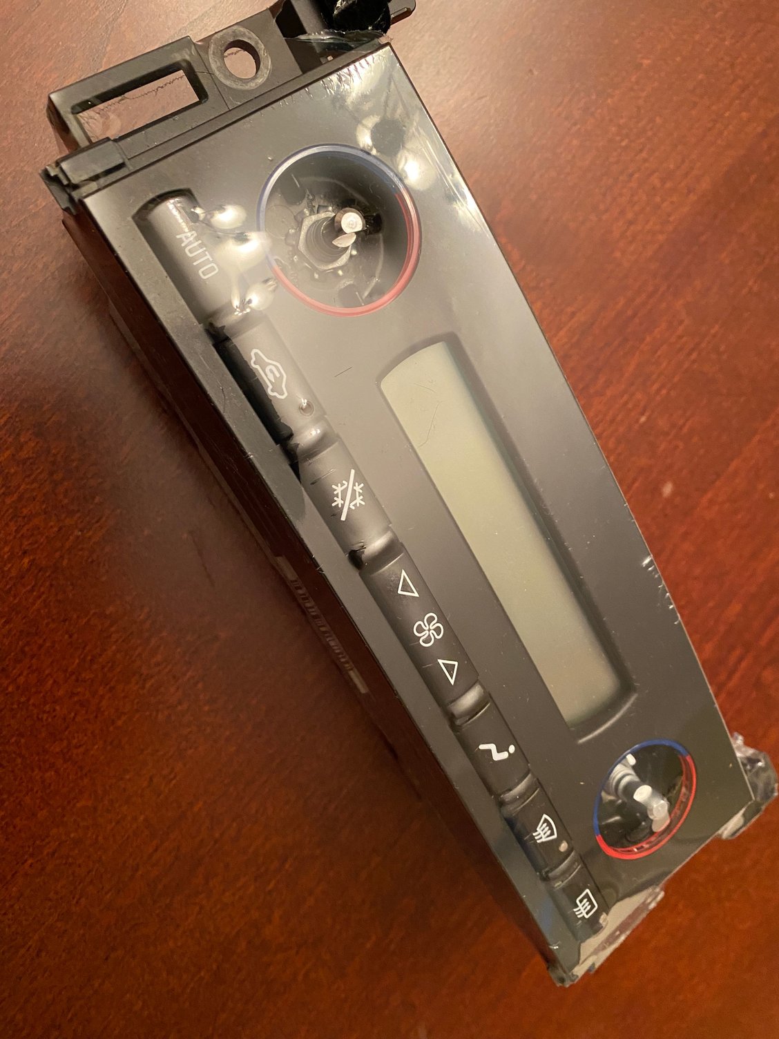

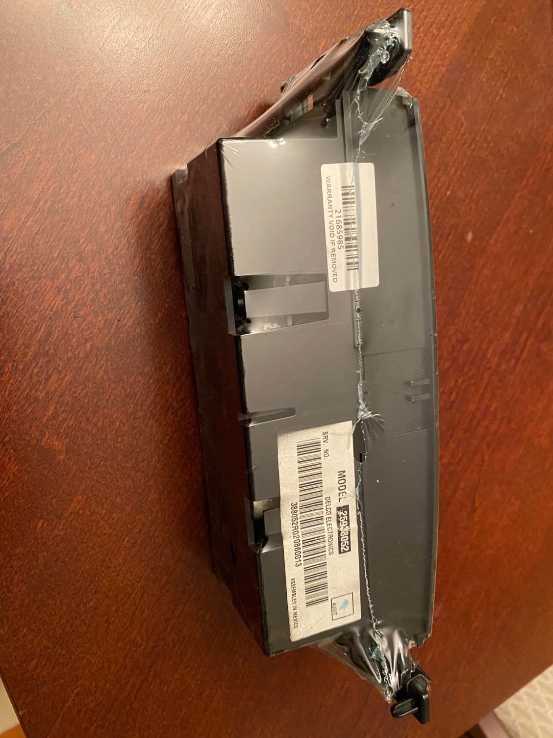

From: Morris County New Jersey
OP, here is the one I have. Still wrapped in plastic but you would need to transfer your *****. I’ll probably list it soon in FS section if you are not interested. It was refurbished and soldering was all redone by a company called Autoecu Automotive Scientific Inc. Original price on receipt was $489 but I purchased it from a forum member for I think $300. I would be willing to let it go for what I paid.
