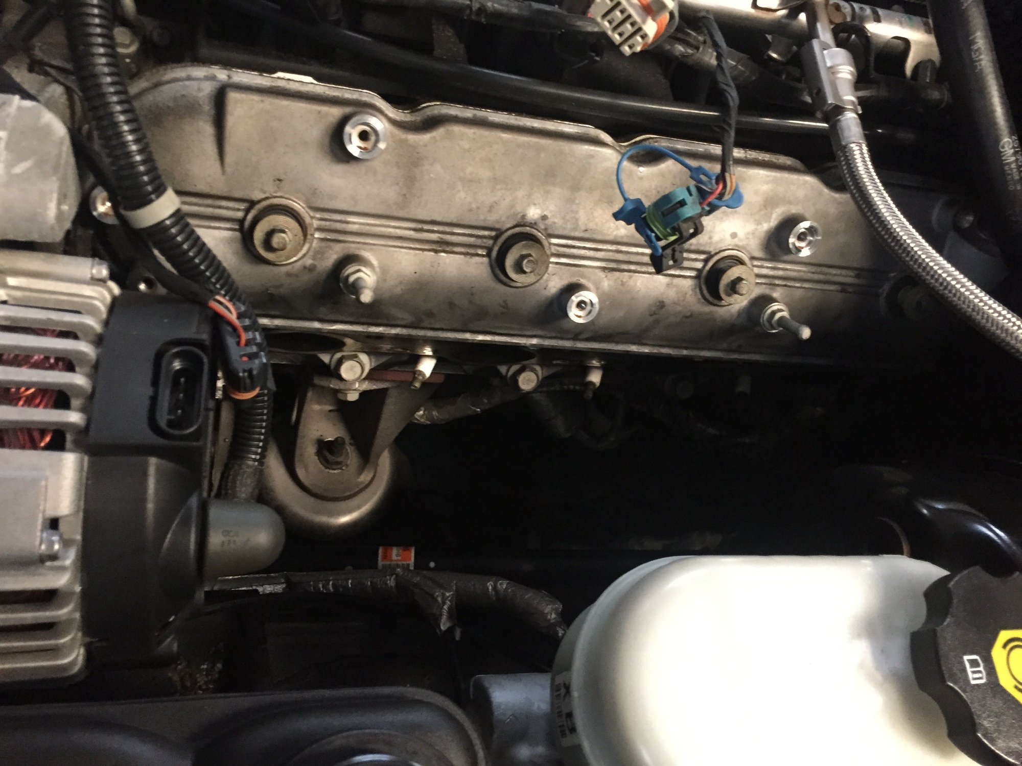

Now to remove some stuff ...
Time to drain stuff into specially made FSP bucket made for drainin stuff into
P/S fluid, gone. P/S rack outta the way ..

Way more stuff to remove ...
Say goodbye to the factory exhaust manifolds, cats and H-pipe..
... gone!

... Leaving a nice little opening to slide in the American Racing Longtubes and the catless x-pipe to expel spent gases through my factory NPP dual mode mufflers. The Mustangs won't know what hit them when the flaps open at 3500 RPM
