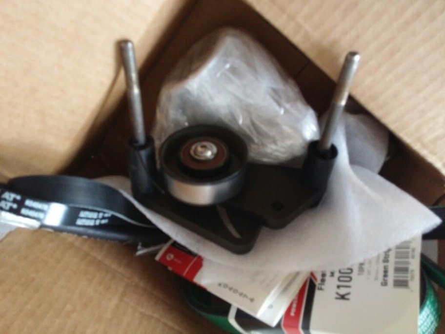

The worlds first ECS/A&A/DP setup is almost done. Just need to finish the PS res mount.
Belt seems short. May need to step down a size. They sent a 370 which seemed way too long, had a 365 laying around. Put that on, but tensioner didn't move all that much, so went to spare belt drawer (yes I have one) and found a 360. Will put it on later if needed.

And all I did was replace this
with this
DP stuff bolts right on, no mods or cutting. A&A need to extend hoses, cut brackets, and move the PS res. Seems like a nice setup, but definitely more involved install.

Got the PS res mounted. What a pain in the ***. Had to get a new radiator hose to clear it. Cut and modify the PS lines. I hope the A&A setup works great because fitment compared to the DP setup is junk. That bolted right on zero issues. This you have to cut up your PS bracket, lines, and radiator hose, and still doesn't fit great compared to the other unit.
