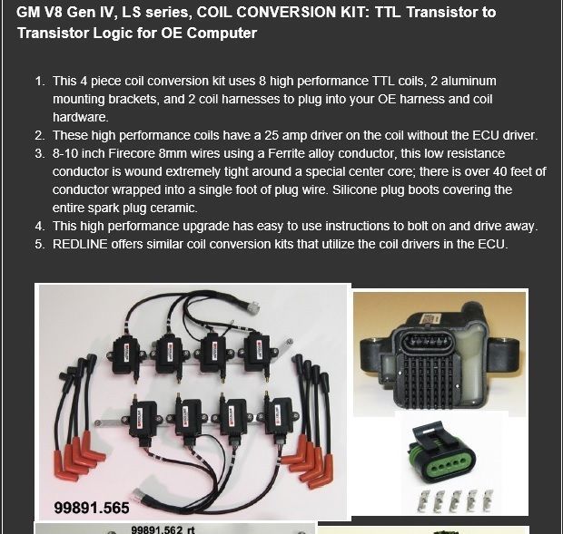

Originally Posted by Unreal
Kit I got comes with all new plugs/wiring/etc.
I'll hit you up for dwell stuff once I get them on.

Yep, thats pretty much what I got. Only difference is he sent me just new ends for the wires instead of new wires.

I just bought the coils from AEM ( UK supplier had stock at a decent price ), figured it was as handy to buy the Holley coil harness for them instead of mucking about with my own.
I used some cheapo Airtex leads for a Ford Explorer or something that had the same plug boots as the Firecore above and cut/crimped to suit the length I needed.
I had tried to get Firecore leads ( my old leads were Firecore but too short for where I needed to move teh new coils to ), but never got any emails back from them at the time and didnt have time to mess about. I may change further down the line but the current setup is working fine.
the Firecores seem to be very low resistance, whereas the Airtex ones I used seem to be around 6kohm I think it was after I cut them to the length I needed.
How much that matters or makes a difference I've no idea.
