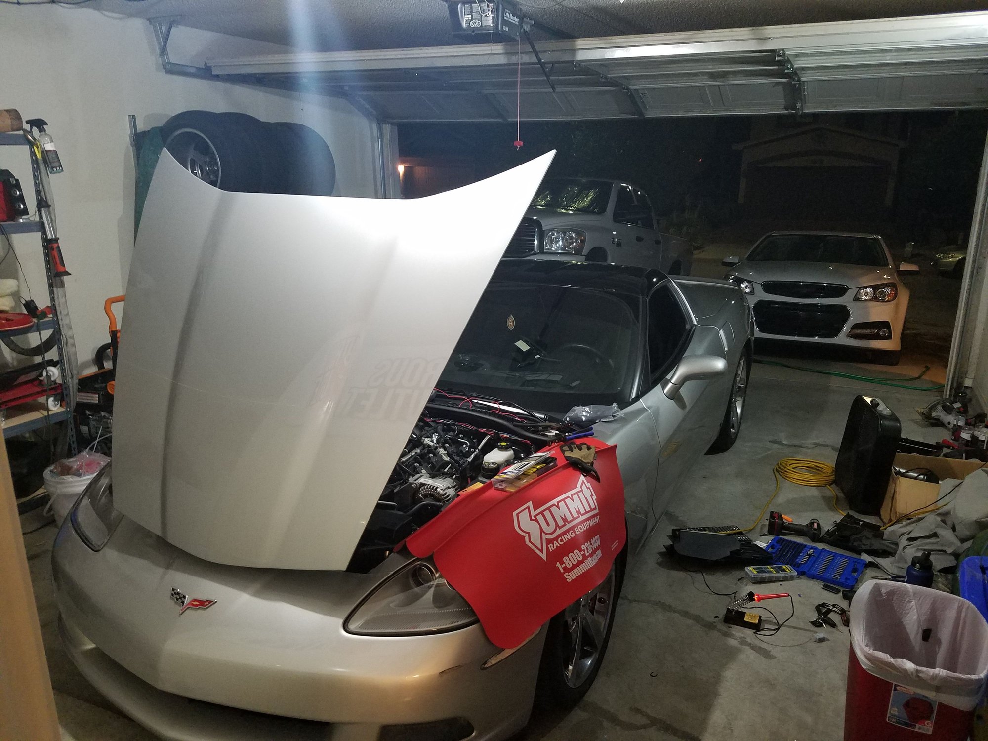

Got a nitrous kit! (Install pics)

wow nice install, I'm still debating if I should do an install myself. Do you have a parts list of all the items used?

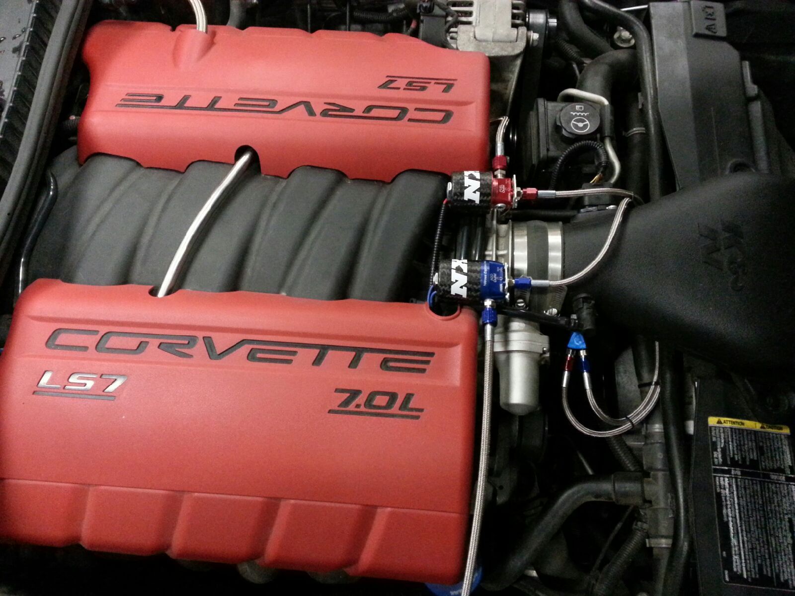

I'd say do it yourself if you can. I would of had it done in a day or two if I still had a garage.

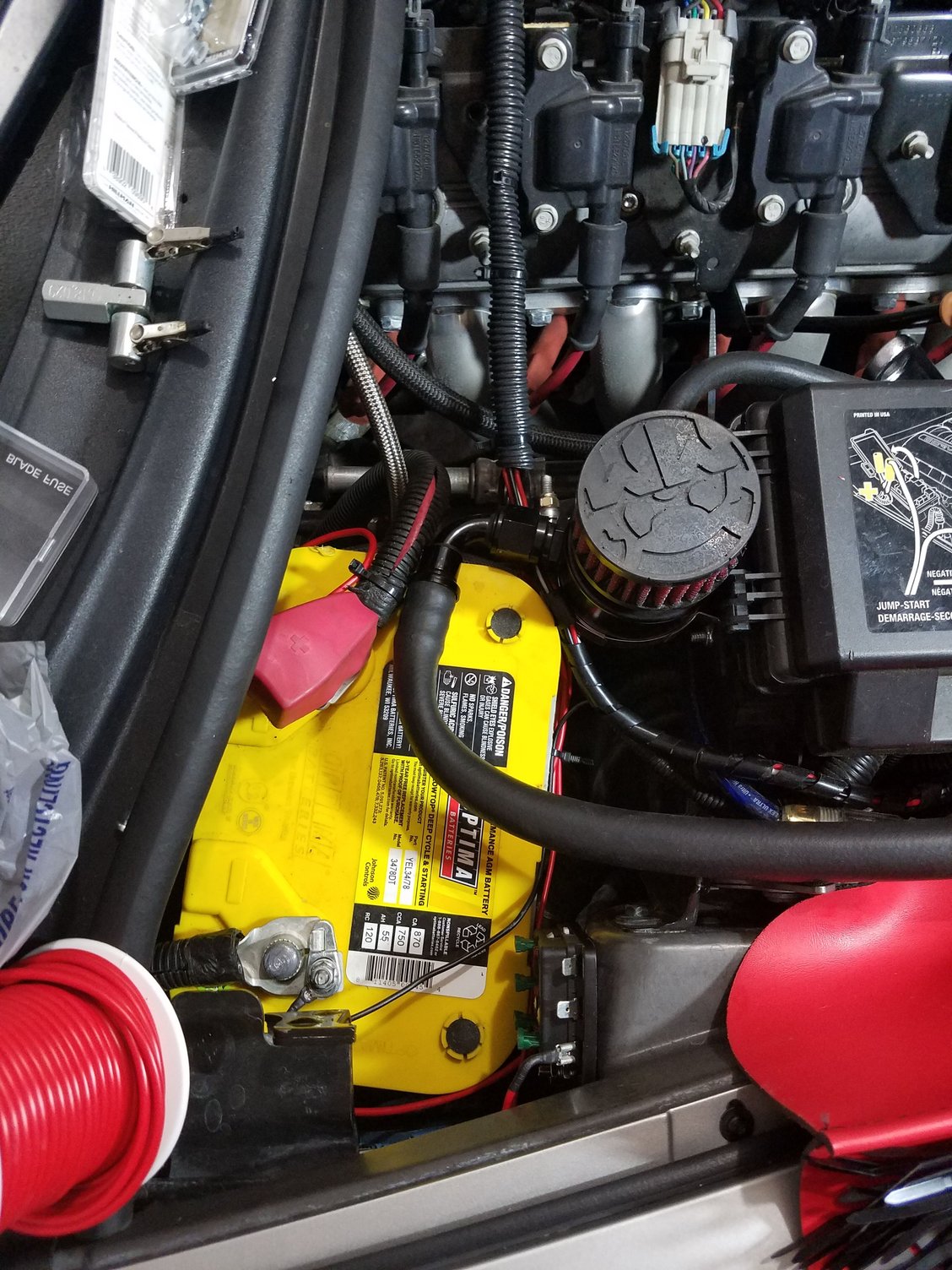

parts used
nitrous outlet ls3 plate kit for the corvette (new)
nitrous out let c6 dedicated fuel cell (used)
nitrous outlet fuel pressure safety switch (new)
nitrous outlet heater (used)
nitrous outlet x series purge (new)
nitrous outlet -6 in line nitrous filter (new) installed today
nitrous outlet heater pressure switch ( left over my ctsv ls6 kit)
lnc2000 (left from my old ctsv)
nos mini (new)
ngk b8efs ordered from nitrous outlet

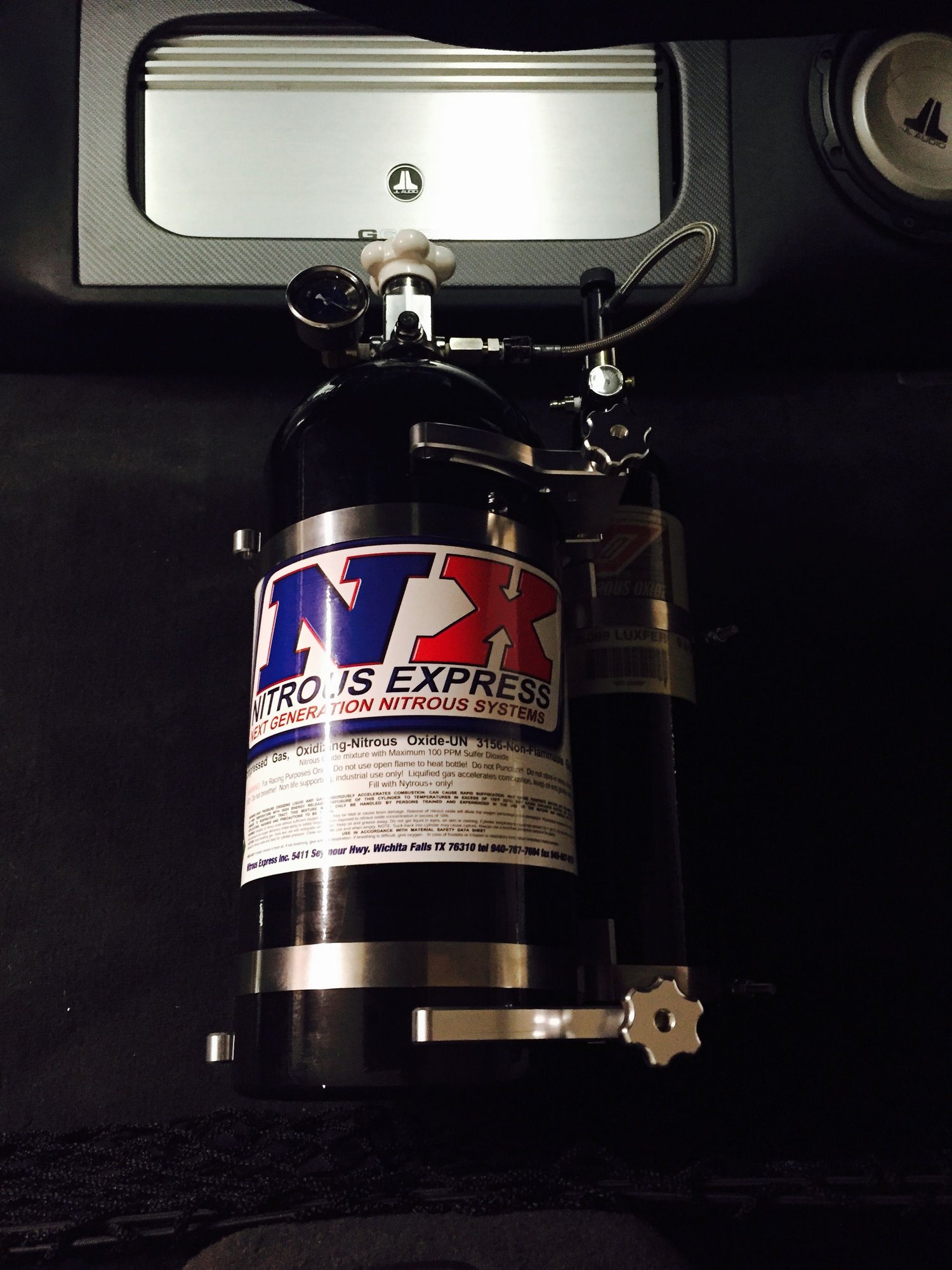

spare bottles one bought used one bought from nitrous outlet new but scratched so I saved some money. All bottles have a nitrous outlet pressure gauge on them.
autometer dual pillar gauge mount (fitting was horrible for the corvette)
autometer phantom 2 nitrous and fuel pressure full sweep electronic gauges
Jegs -6 black nylon fuel lines with jegs -6 fuel hose ends
the smallest piece of particle board from lowes $4
14-16g wiring bought from part store with all the wire loom.
spare 40 amp relay from parts store and had 2 come with the nitrous and purge.
I soldered all connections even the female connectors to the relays.
If you do it yourself and have questions feel free to pm me and I'll give you my number.
here's pictures of the in line filter I put on today.
A huge thanks goes to my wife for giving me "car time" during our Christmas vacation. Also to the guys at nitrous outlet for all the help.

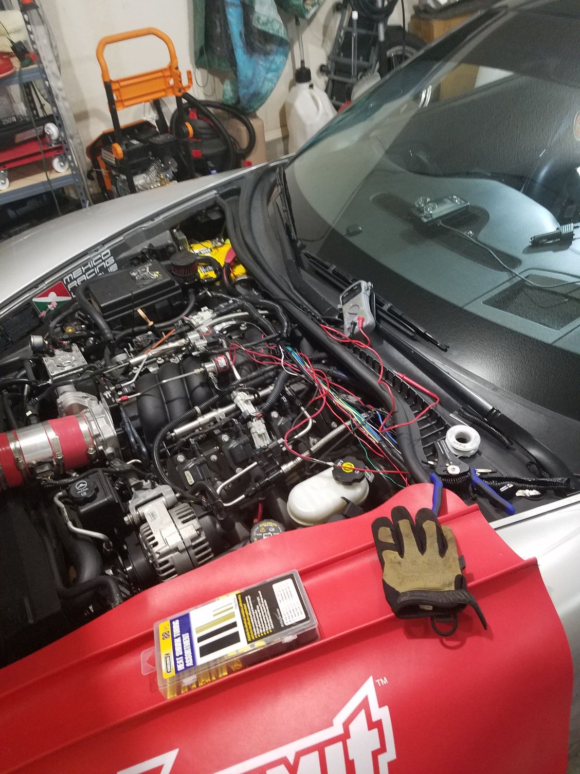

So I moved out to el paso (now i have a garage again). I've been crazy busy with work. But there's been some changes to the setup.

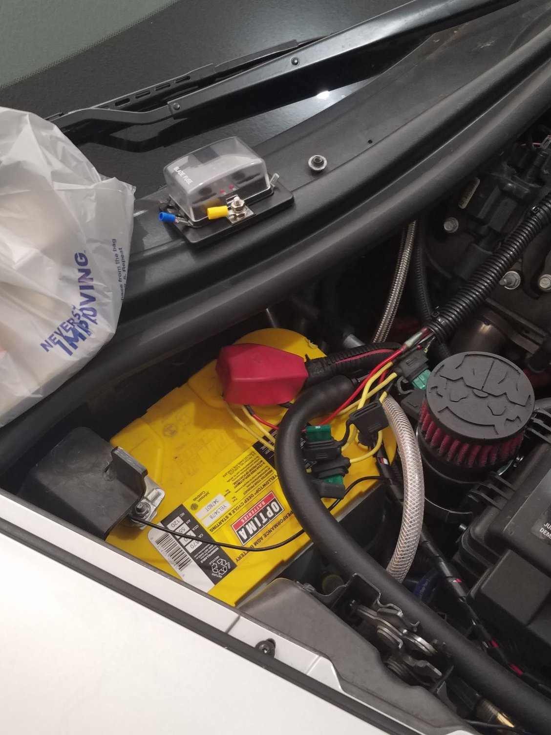

rewired everything with 12g power and grounds. Added a fuse block giving everything its own power ground and fuses. Added a flex fuel sensor to the car.
The lnc2000 is now activated by the now mini 12v output. That way I can have the kit delayed and launch na with all my timing then the timing is pulled once the systems starts to spray with it being progressed in.
Had a purge solenoid go messed up so the purge was rebuilt now its back on.

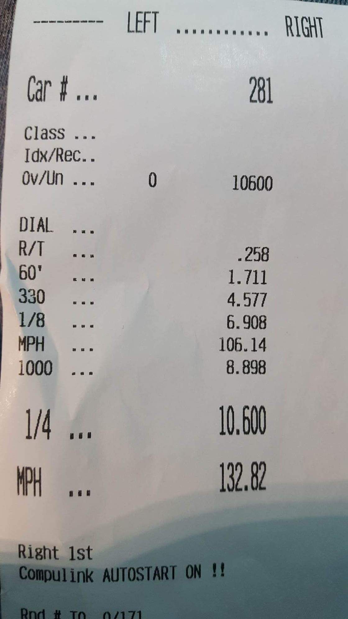

l only got to make 2 passes in it with the nitrous last time i was at the track. I ran 10.6@132 with the nitrous coming on super soft the second pass I had it hit a lot harder and turned up the timing but the track system messed up so i have no clue what it ran from the looks of my logs on that pass it was around a 10.4@135ish.
All motor I ran a 10.9@127 first pass.

aw that sucks. you were a 1.4x 60ft from getting that thing in the 10.1-10.2 range. was that a 150 shot?
Old Jul 5, 2017 | 03:47 PM
  #34
asd_srt's Avatar
asd_srt
Joined: Apr 2016
Posts: 833
Likes: 119
From: Raeford NC
That was a 100 shot with 4 degrees of timing pulled and it started out at 30% and ramped up from there. It spun a little my 60ft was slower than my NA passes.
Now that Ive found a voltage issue with the TPS signal to the nitrous and back to the car I'm 99% sure thats why my 60ft was worse with the spray.

Just a little update. When wiring to the TPS use the green wire not the purple. Now that i have a Torque coverter that can handle whatever I throw at it I've noticed some strange voltage issues when spraying with the TPS signal. I redid the TPS to the green wire and now I've had solid hits every time and no more issues with the nitrous. Its now on a solid 150 shot with e85 in the car and VP110 in the stand alone.
