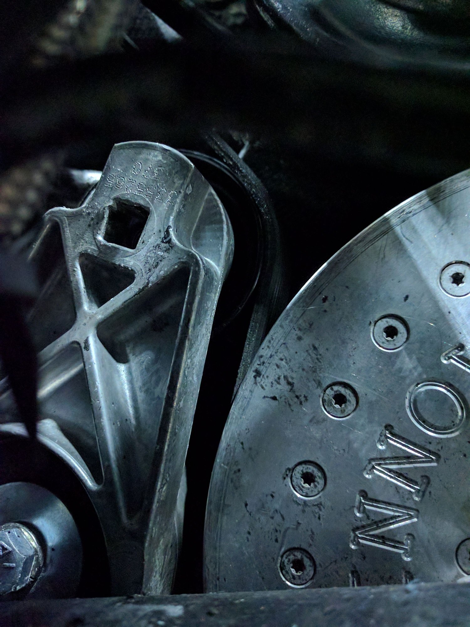

here is the bets pics i could come up with tonight..

Yah, need a shorter belt on there.
i thought it was supposed to be 1Oclock

problem is unreal i dont know what belt to buy and try..
I emailed chris as ECS, maybe doug will see this first
I need to know what belt is needed for 3.47 and 3.67, with a 8in ( 10%) crank

Just go to the parts counter with the belt and ask for one size shorter belt, get one shorter then that too and return the one you don't need.

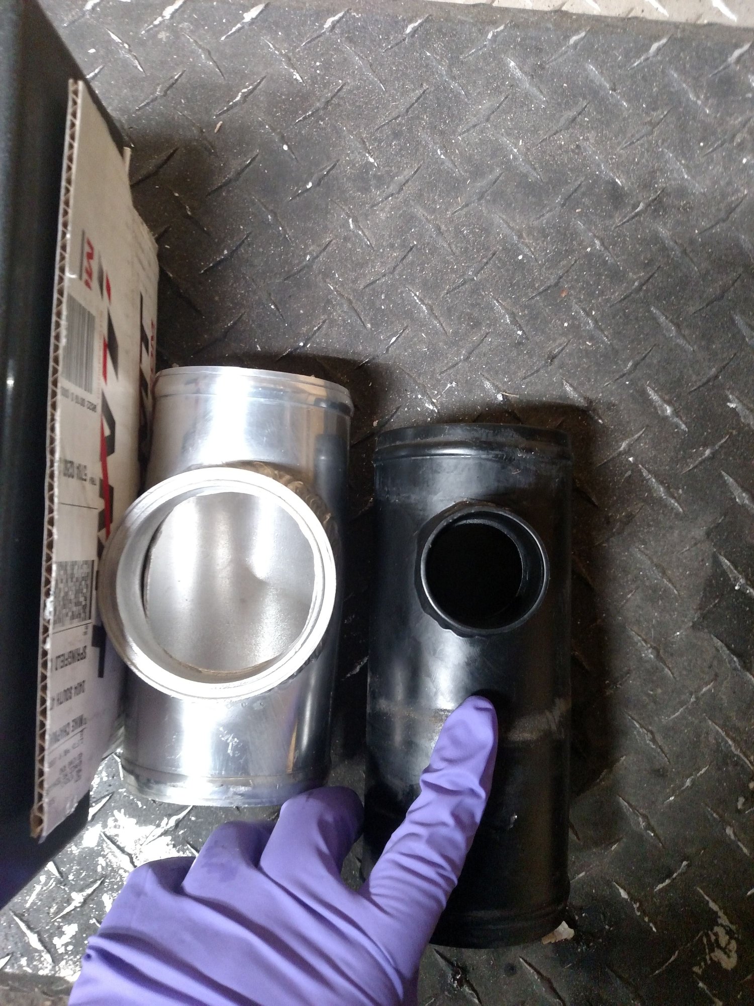

I had a major problem throwing belts and had to buy several as they were getting chewed up. After rechecking the alignment several times, belt tension etc, etc., I contacted the guys at A&A who told me that I didn't have enough bov. I immediately threw on a 50mm Tial bov and that took care of my belt issues.
Different blower setups, but I went from the little Procharger bypass valve to the JGS 60MM dual port valve.

Look at the belt chart and pick one size smaller. Gates has it on their website. Find what you have now, and order one smaller.
That or your top tensioner needs a lot more added. THat looks like what it should be with no added tension, then up top when you use the manual tensioner it should pull it open almost all the way.
the top one at the bracket was maxed as well.. i ordered 4 belts from amazon. a 903/897/893/878, start with the smallest and work up.
I have a Tial Q 50mm with a green spring in it.

All you needed one one size smaller. If you looked at the belt size chart you could have just ordered one belt.

What size is on there now?
The spring loaded tensioner should basically be all the way open when you tighten the manual tensioner. I can check it out next week if the car is at your place

i think we can agree this looks better now?
